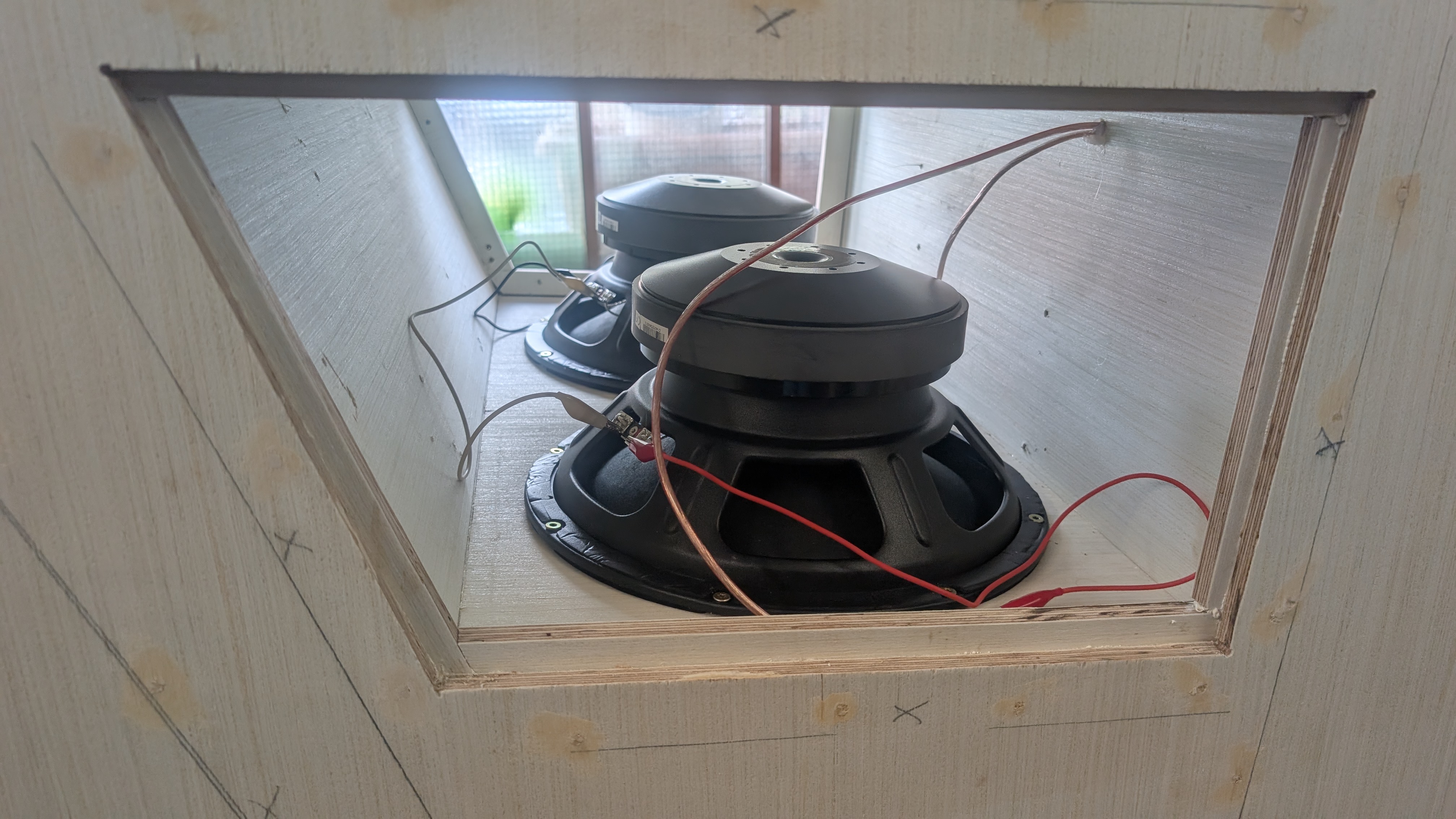

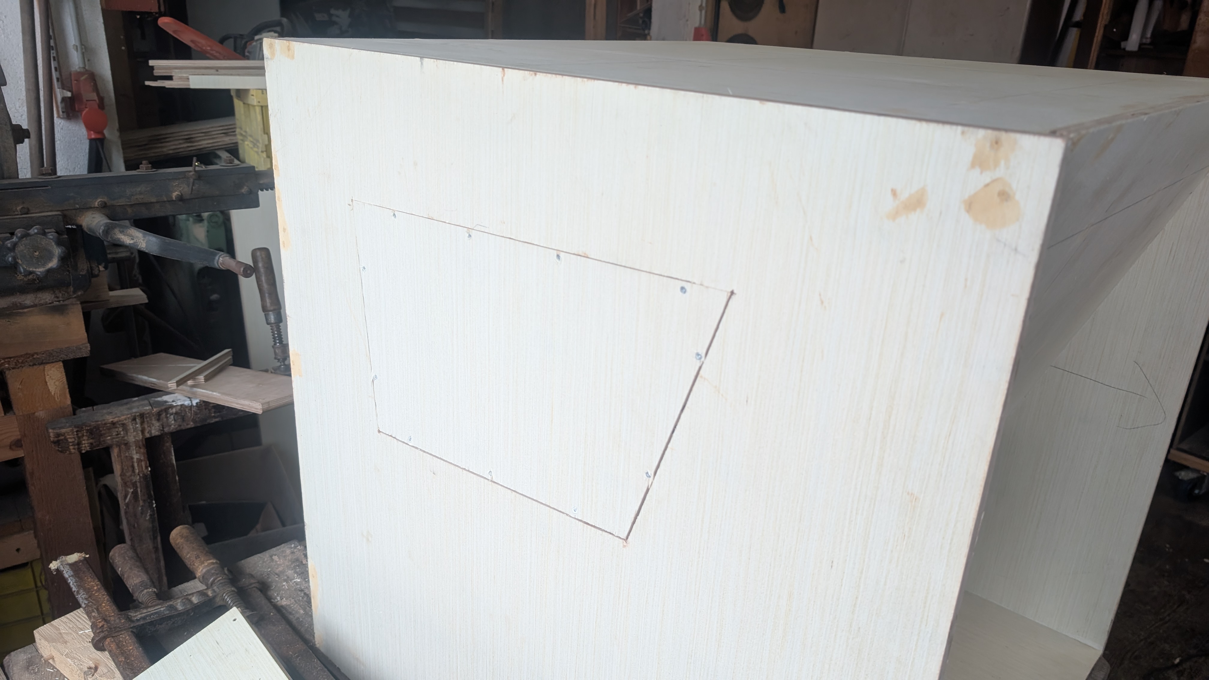

Sadly timing is not on my side, but the exploded workload should slowly ease from now on.
I got the cab finished yesterday, had to think about the connection at first, i think i'll go with that for all of the cabs. Space sufficient, less cables inside, only one point with importance of airtight...and every connector is flush :)
All sealed
Before the mouthbrace
And done, glue is setting right now.
As the winter returned again, this will take more time as i would like it to; but nothing i can change.
Will do the flanges as soon as i can, and then place some woofers in there to check if the sealing has worked. But i am pretty sure it should be airtight everywhere.

Flanges done, will def do them in one piece the next cabs. For aligning during build, to avoid the build inside chamber now...would be a win even with more wasted wood.
Corrected oopsie, glued replacement and trimmed flush

Had the panel underneath when cutting some bracings with the circular saw...thought the cutline was clear, turned out it was not and the corner got lost^^
But as it was about fixing shorted panels elsewhere, i thought showing the recovery maybe helps someone.
Really not a problem to fix.

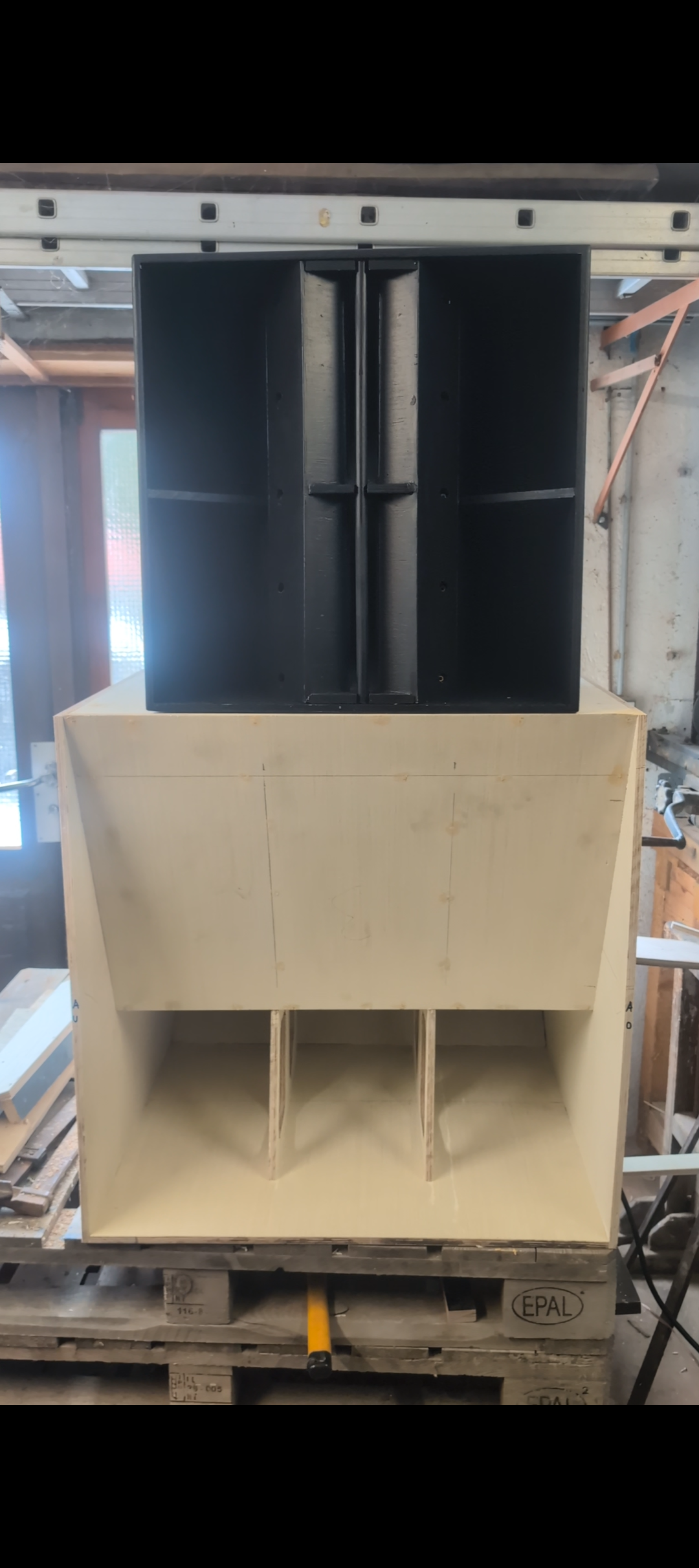

I thought about the wheelboard thing again.
I came up with the following thought: As i want to do 8 of the T30 and 4 of the DRs, i could stack tweo T30 and one DR to one carry-on-package, and i would end up with 4 equal bundles i can strap together.
The height of that adds up to around 210cm without the wheelboard, which will be problematic to get out of the door sadly. But this will be the storage-solution, to move them I'd have to take the tops of until the package is out of the door.
Now i just need to think about how to fix that stack to the wheelboard. I thought about having routed in handles in the T30 as well as in the board, board slightly overlapping, and then strapping it around everything. Between the cabs i'd place some of the protection mats, as i want to have them anyway when stacking them to play.
I just do not trust the recommended hatching with butterflys enough, the cab feels sort of too big for the little hatches (and i do not want the hatches on the cab when stacked).
anything i forgot? any problem with strapping?
I would give the wheelboard a frame on three sides, to have the position fixed to the lower cab so there is no movement when rolling around.
As i have to do a stacking solution for the DRs on top of the V-Plate later, i thought re-using the wheelboard for that. The mentioned frame could have additional bars, that would carry the lower DR, and the wheels could get grooves on top of the V-plate (similar to what someone here showed lately, just bigger wheels and covering the angled lower DR directly. viewtopic.php?p=299480#p299480 )

So, you're going to do a separate "movers dolly" type of transport solution, if I'm understanding correctly. I like that idea. Sounds like a clean solution, especially considering the cost of putting four casters on each cab!
I wonder if it could be effective to use rubber feet as locators. So when the cabs are stacked on the dolly, they're horizontally secured and not trying to slide off each other... additional stability over just straps alone.

Yes, basically halving the amount of wheels (and solving the dr250 carry problem and the dr250 stacking problem on the same page)
Rubber feet could be an option yeah, will think about this when playing around with the first. Will have to try around esp for the stacking later what works best; will post the results.
I'd reverse this, to have the sunken in counterpart on the cab to have the cab with a flush surface later, and the feet on the board.
