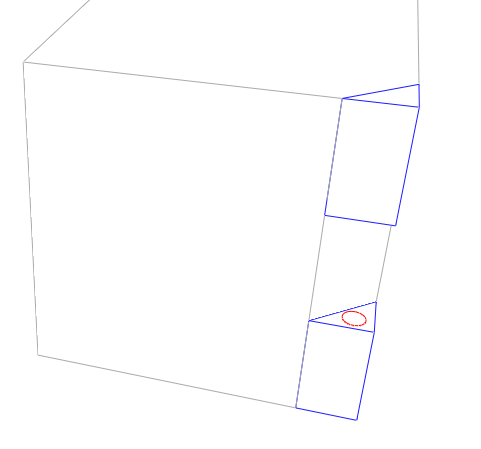

Some further thoughts on that, that hopefully will be critisized:
I’d go for the cut corners, to have the panels shorter and for the handling when stacking them. On the other hand, the cutout-handles would be nice in both back corners. Not sure yet. Cutting the Corners and placing a sunken in handle there would be an option maybe?
Still not sure how/where to place the input socket then. Maybe a sunken in Variant, that fullfills the bracing in the same time? Would it be faulty to take some volume out oft he horn path between the back panel and the chamber? I do not want them visible, so it has to go in the back.
Or not cutting the corners, doing the cutout-handles on the sides and cut out a part in the middle to have the connector going in from the side oft he cutout?

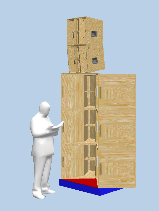

I tend to go for wheels, either 4 on every cab or just every second cab and clamping always two together for transport. But not in the corners, in the „back“-surface looking from the mouth to have them stacked in two rollable like a rack (30 by 30 by 60 inches then). As they will never be used single, the pairs should work and need half the wheels.

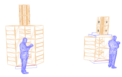

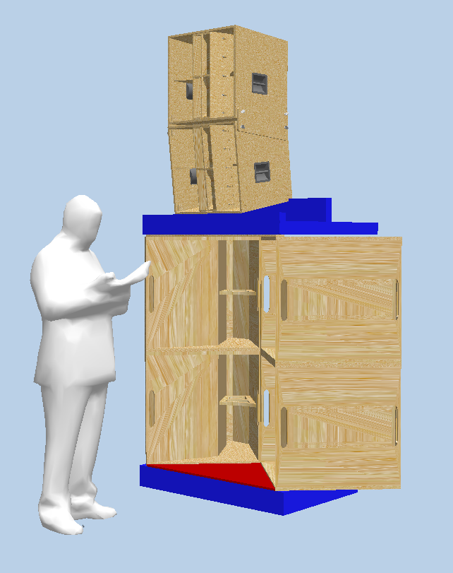

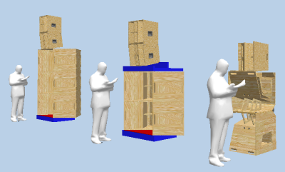

Plan to have stacks of at least 4, including the V-Plate. My mind wants to use the V-Plate as a stand for the DRs, so i thought of having structural parts on top of the plate to stiffen that, that would have the grooves already to take the lower DR in the correct angle. Stacking two DRs on Top of each T30-Stack. Would also give me a reproduceable distance between tops and subs for a fixed delay setting between them. Depending on the venue size, i would then take stacks of 6 to get higher, or have the height difference upwards by having it in the structural parts higher. Would be about 15 cm or around 6 inches to compensate when a stack of 4 sits on pallets, to get the bottom DR on a height above 180 cm (around 71 inches or whatever this means in feet)
(Other optional usecase would be to stack just two T30 vertical and one DR on top; there would be another clamping solution for that DR then. In case something smaller is going to happen with lower needs)
The Plating is always only done with a top-plate; the bottom end is just the floor as far as i found examples of that. I tend to place a stack on pallets to get off the dirt below, and thought maybe a bottom plate there would be better? Anyone experiences on that?
Assuming a top and bottom plate beeing there, i thought about extending a 2 by 4 or something similar all the way til the back, til the cut corners to connect top and bottom in the back oft he stack. In the Front, I’d connect the top and bottom plate on the outer corners, so the plate and the stack is fixed together in one rush. I also thought about combining bottom plate and pallet below to one fixed instance, to have it altogether always the same.

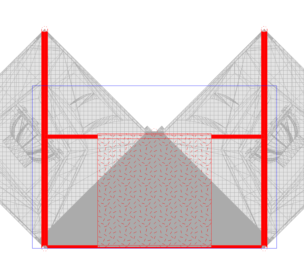

Here a little sketch to that thoughts:
red bars horizontal would be the ground support for the DR. DR is the red scattered area to scale.
Red bars vertical would be the connection front/back, clamped/strapped together top to bottom in each end. Additional strapping top to bottom in the middle part where the cabs touch (red circles)
The blue frame is the pallet size, i noticed even one could be enough. Would attach the bottom V-Plate fixed without overlap, so the T30 can sit on the pallet meeting the plate flush. Weight should not be an issue, as it sits kind of balanced...maybe strapping the whole thing to the ground somehow; especially when going for a stack of more than four.
Sooo...any thoughts to these points?

To the stacking part, i tried to visualize my thoughts for a better imagination:
This would be everything to scale, including the humanoid, the two (i guess) most probable variants of 4stack/6stack.
6 Stack already quite high, not sure about that. The blue in the bottom represents the pallet, the red the attached V-plate to that pallet.
In this case DRs pretty high, better for ear damage but not sure if the front is covered enough then.
In this case slightly too low, the height variable as i can just increase the height of the structure on top of the V-plate.
Will do a sketch about the handles and connectors next and edit in in here to not spam around.
Here it is, to the connector/handle:
Stopped the thought about inside the hornpath as a bracing; to have the connector handleable somehow comfy, it would need to be huge.
But i would go for the back corner; in the standard orientation the corner between backpanel and toppanel (Or the Corner from back to bottom, shorter cable paths outside)
Cut the corner only in the middle (around 20 cm for comfy handling); and in the "inside" panels that face each other the sunken in connector (red).
The remaining parts (blue) of the corner would get the handling cutouts. I think with this the handling should work well, and the connector should sit without any extension beyond the outer borders of the cab. Any errors on that? Inside there is then just the cable to the chamber; from this corner the way is quite short (also the intended corner for connectors in the model)

Plenty of coverage up front with that elevation. You definitely don't want the speakers at or below head level. Give it a try. Put your DR up on something and give it a listen. Or just put it on the bench and lay on the floor. Yes, directly below the mouth, you'll hear some high frequency attenuation if you listen for it. Testing this indoors will not be as apparent. But, it's attenuation, not elimination. It's actually a good thing for people up that close. Plus, the general population won't be aware of it, they're busy having a good time. Matter of fact, 99.99% of them will never hear the things we do, they don't know what to listen for, even if they were trying to listen for it. And really, every listening position will have a slightly different sonic signature. You can tune the system based on one listening position or the average of many, but the variance across all listening positions still exists and you can hear it. There's no getting around it. Getting the speakers up benefits everyone.Marflinger wrote: ↑Sun Feb 15, 2026 1:53 am ...In this case DRs pretty high, better for ear damage but not sure if the front is covered enough then.
However, as far as coverage goes, those stacks are going to have to be separated by about 20-22 meters, putting them 10-11 meters left and right of center stage. If you're really intent on the front and center coverage, you may consider canting the stacks slightly inward or adding some center fill. SLA Pro's would be a good choice here. Limited visual impact near the stage/booth and additional coverage up front and center.

Funny part, did this an hour ago. Stacked both ontop of each other on the amprack and turtled around close to it below. Even indoors it works somehow way better than i expected.
I will test with the 4stack how high i can lift them up and build the ground support for 4 t30 respectively. By this i will see if the height of 6 t30 will be still good enough.
Intending to cross at around 100 hz, which would equal to a distance of around 18 meters. (56 feet) But yes, well aware of that aspect; bill told me in the beginning.
No frontfill intended, toed in will be the way to go. Stage is in foh position, not in the front (as long as it is my decision)

The distance needed between stacks is based on the lowest frequency, usually just the high pass setting (not the top/sub crossover frequency).Marflinger wrote: ↑Sun Feb 15, 2026 10:58 am Intending to cross at around 100 hz, which would equal to a distance of around 18 meters. (56 feet) But yes, well aware of that aspect; bill told me in the beginning.
The general rule is, at least 2 wavelengths between the stacks.
To calculate this, it's simply the speed of sound per second, divided by frequency, times two
The speed of sound is variable depending on atmospheric conditions, but it's typically close enough to just use standard figures. I always use 1123 or 1125 feet per second because my mind remembers it easily. Either is sufficient for the calculation. It's essentially 343 meters per second, which is also an easy number to remember if you prefer dealing in meters.
