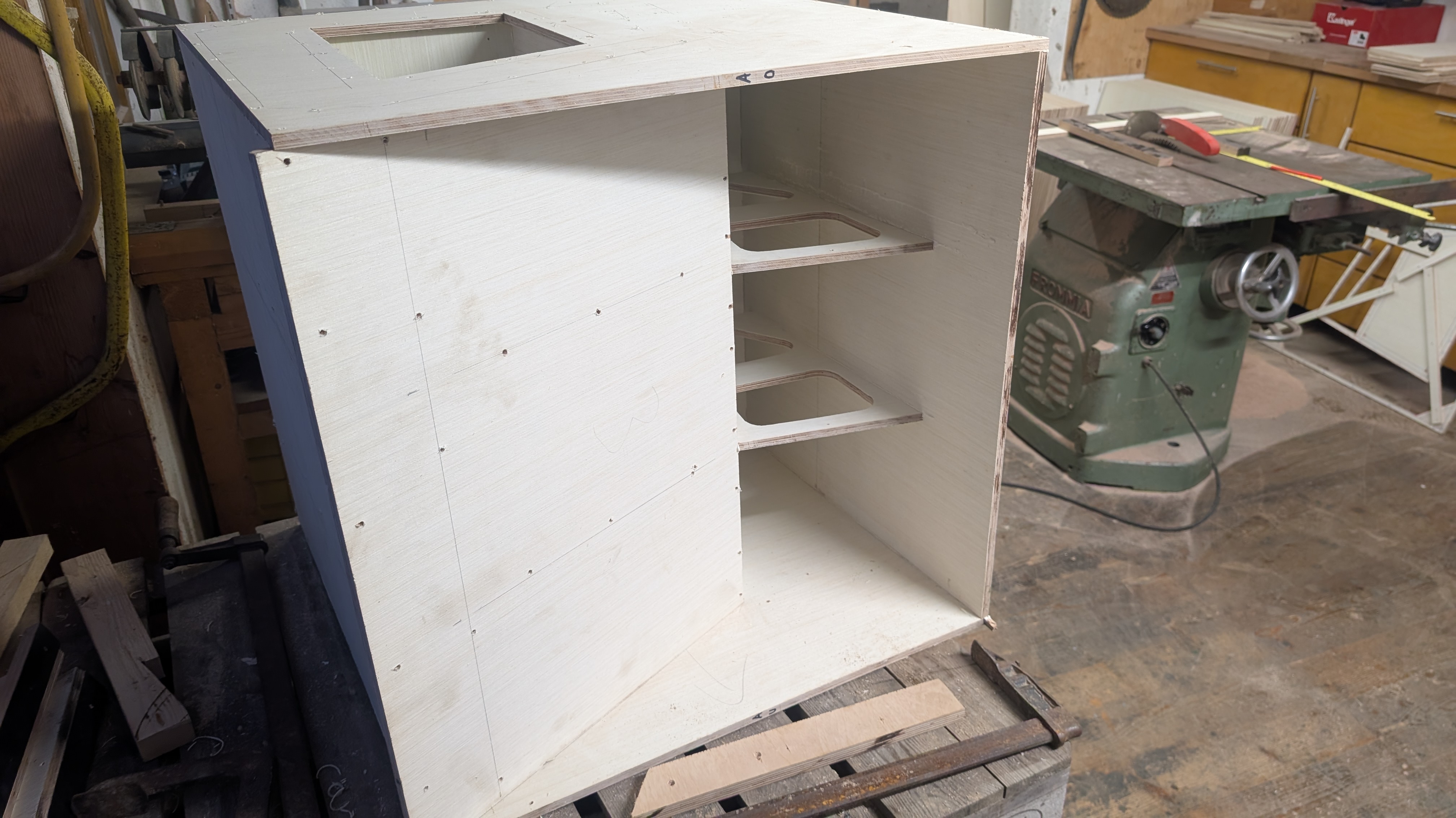

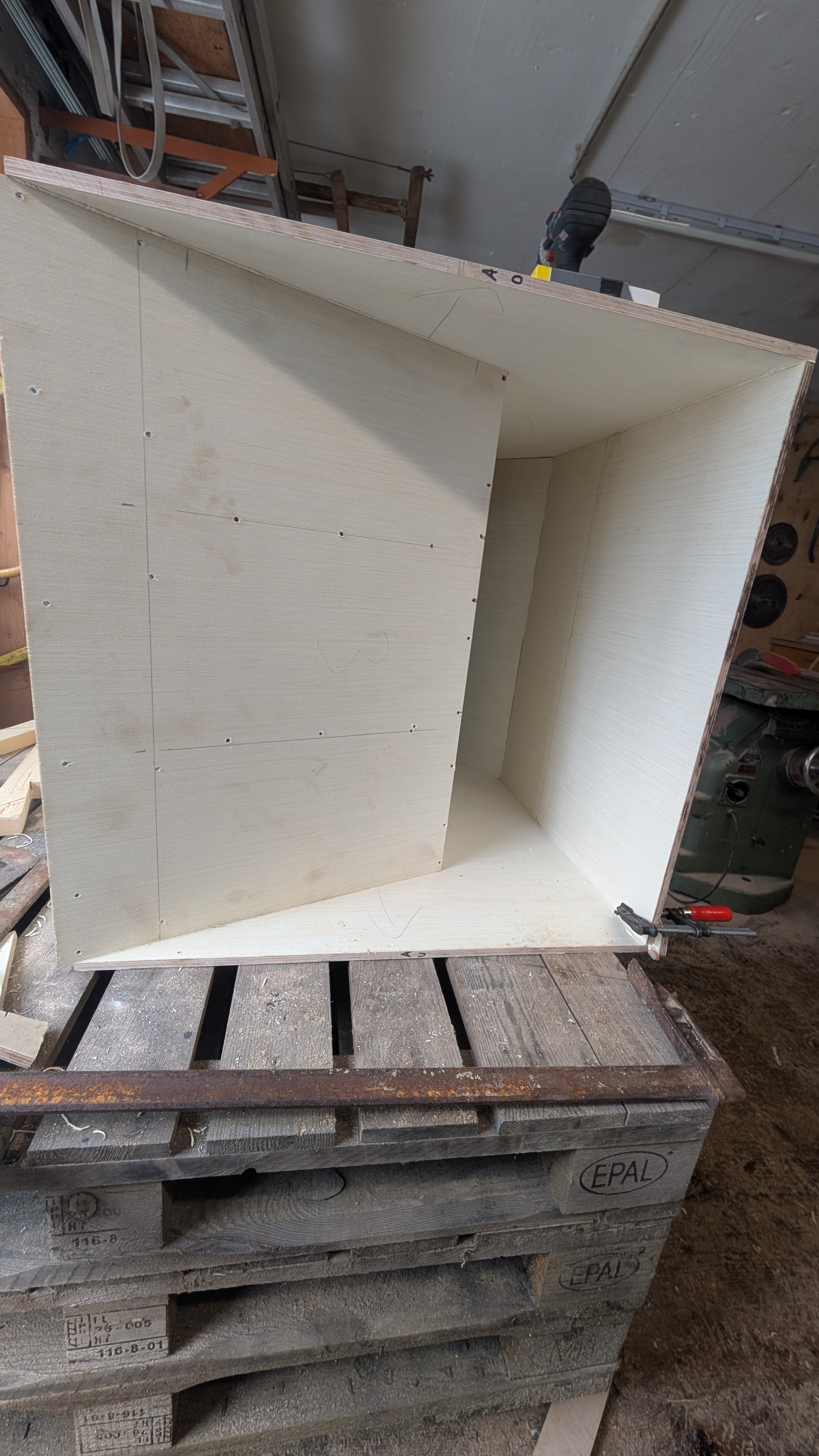

Sadly timing is not on my side, but the exploded workload should slowly ease from now on.

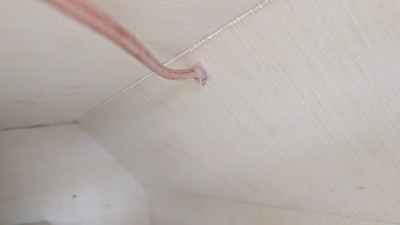

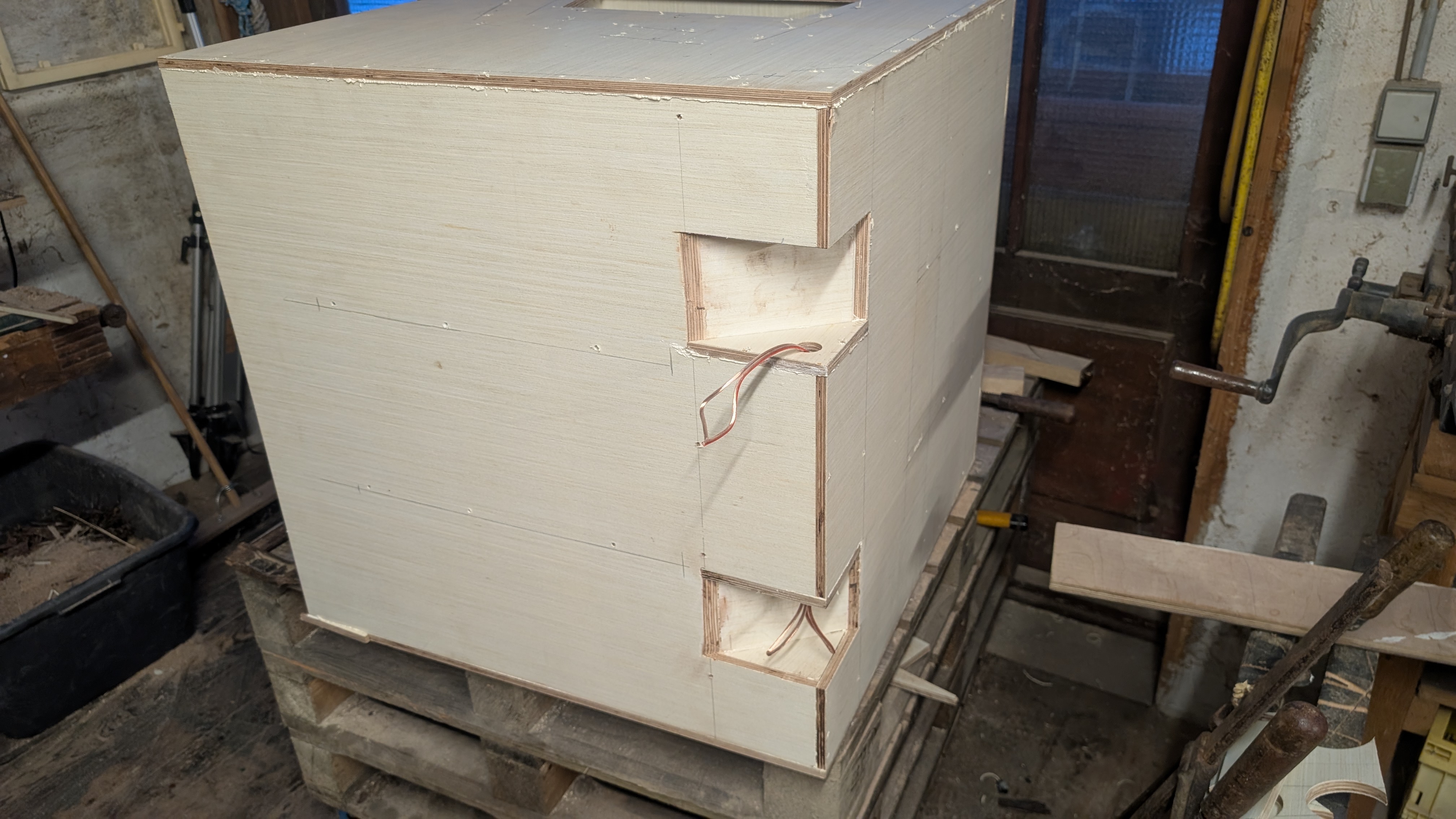

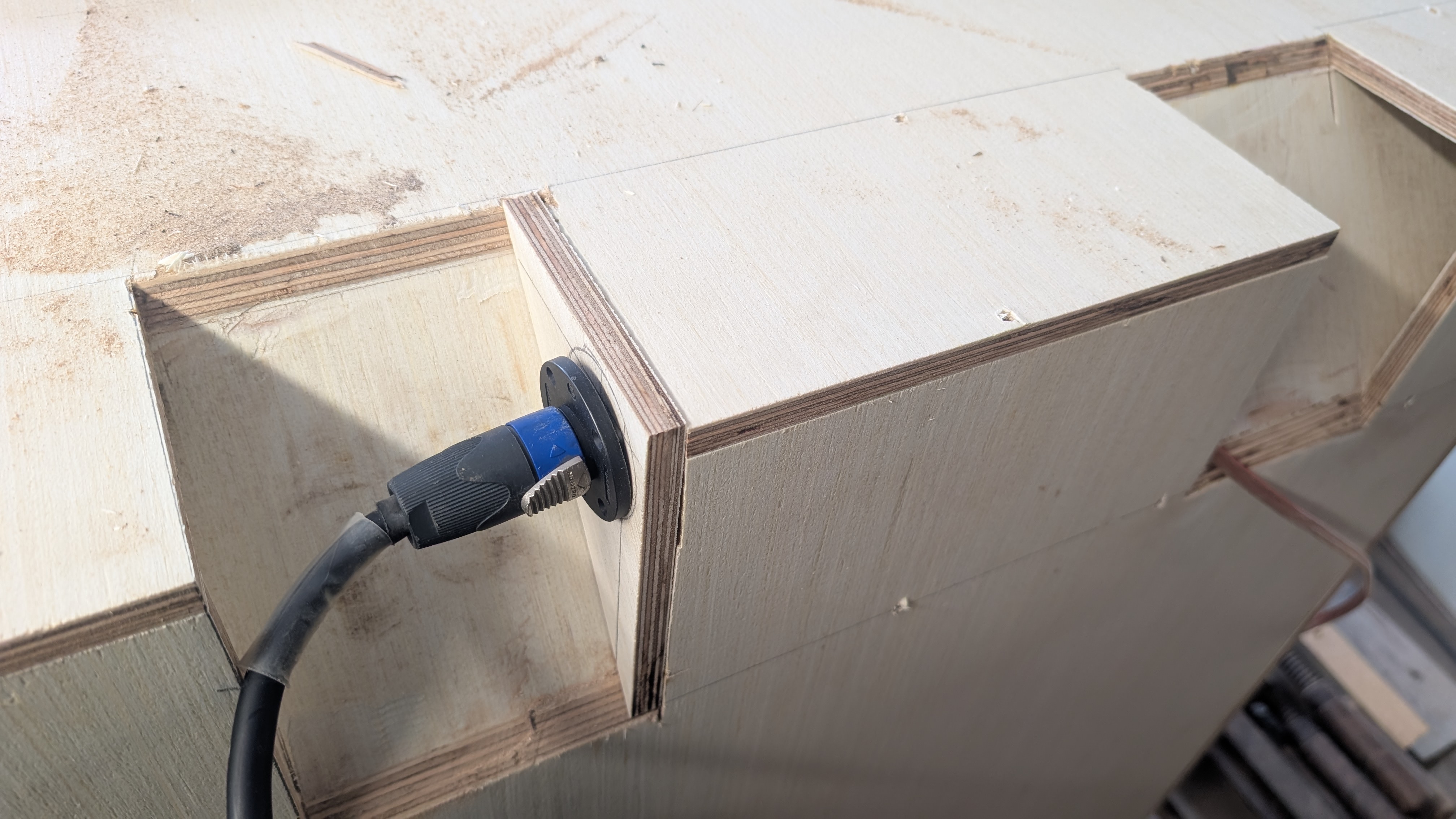

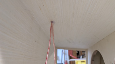

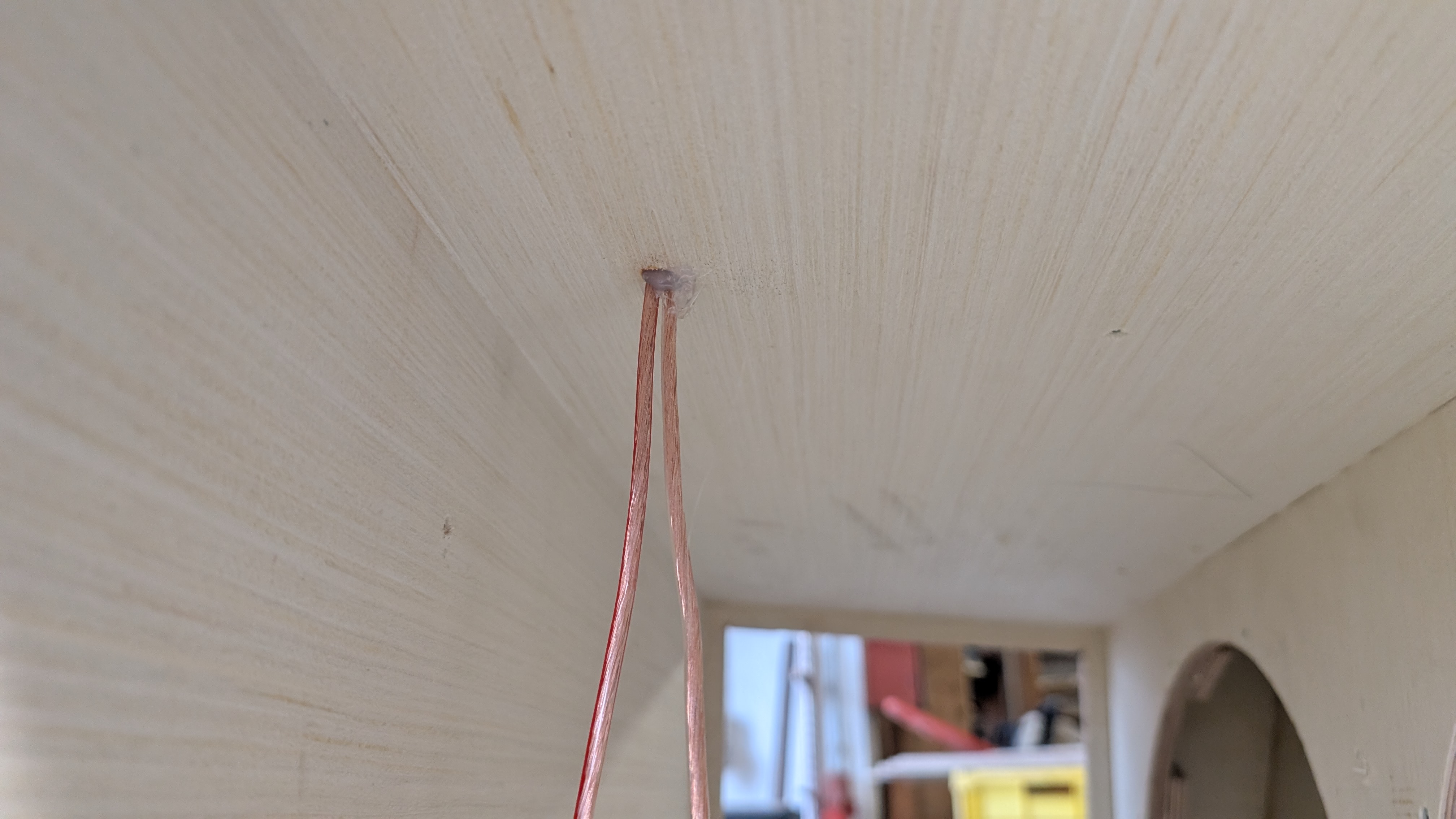

I got the cab finished yesterday, had to think about the connection at first, i think i'll go with that for all of the cabs. Space sufficient, less cables inside, only one point with importance of airtight...and every connector is flush :)
All sealed
Before the mouthbrace
And done, glue is setting right now.
As the winter returned again, this will take more time as i would like it to; but nothing i can change.
Will do the flanges as soon as i can, and then place some woofers in there to check if the sealing has worked. But i am pretty sure it should be airtight everywhere.
All sealed

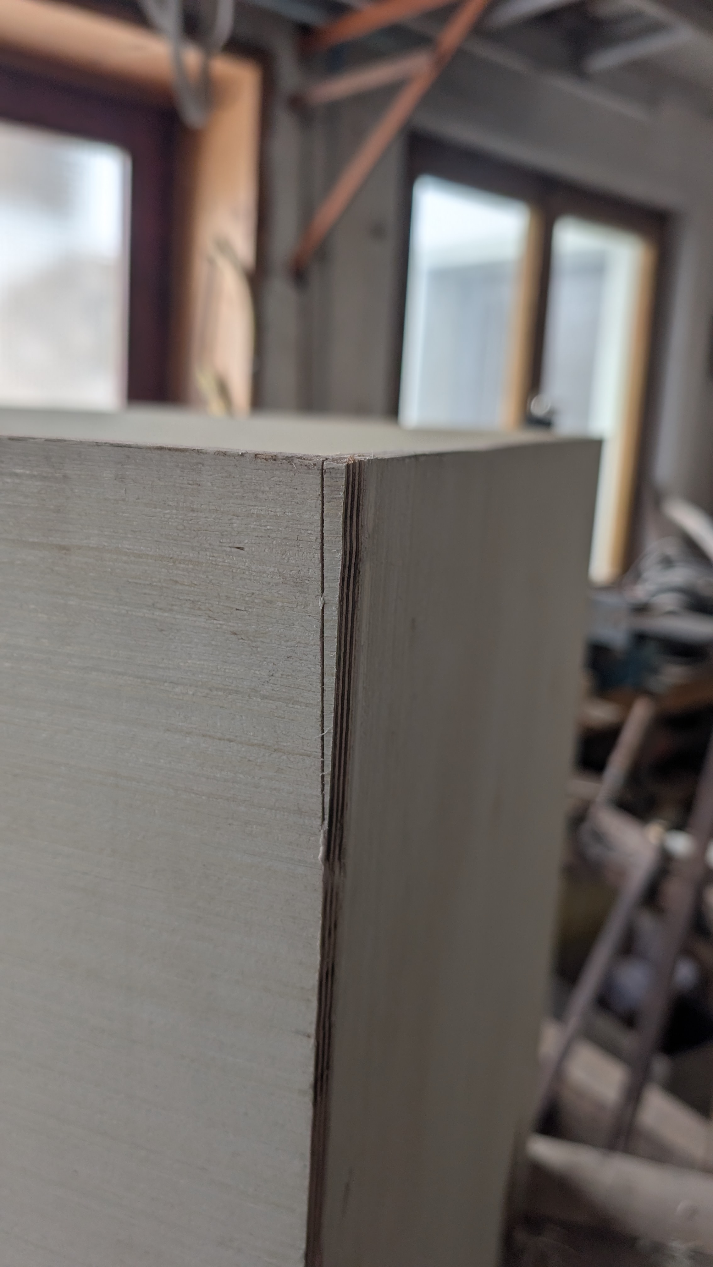

Well yeah, nothing on the time side is on my side...

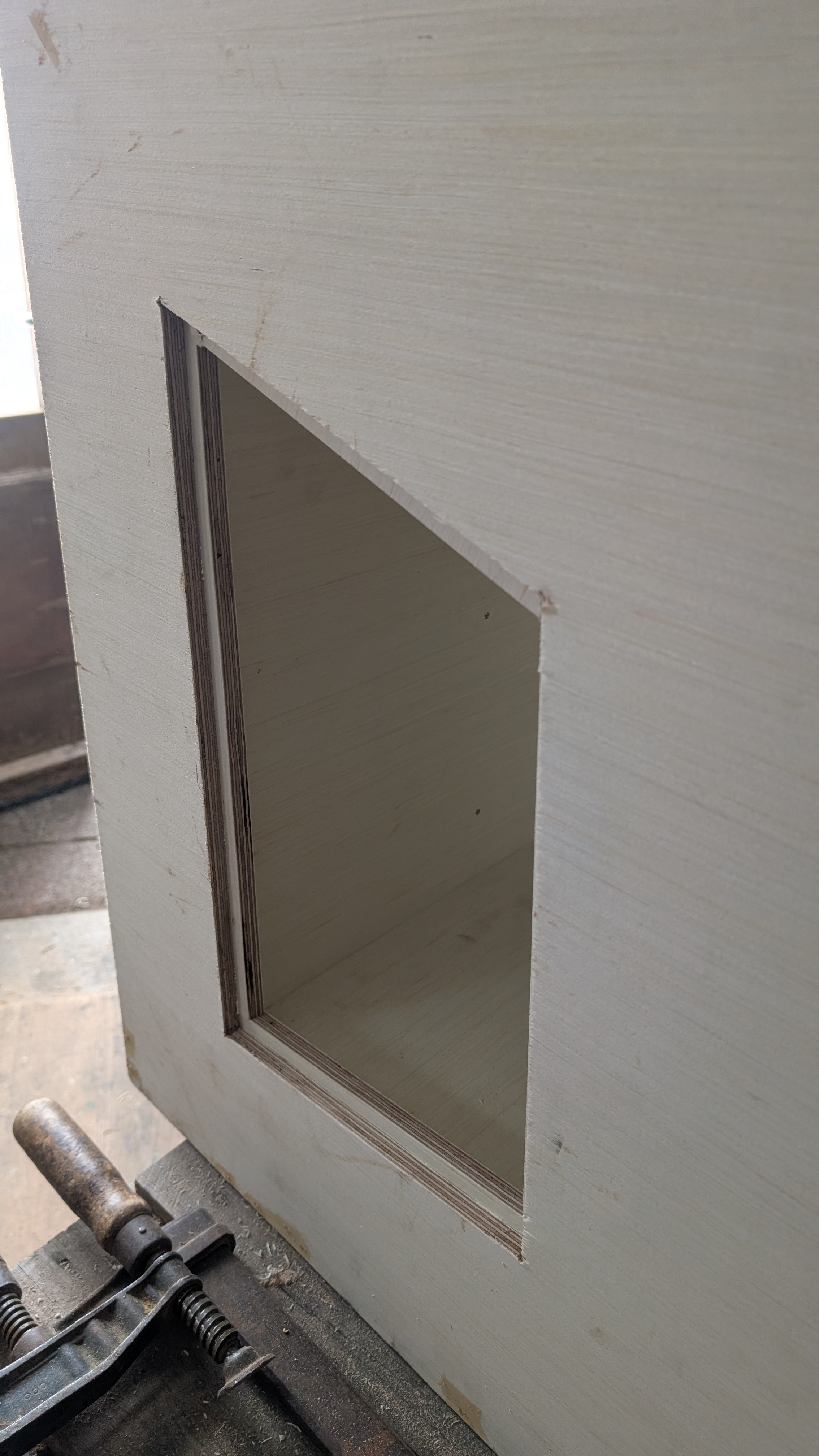

I stole some of the unavailable time, got the flanges and filled the holes...but not yet further -.-
Flanges done, will def do them in one piece the next cabs. For aligning during build, to avoid the build inside chamber now...would be a win even with more wasted wood.
Corrected oopsie, glued replacement and trimmed flush
