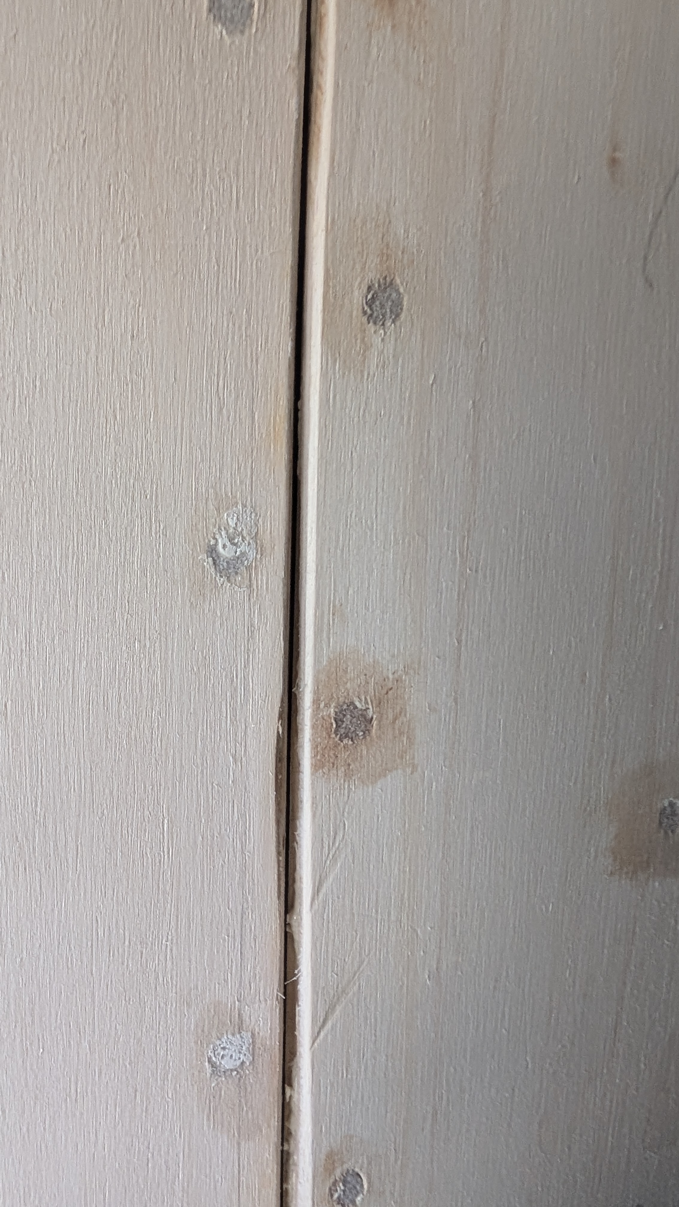

This is the gap i mentioned before...the frame behind it is flush (zooming in the gap shows).
Not sure how to finish that. Sanded to much when flushing the sheat in the middle; and by the waxing paper keeping me from seeing it also the hf-module-sheat is not til the end; this is the worst part, rest is smaller:
just even that groove and keep it that way? Tightness is created behind it with the frame, so it should work?
Will see what the weather has to offer, maybe i'll find a way to heat the shop at least a bit.

Posts: 3141
Re: 2 DR250 build - Europe Materials
#42 Post by Seth »
As long as the joint is sealed, I wouldn't worry about it. Once it's painted black, the gap will essentially disappear. If you really wanted to "fix" it, you could fill the blemishes with a sandable filler then reshape the edge. Given it's on the edge, something strong like JB Weld maybe. Tape on the flat, drizzle it in to fill where needed. I'm sure there's other solutions the guys can come up with. But, I don't think I'd stress about it. You'll be the only one who knows it's there.

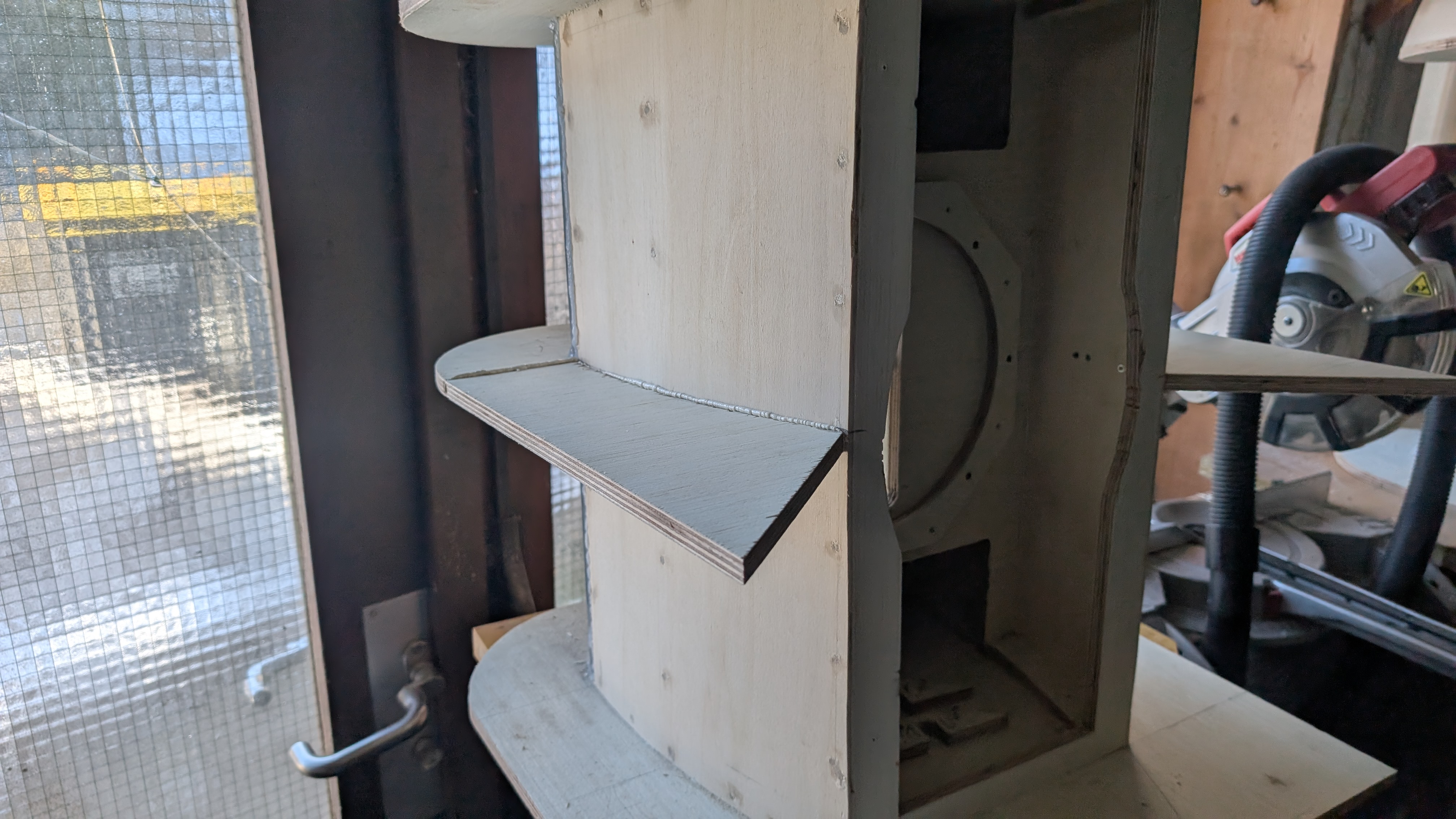

Marflinger
Posts: 113
Joined: Thu Dec 04, 2025 1:20 pm
Location: Germany-Blackforest
#43 Post by Marflinger »
Yeah, sealed it is. I will choose how to handle that in the end before painting.
Shaping edges with sandable filler will come apart by time, if i want to fill i'd need to glue wood on it and sand it down...but i think i'm to lazy for these tiny pieces.
I got little steps done again, it's all coming together :)
Had the bent backs pre-bent, but obviously not enough for the cold...the first attemt ripped in the middle :D
I then took fresh cut pieces, watered them in the shower until they were truly wet, and this worked like a charm without any cracks. I wanted to set them dry at first, and bend over time always a bit further; in a few days i'll undo the straps and glue/screw them down.
But as in party on both ends, i got the hf module further; i went for the sunken in screws as i found here in the forum; even with a small drill press somewhat comfy to do.
Will cut them flush, sand and fill the surface again and it should be super tight.

Now everything is cut, the rest of the dust will be only from sanding :) (and some easy cuts on side/backpanel)
With all the angles, think about it how to fix that together before glueing...as every step, think it through before starting.
Esp when having the inner ends not angled, i will saw them leveled when the pu is dry. But clamps will slip around on those angled pieces.
The sockets for the cd went out of the baffle-cutout; my cd have 4 screwholes, i hope i can reach down there to tighten them all...
First the holes, then the cutout.
The backs are still setting in the correct radius, maybe tonight i can glue them and then fit the sidepanels to it.
My backhandle still to do, and the wire has to go through there as well...will see how that works out.
