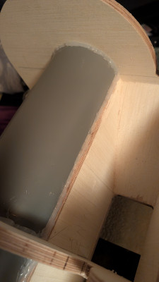

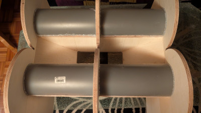

Found out that i have severe trust issues @hot melt glue, but i think it will be fine.

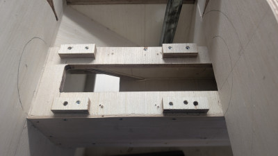

I screwed little scraps underneath to hold the tubes in position and spread far enough, i hope that doesn't matter in terms of lost chamber volume. But way simpler that way.

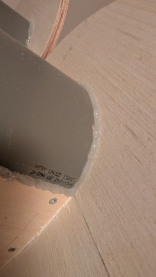

I think i'll leave the glueworm around the round edge for stability (and for my trust issues)
All flush to a sandable distance
the scraps to keep it in place and width
cutting it flush and sanding it tomorrow, when the weather is nice enough
Trust issues result in overglueing i guess, but so everything is filled up and a bit messy
Additional, for the german supply hunters: both cabs went through 1m pieve of ht110, the coupler at the end cut flush. I thought it wouldn't be enough, but it sits perfectly as lang as you have no errors. Cut precisly, and 1m is enough for two cabs without any leftover.
