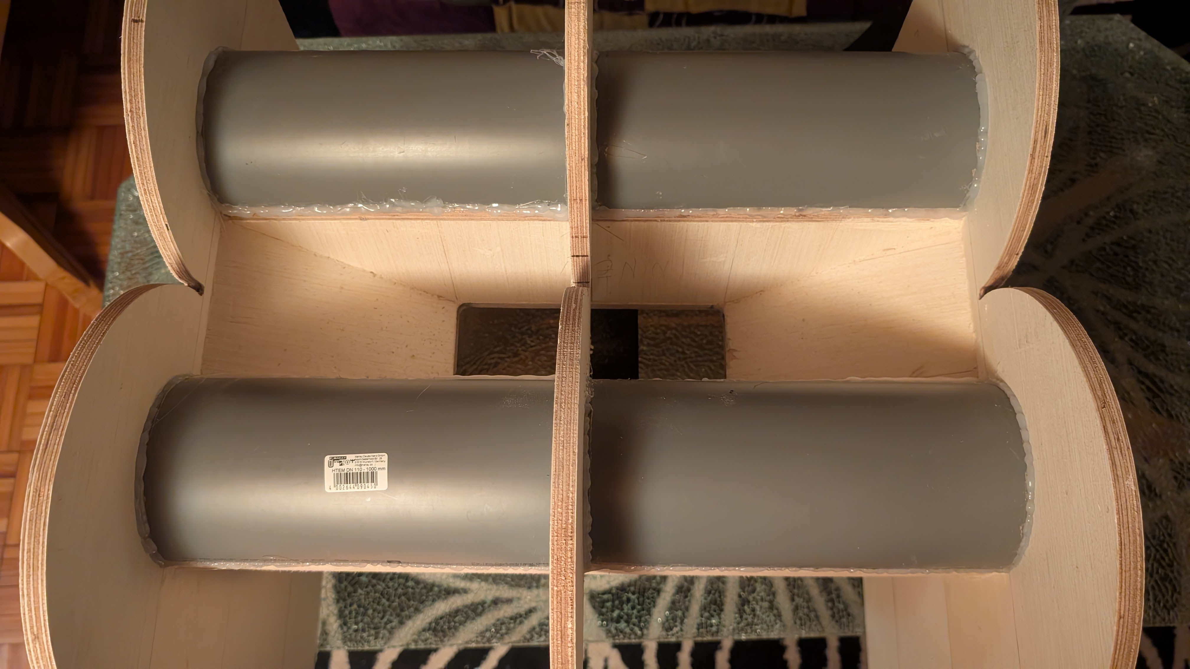

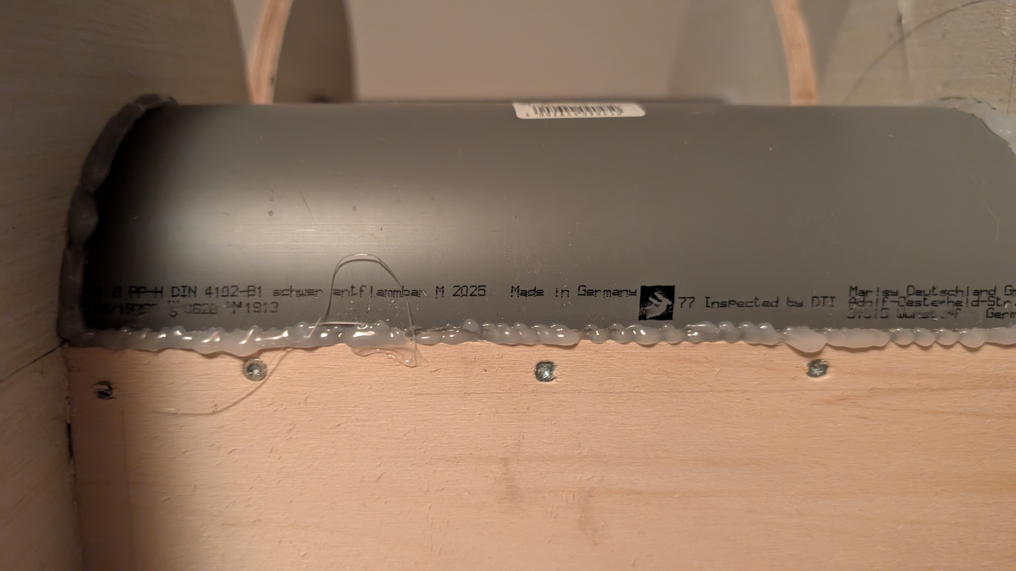

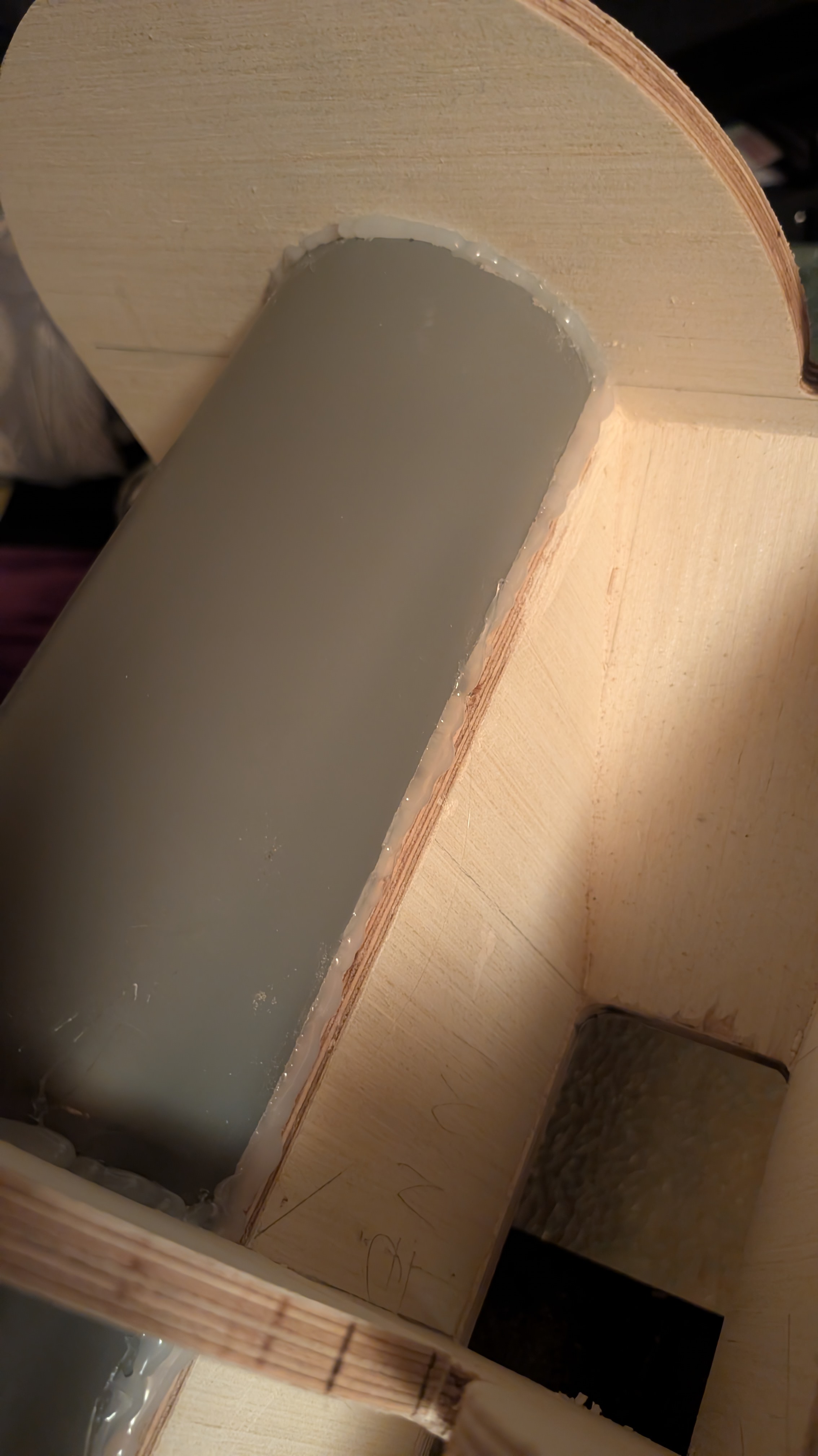

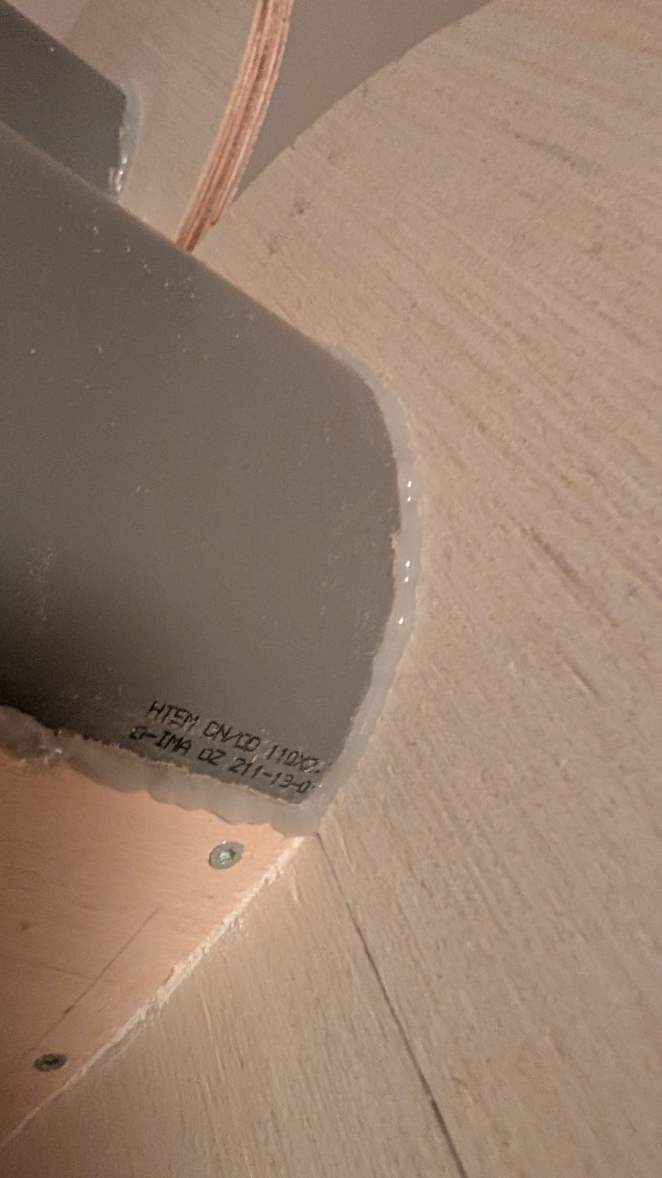

Found out that i have severe trust issues @hot melt glue, but i think it will be fine.
I screwed little scraps underneath to hold the tubes in position and spread far enough, i hope that doesn't matter in terms of lost chamber volume. But way simpler that way.
I think i'll leave the glueworm around the round edge for stability (and for my trust issues)
All flush to a sandable distance
the scraps to keep it in place and width
cutting it flush and sanding it tomorrow, when the weather is nice enough
Trust issues result in overglueing i guess, but so everything is filled up and a bit messy
Additional, for the german supply hunters: both cabs went through 1m pieve of ht110, the coupler at the end cut flush. I thought it wouldn't be enough, but it sits perfectly as lang as you have no errors. Cut precisly, and 1m is enough for two cabs without any leftover.

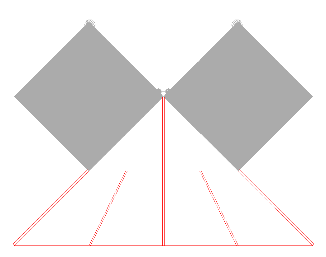

And for my other question, if the T30 would improve by adding more Horn:
This is the sketch i promised:
Sure with bracing, but if that would increase the output this would happen at around zero needed storage volume as they can be stored in a flat pack.
And the "big" top/bottom could be clamped on four T30 for transport to have one cart of 2 by 2 T30, secured together by the big plates. This would be exactly one stack, 4 T30s with the top/bottom on the sides and the adittional bracing and 30 inch wide sidewalls somehow seperated.

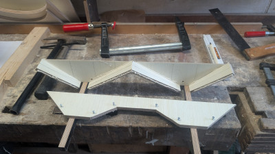

Now i got all the small parts fronm the HF-Module done, and finally glued them in.
Next will be the sides of the HF-Module, and when it is removed from the cab to get the HF-Horn in it i can do parallel on the HF-Horn and the back-cheeks from the LF-Horn.
The middleparts, very tiny indeed, worked best clamped together.
These little pieces annoyed the crap out of me. But it came in handy, to just make one to size, check fit on the cab, take that as a preset, cut it roughly by hand and sand it down until it fits.:
Cutting roughly
Stationary Disksander i found in the shelves did really well on that.
Glue setting like that, yesterday. Today the walls are next, and then sanding of all the interieur.
Found it handy to fix the Diffusor bracket holder on top/bottom as sort of a ruler to fit the parts to. Not sure why the glueing together is later in the plans, figured i will probably notice when progressing further. So far not glued, just the middle one.

Now everything is cut, the rest of the dust will be only from sanding :) (and some easy cuts on side/backpanel)

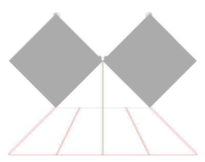

With all the angles, think about it how to fix that together before glueing...as every step, think it through before starting.
Esp when having the inner ends not angled, i will saw them leveled when the pu is dry. But clamps will slip around on those angled pieces.

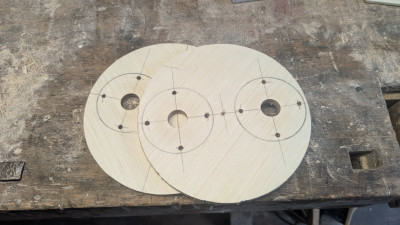

The sockets for the cd went out of the baffle-cutout; my cd have 4 screwholes, i hope i can reach down there to tighten them all...
First the holes, then the cutout.
