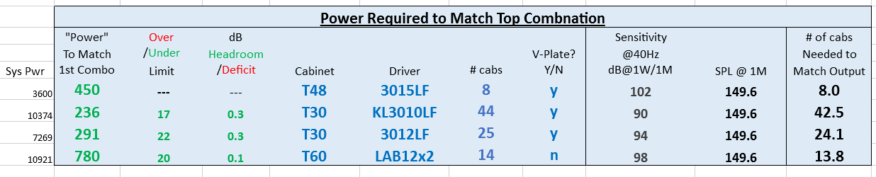

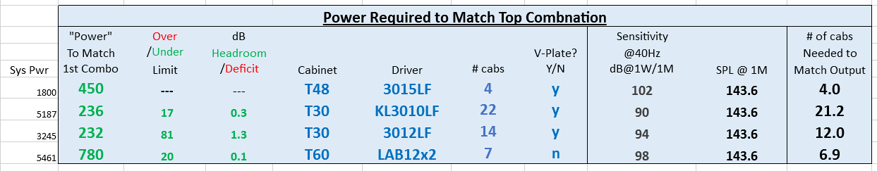

Marflinger wrote: Wed Dec 31, 2025 1:20 am
Tom Smit wrote: Tue Dec 30, 2025 10:56 pm
This might be an answer for you. I thought that for the T30, the V-plate only 2db (3db for T39 and T48). So, if one would add 2db to the red trace, the difference is very little. These two cabs shown are half the width and half the drivers as per your plan so it should give a fair representation of the differences.
The 4db is from the plans, but stated there as the "lower end" (so rather tilt then shift up, but idk where. Relevant only below 80hz)
Even if we assume 2db, adding up together with a flatter response due to stacking (as your chart is single ten an single twelve, it's eight times that per side) it should be pretty close. Below 80hz the t60 rides with a distance of ~5db, assuming the 2db v-plate benefit it would shrink to 3db.
This guessing around was it, what led me to the idea of maybe t30 with a v-plate would be sufficient, as the previously introduced ratio would be somewhat halved (1:2 without plates, 1,5:2 with plate)
Thank you for that comparing chart, makes it visible way better.

Seth wrote: Wed Dec 31, 2025 12:18 am Outdoors, two stacks of 4 full width (36") T48's will way outperform two stacks of 4 T60's (or 4 double 10 loaded T30's)
outperform in terms of? Spl below 80hz? Above? Db per watt input?
Seth wrote: Wed Dec 31, 2025 12:18 am But... Numbers don't lie. Numbers have no bias.
Do you have those numbers handy, or can point me to the place where i can find them? Bc the numbers i found walk in other directions...
But this is the point of my questioning, i try to decide on numbers or at least approximations and want to avoid religious beliefs and similar.

A few years back I put together a spreadsheet to help me see the picture a little more clearly. It's not completely comprehensive and this particular calculator I created only compares the cab's at 40Hz and assumes full width cabs based on driver size. The results aren't the full picture, but gives you a good idea of how the cabs compare. Way off to the left is total system power for each option.
A note that, even high passed at 35Hz on a 24db/octave slope, Four full width T48's will outperform 8 T30's at 30 Hz.
30" is a good compromise width for a T48, although 36" is a full width cab when built with a 15" driver. It's a massive cab. Although, laid on their sides, three stacks of two and two slid on top might fit in the space you described for a Eight cab system.
Here's what you'd have to build to match the output potential of eight T48's...
Keryn O'Shea
Posts: 617
Location: Brisbane, Australia
Re: T30/T48/T60
#13 Post by Keryn O'Shea »
Seth wrote: Thu Jan 01, 2026 8:54 pm Here's what you'd have to build to match the output potential of eight T48's...
:shock: Well... that's amazing
