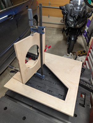

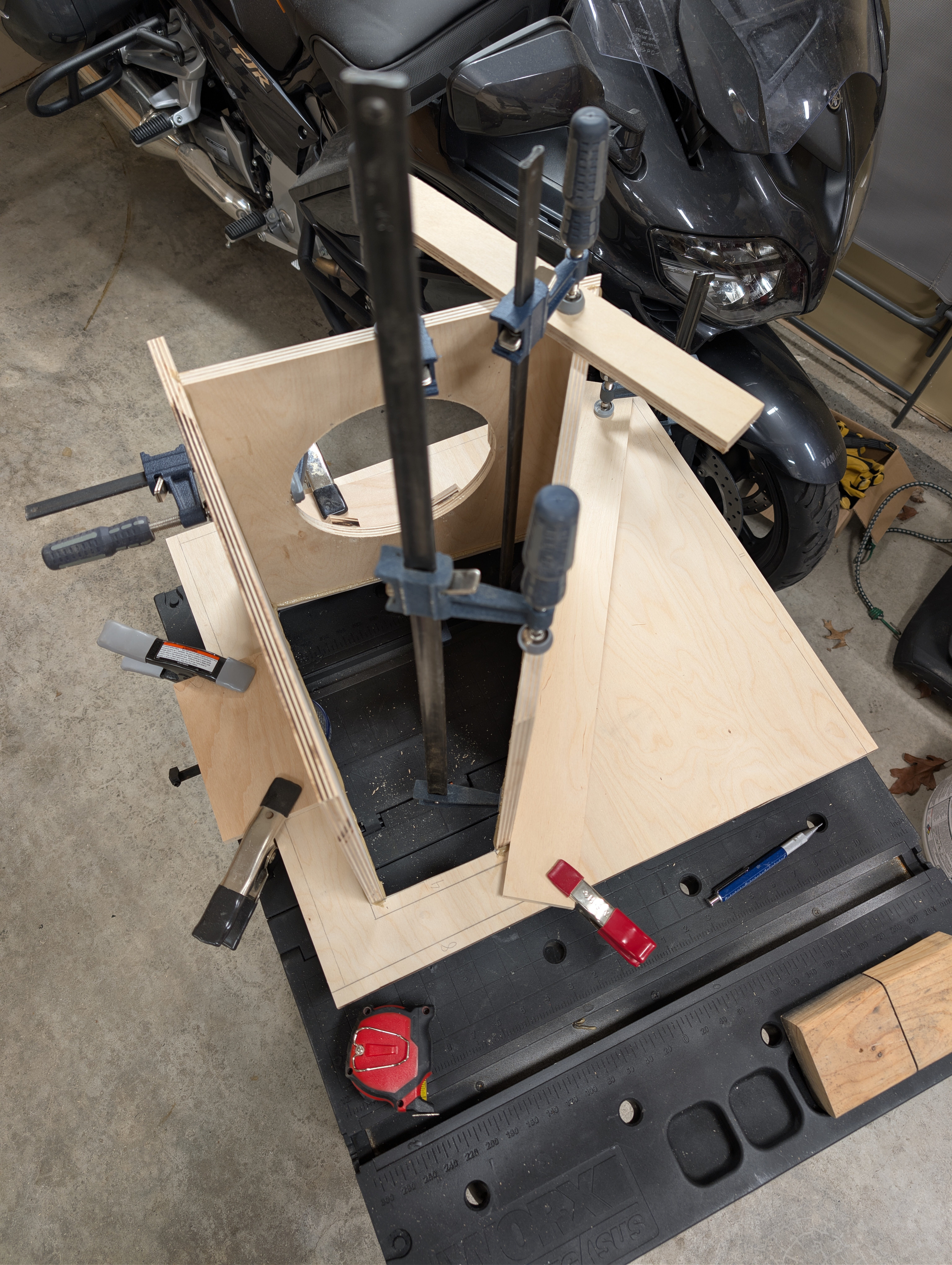

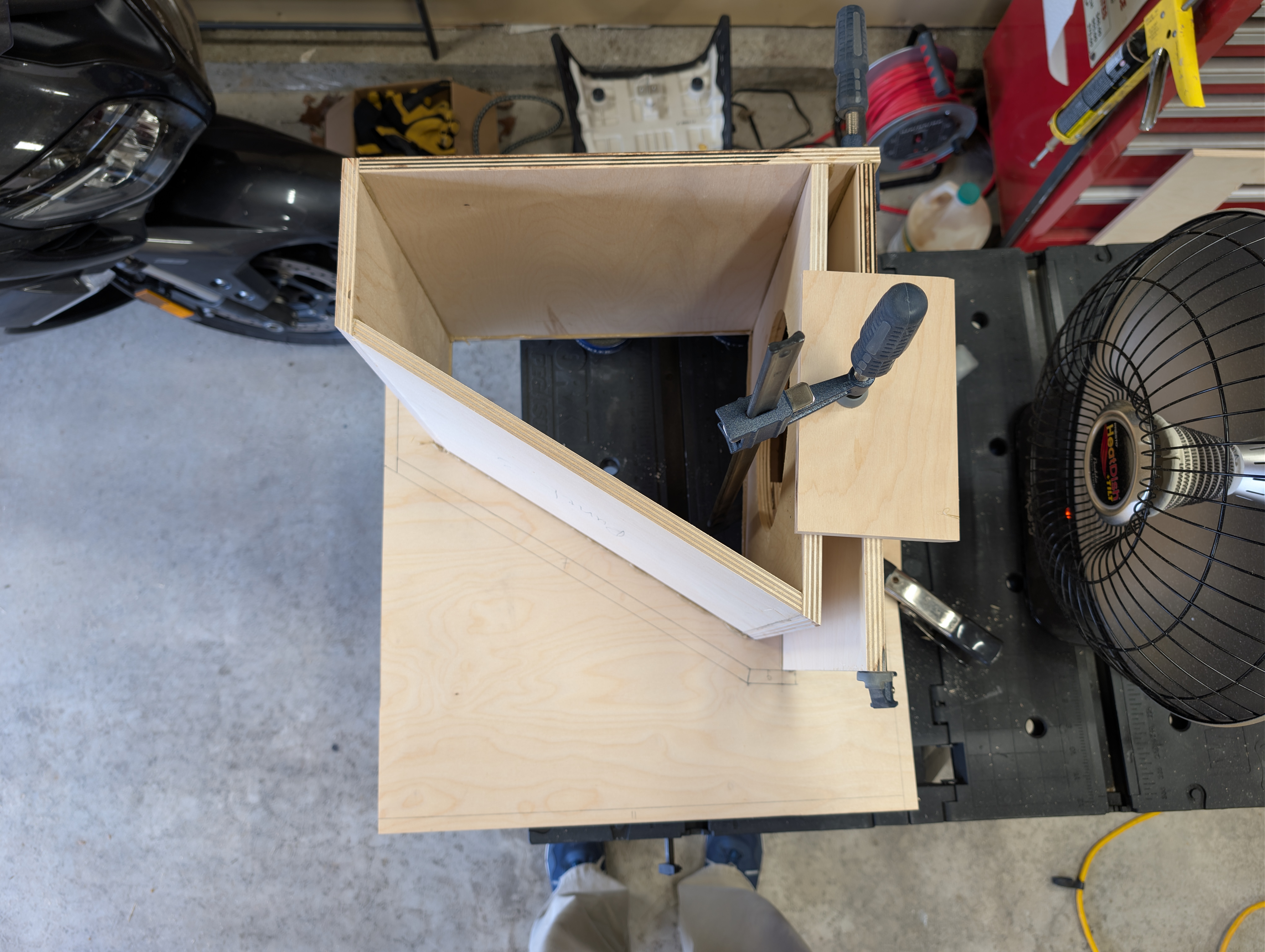

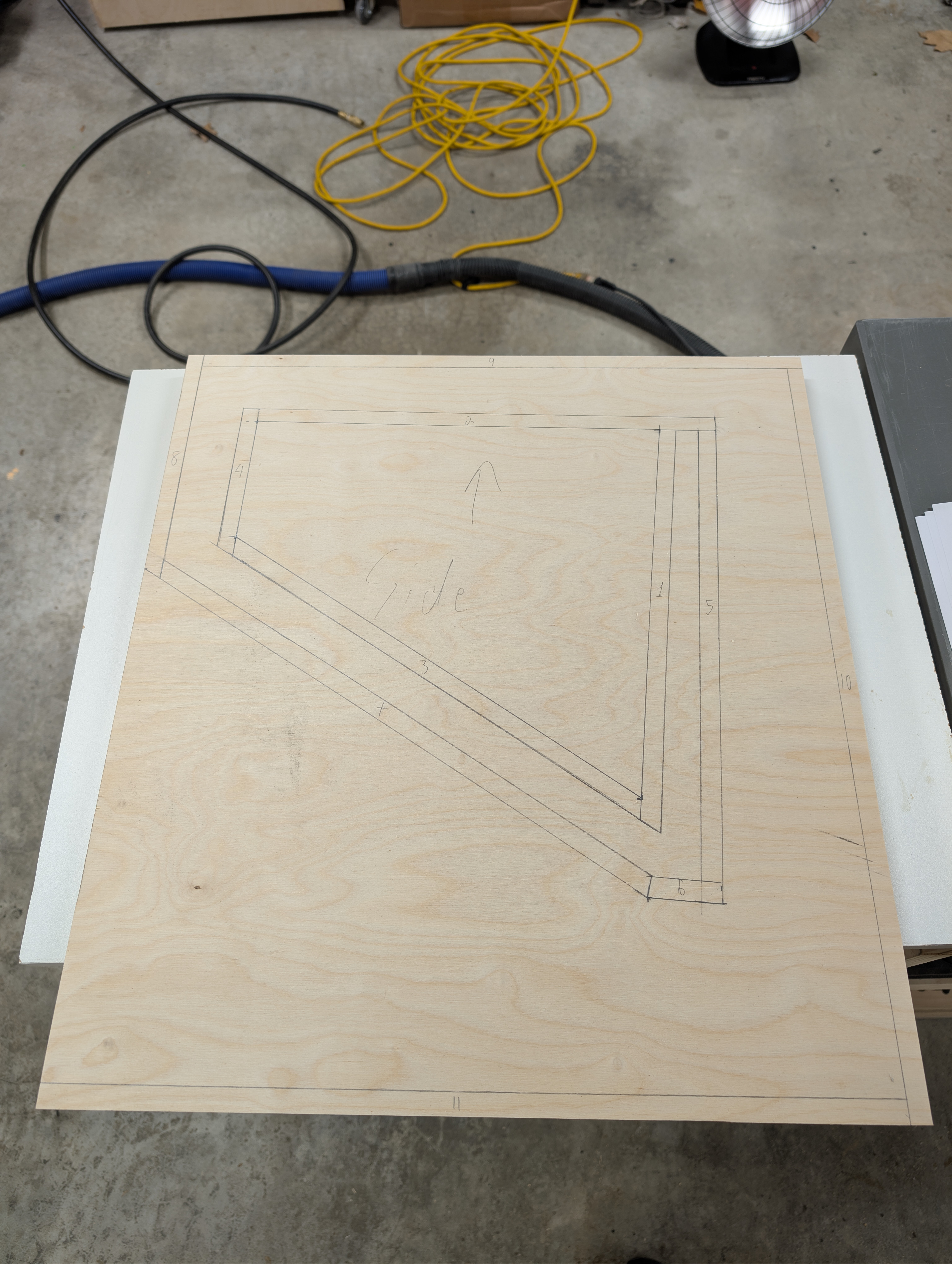

Good morrow everyone. Been working a few days on the TAT that will go into my double-cab Toyota Tundra. Will be 8" loaded and 14" wide OD.
On to the PITCHERS!
Look at all that beautiful squeeze out

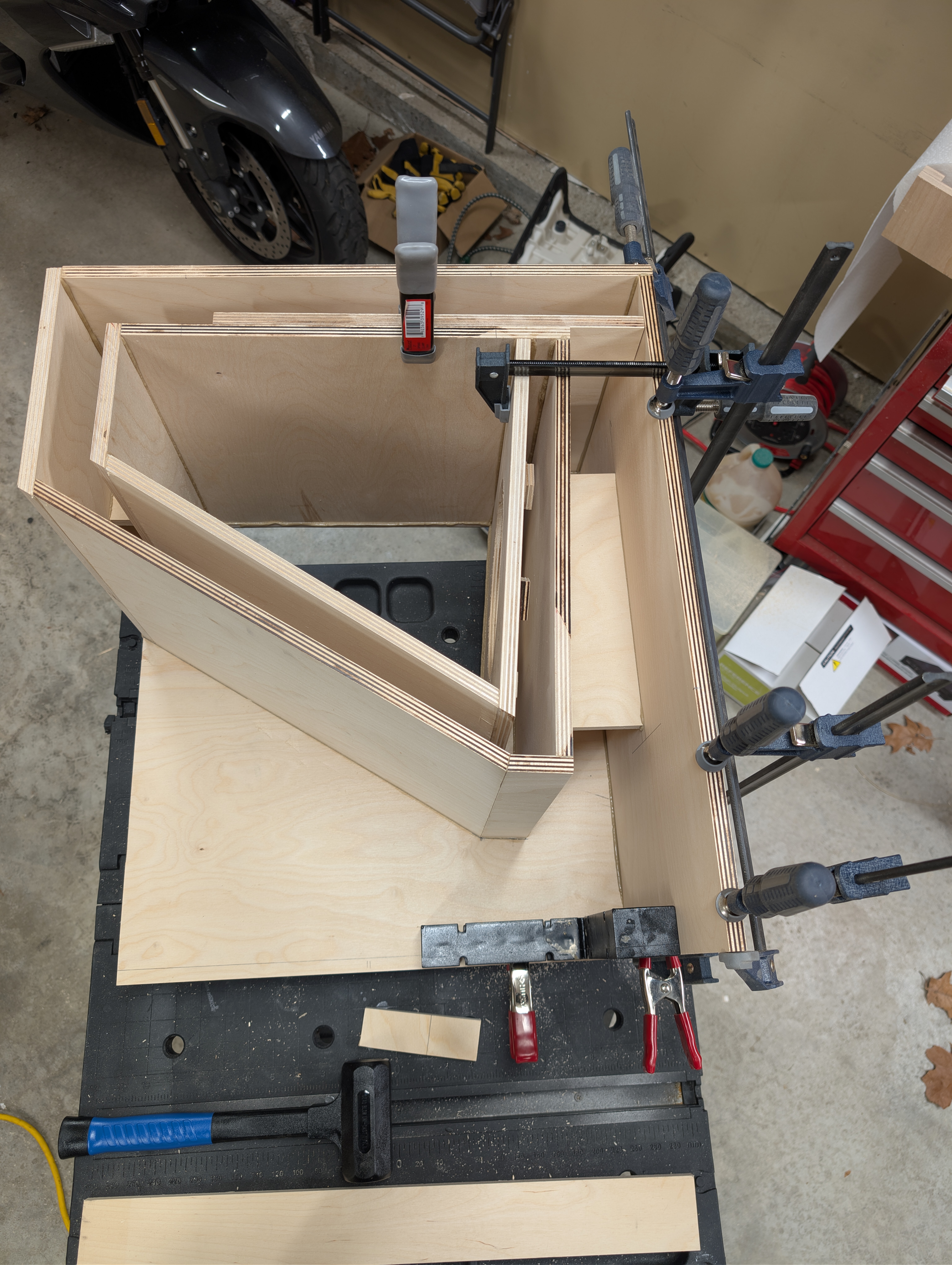

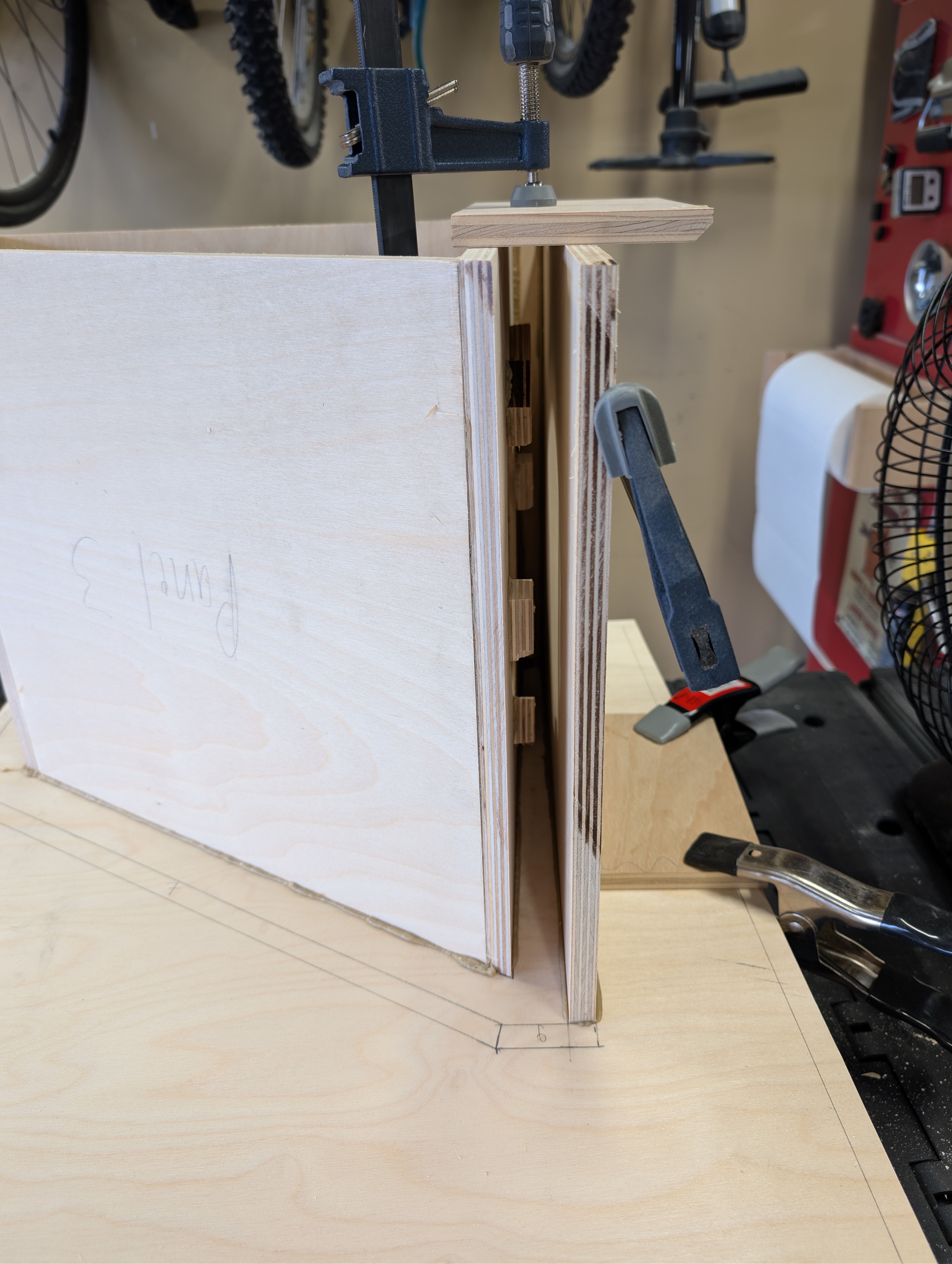

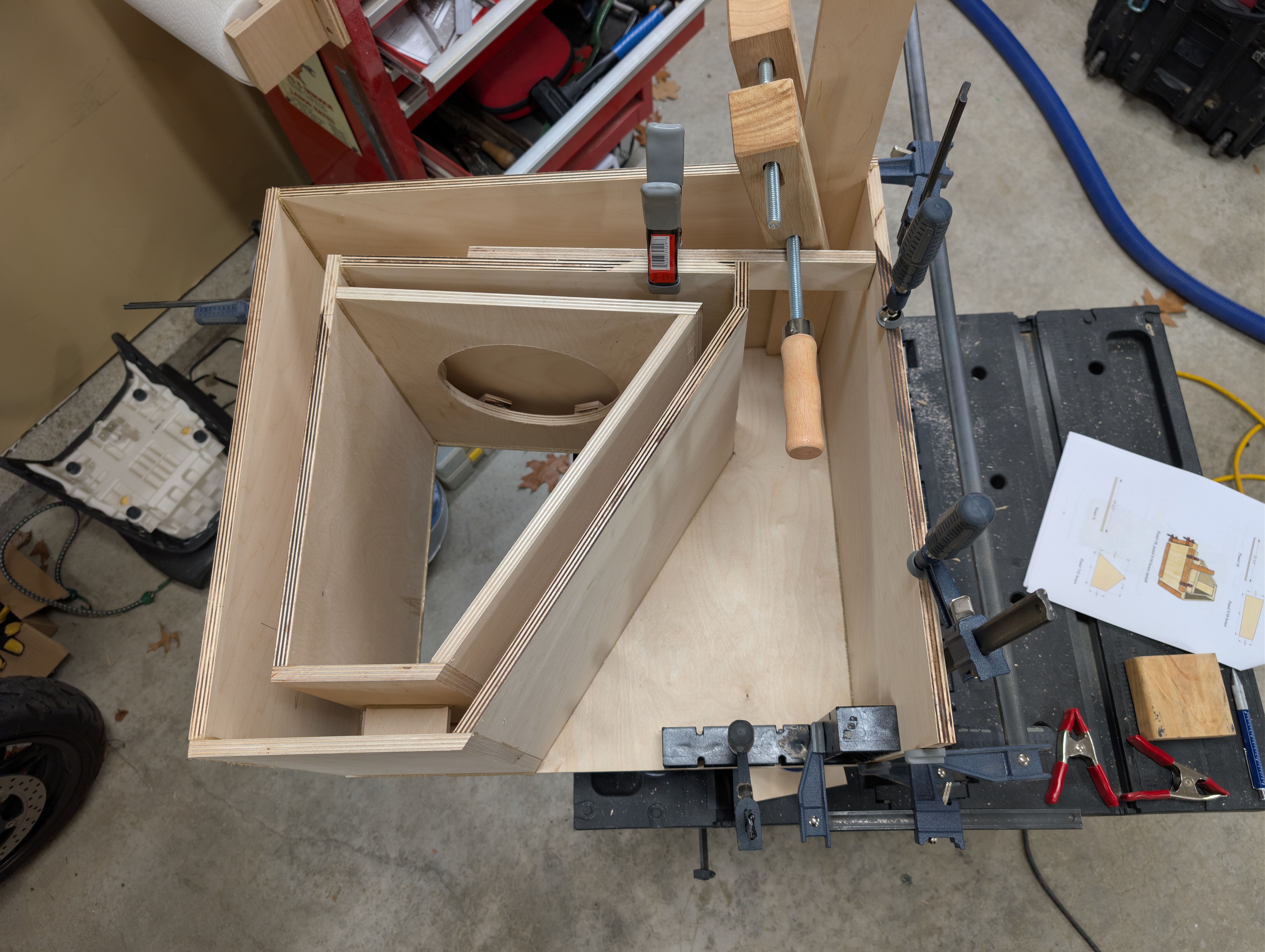

MOAR PITCHERS

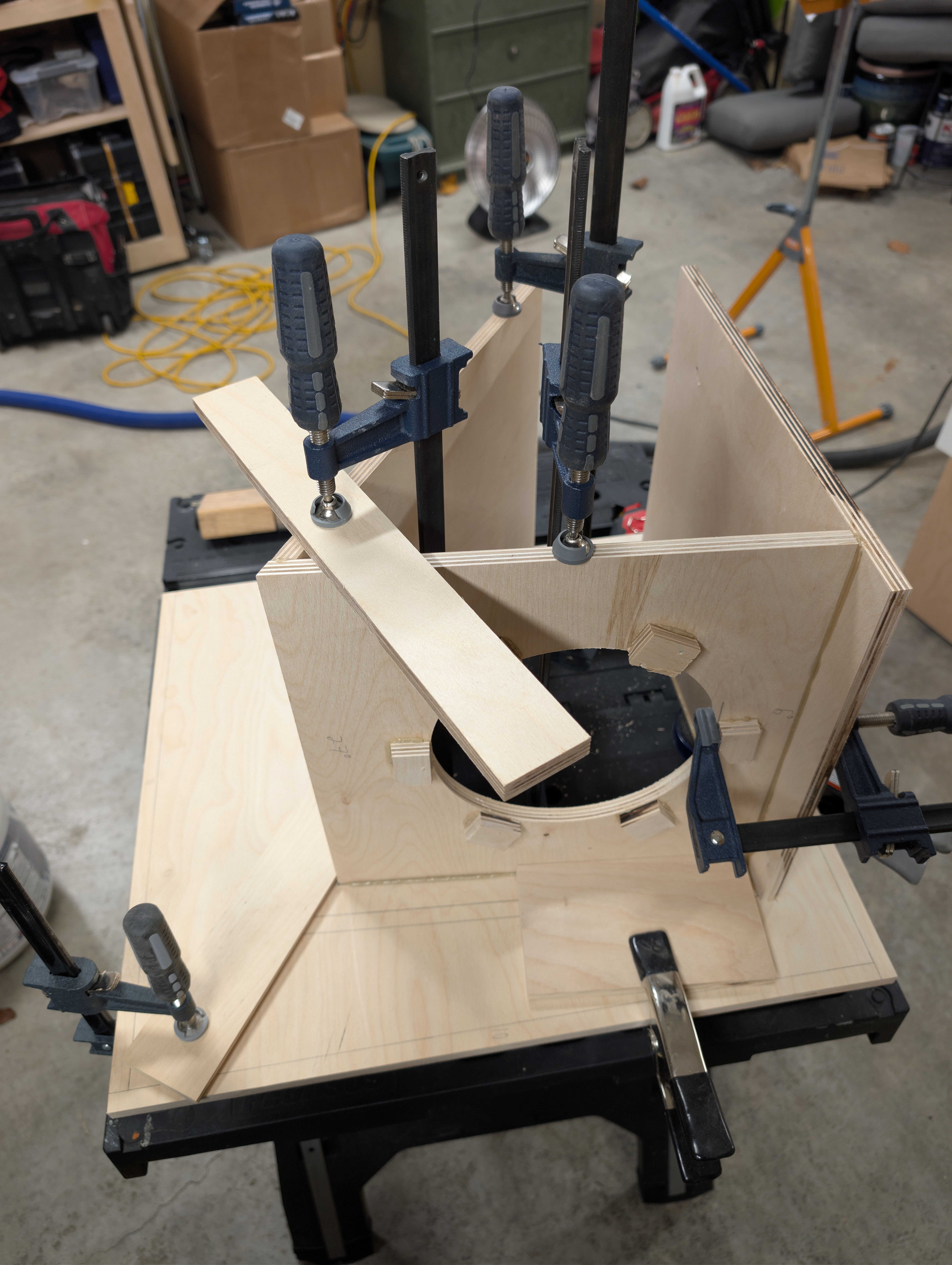

Currently letting panel 10 set up. Will hopefully get panel 11 in place today.
Semi-pro tip: using an infrared heater on medium low really helps the PL set up faster in cold weather. That's why you see the heater in a lot of the pics.
Posts: 29051
Re: TAT Build
#4 Post by Bill Fitzmaurice »
Spritz it too, cold air is dry air.

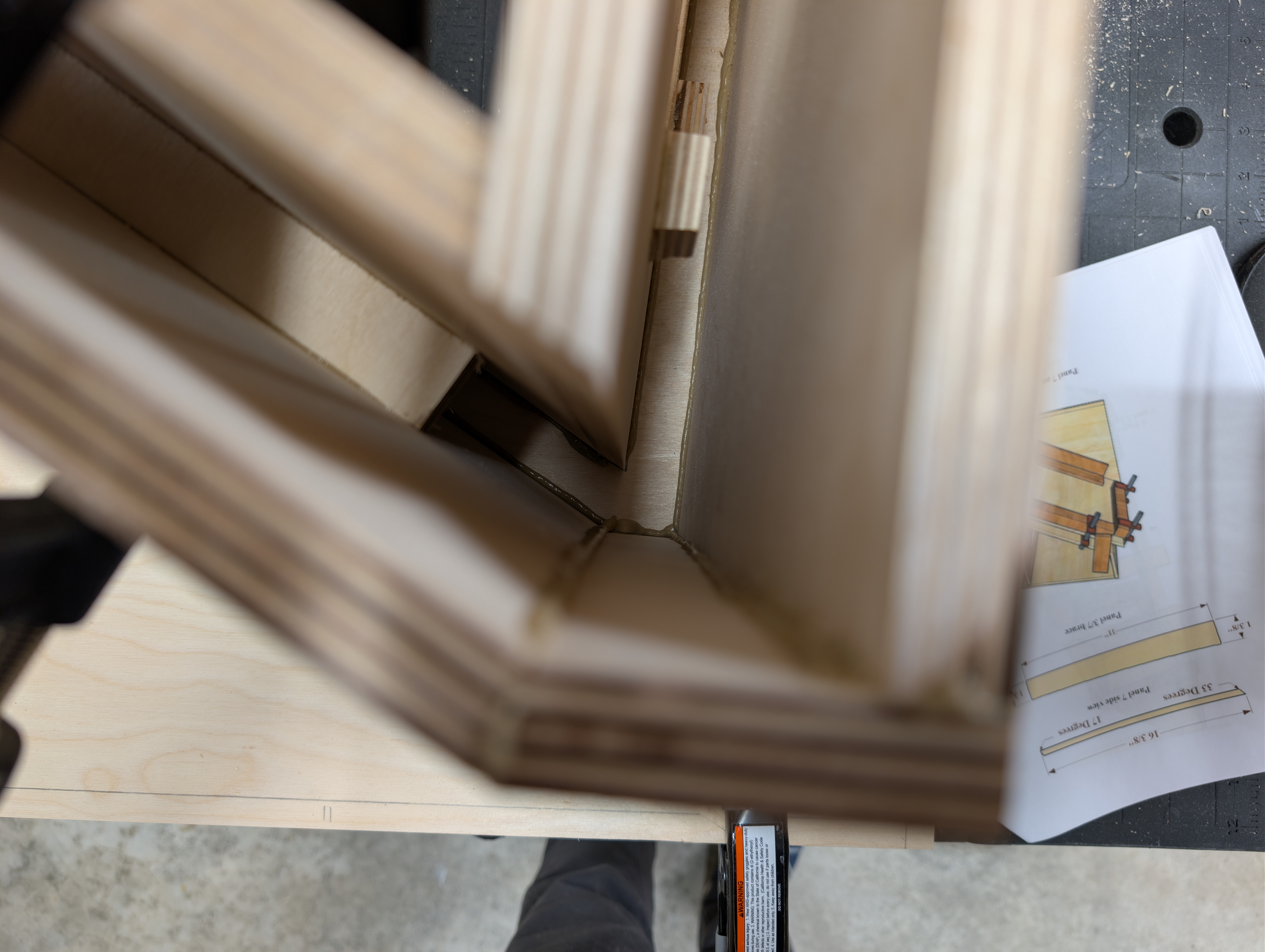

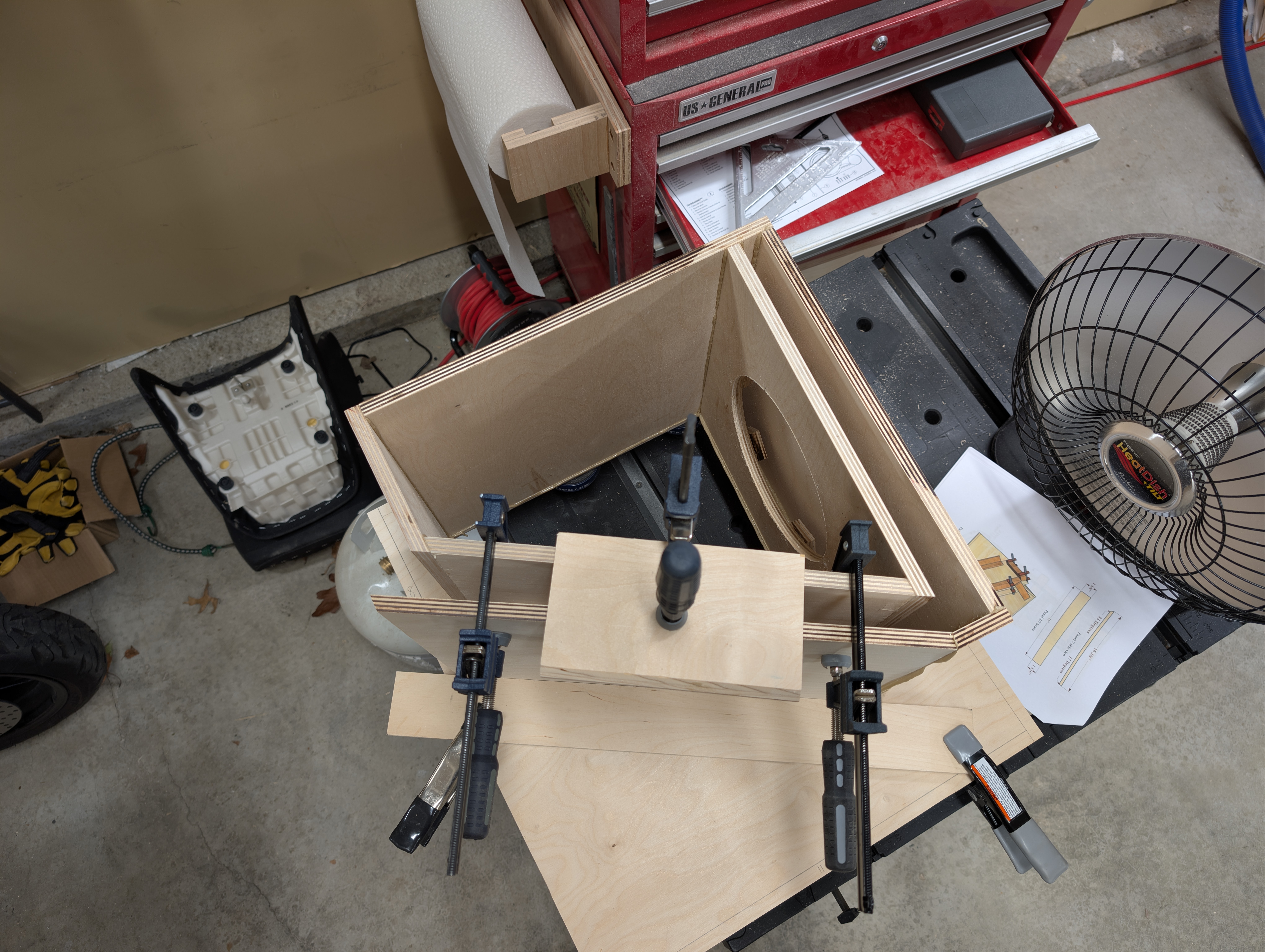

#6 Post by shane2943 »

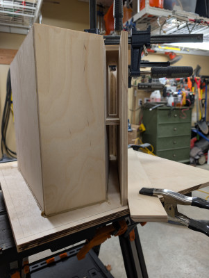

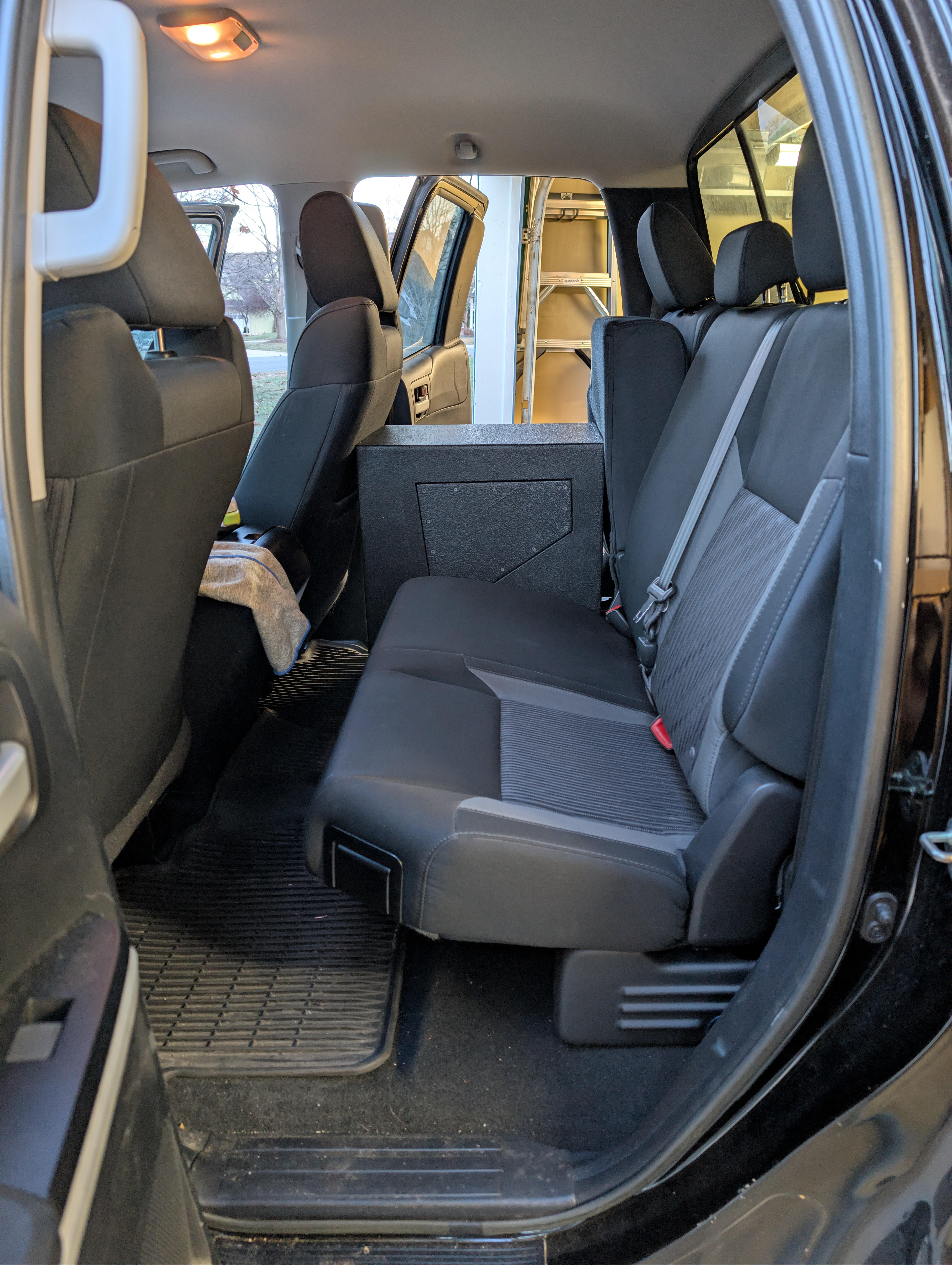

Panel 11 is now in place. Once it's set, I'll get the brace cut out. The brace is going to double as a brace and handle as I want the sub to be easily removable from the truck cab in case I need the space in the back seat.
Also, can NEVER have too many clamps!

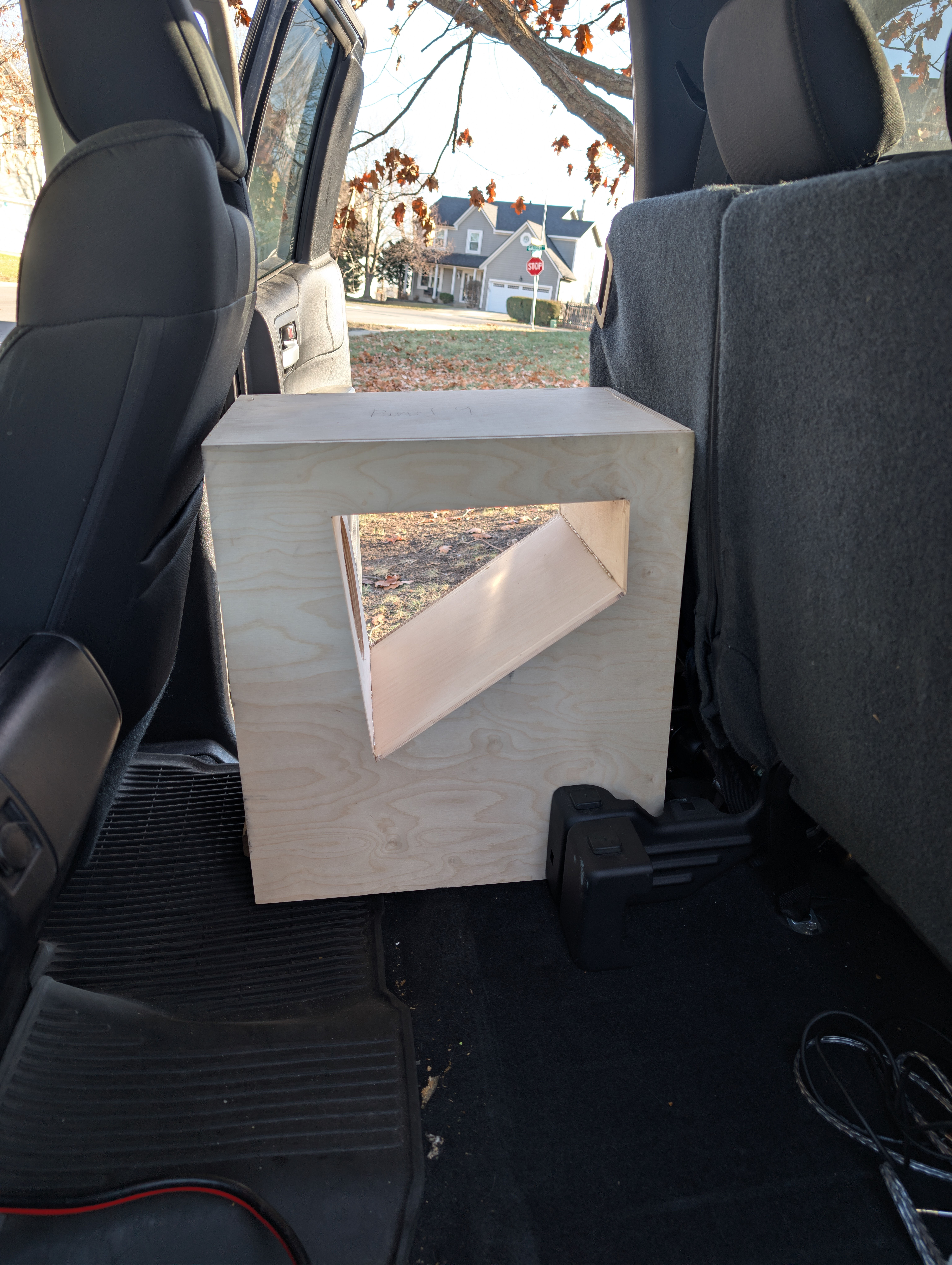

#8 Post by shane2943 »

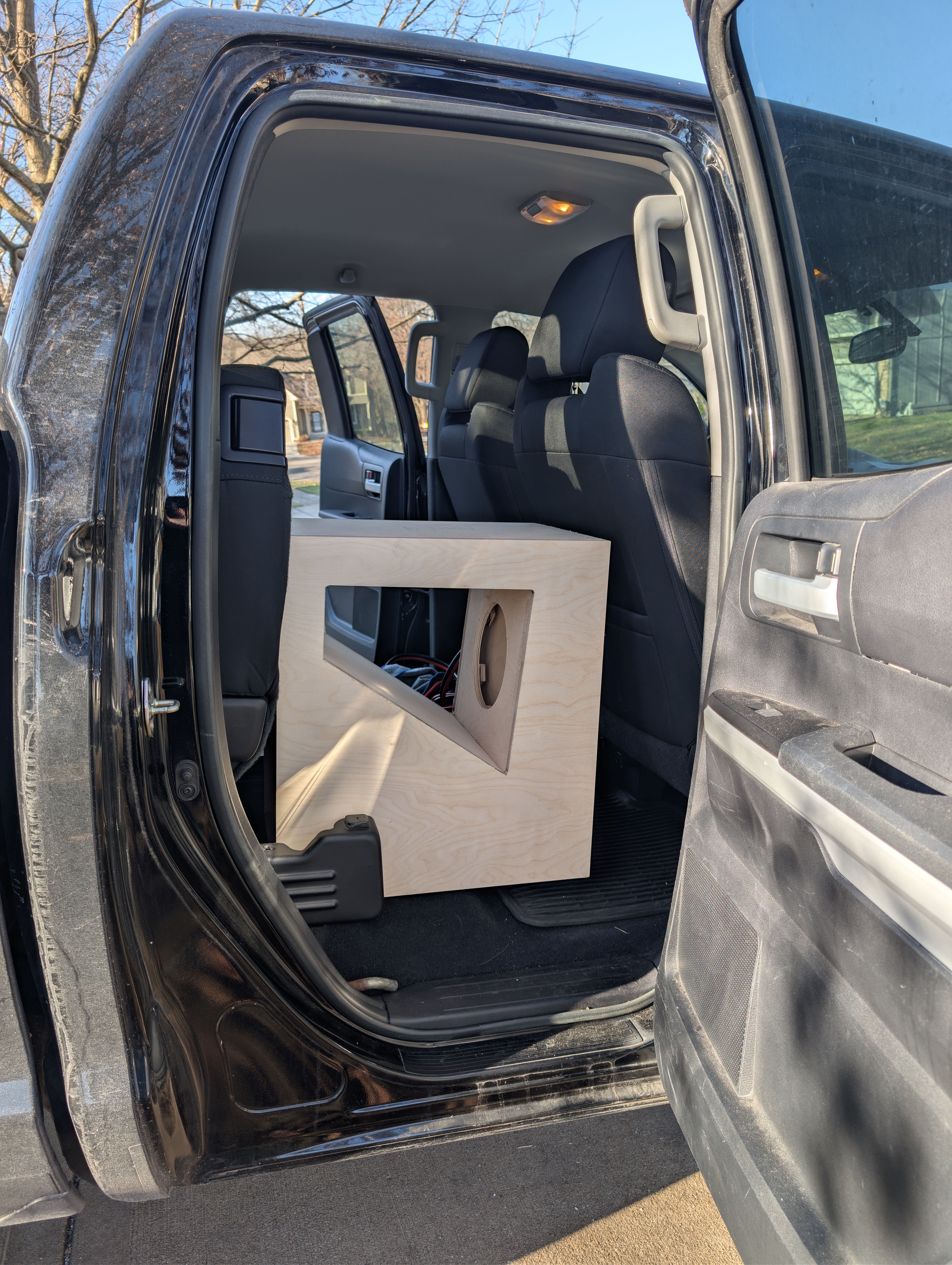

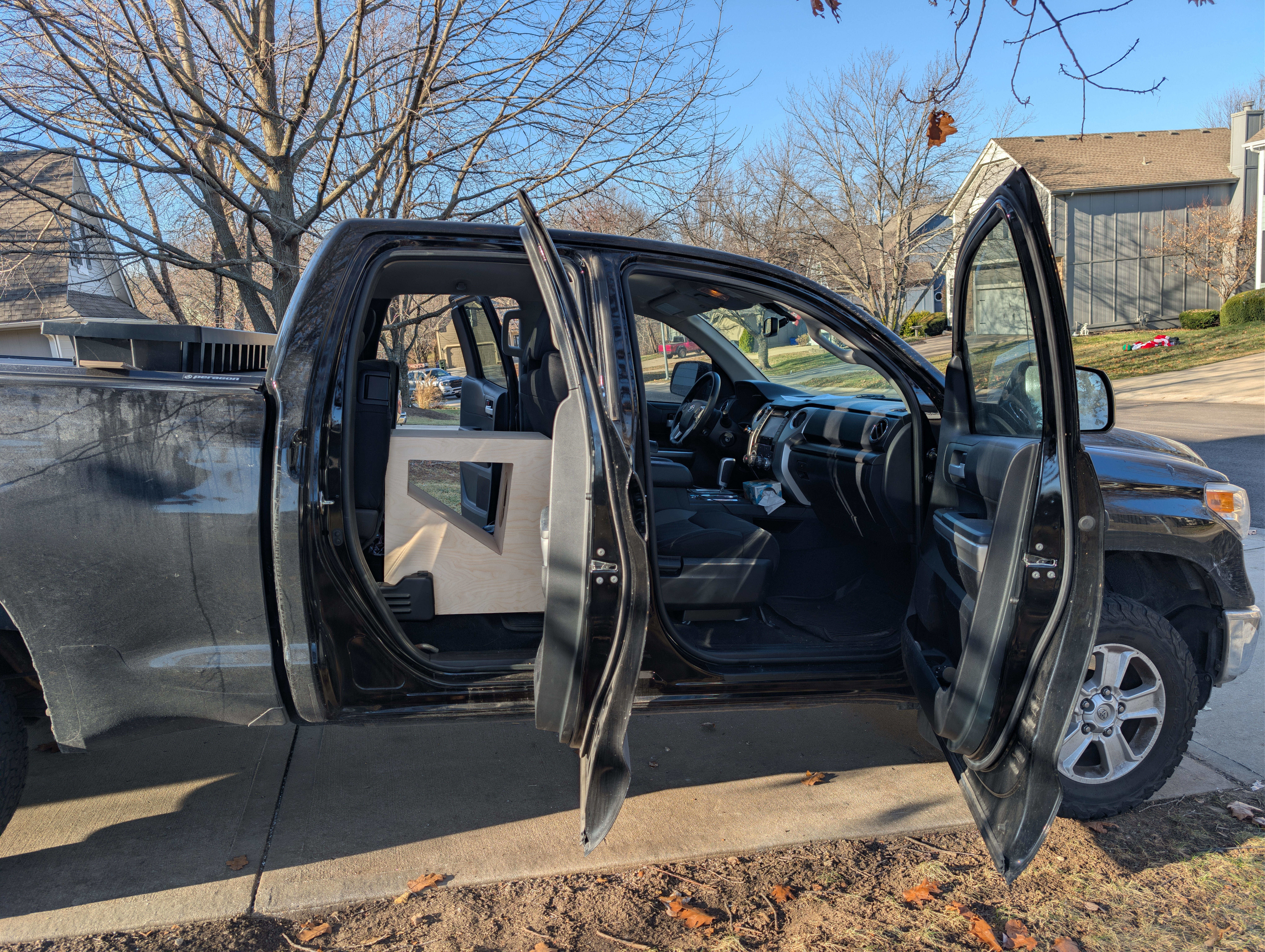

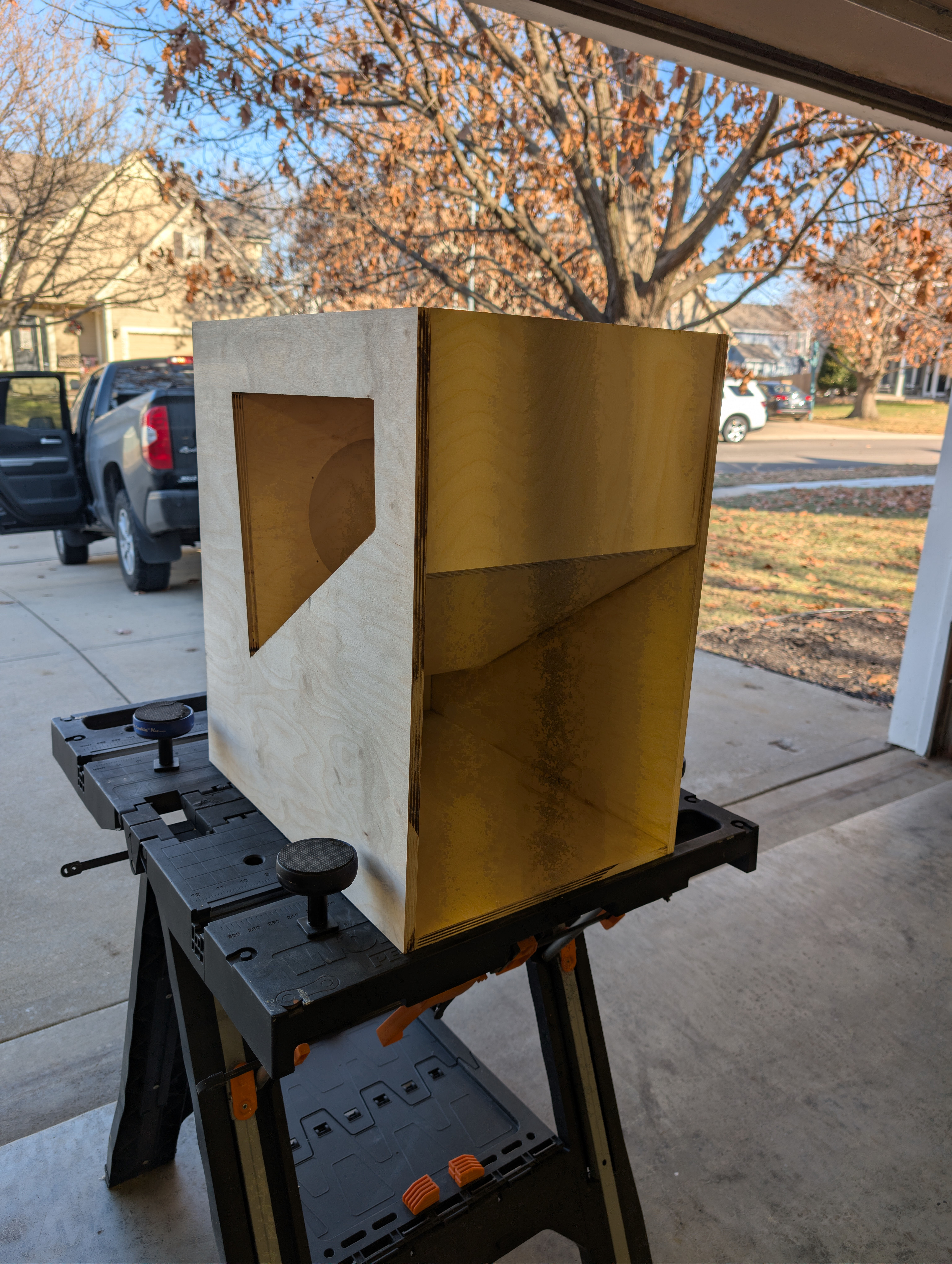

Got the second side attached. I was able to do a test fit in the truck and it fits perfectly between the seat rails!
@Bill (or anyone who would know): the ID width of this cab is 13" (14" OD). Is the mouth brace necessary for a cab this skinny? I'm rethinking the handle situation after test fitting it in the truck. If the brace is necessary (which I assume it is given that the plans don't say otherwise), then I'll make it work.
Posts: 29051
Re: TAT Build
#9 Post by Bill Fitzmaurice »
I go with no more than 6 or so inches of unbraced panel width. It may not be absolutely necessary, but I'd rather be safe than sorry.

#10 Post by shane2943 »
Thank you sir. I will add the brace

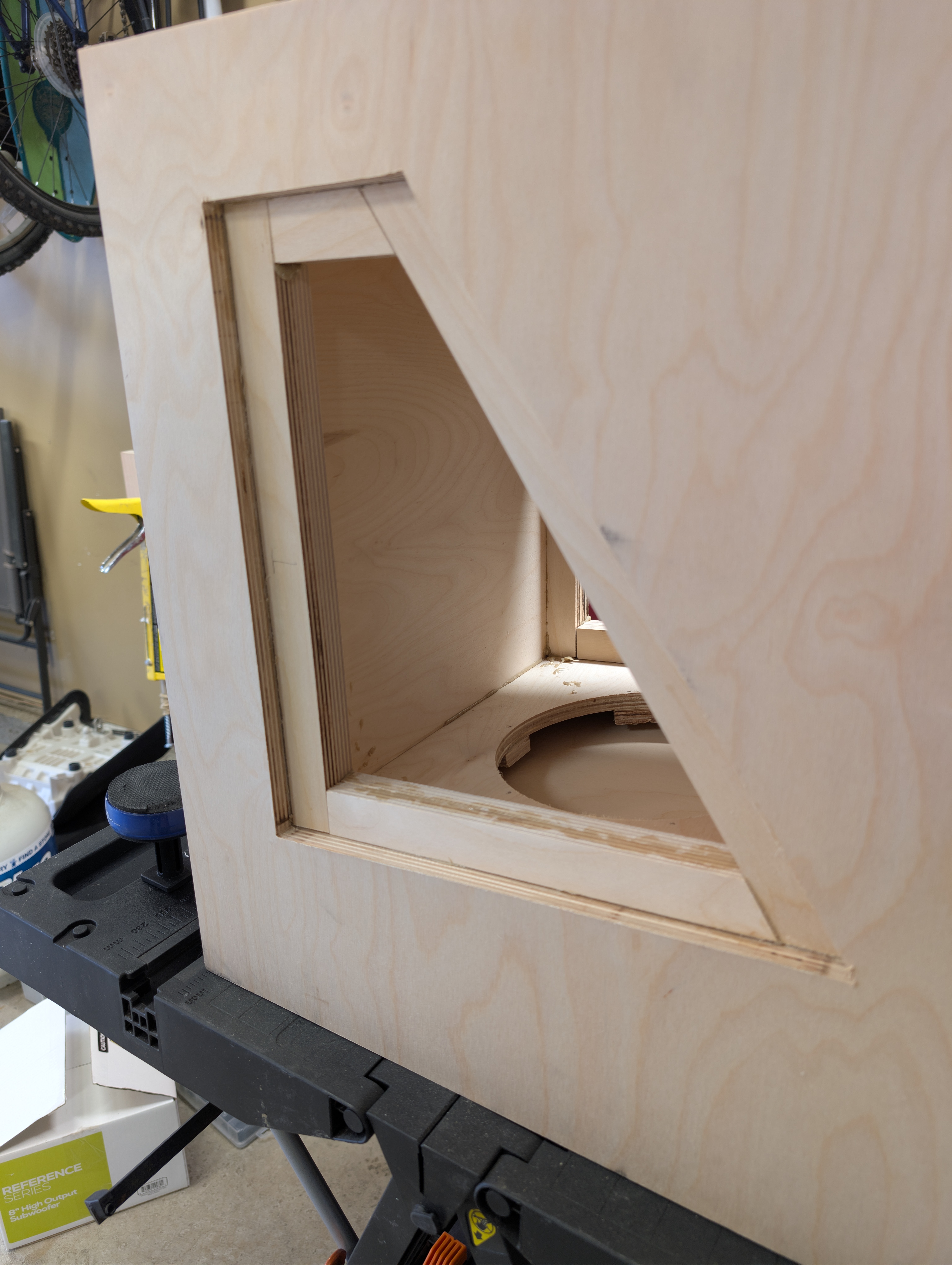

#11 Post by Rich4349 »

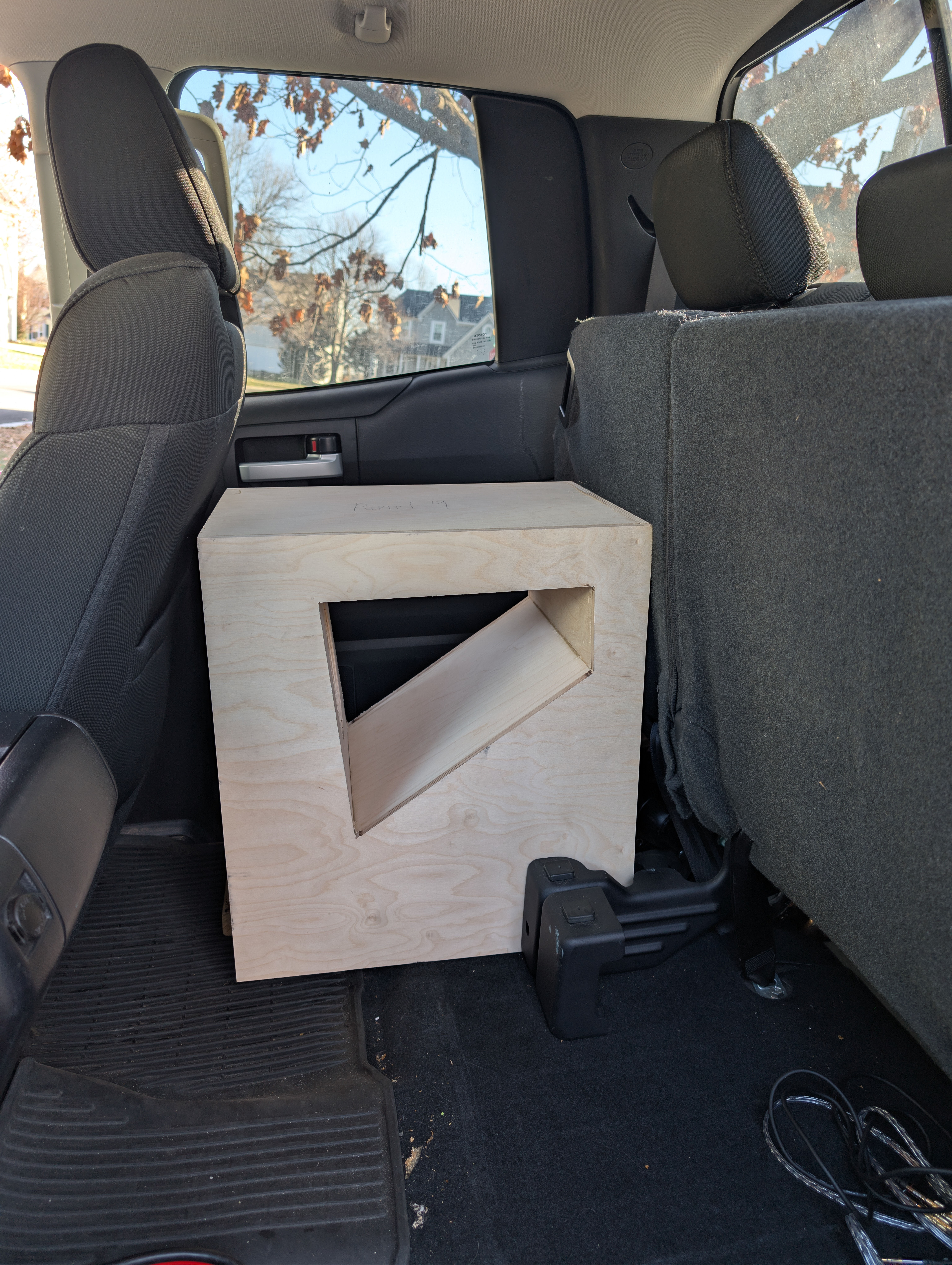

It LOOKS like the top, forward corner where it first interrupts the seat reclining angle could be trimmed down a bit, so long as the new angled throat dimension remains greater than the preceeding smaller throat area. (Titans have angled corner bracing there.) Trimming with commensurate polyurethane sealing could make your passengers' rides more comfortable.

Rich4349 wrote: Tue Dec 16, 2025 3:13 pm It LOOKS like the top, forward corner where it first interrupts the seat reclining angle could be trimmed down a bit, so long as the new angled throat dimension remains greater than the preceeding smaller throat area. (Titans have angled corner bracing there.) Trimming with commensurate polyurethane sealing could make your passengers' rides more comfortable.

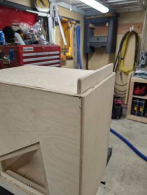

Though about that and decided against it. The main person that rides in the passenger seat is my wife and she doesn't like to recline the seat. So I opted to just keep it "stock."

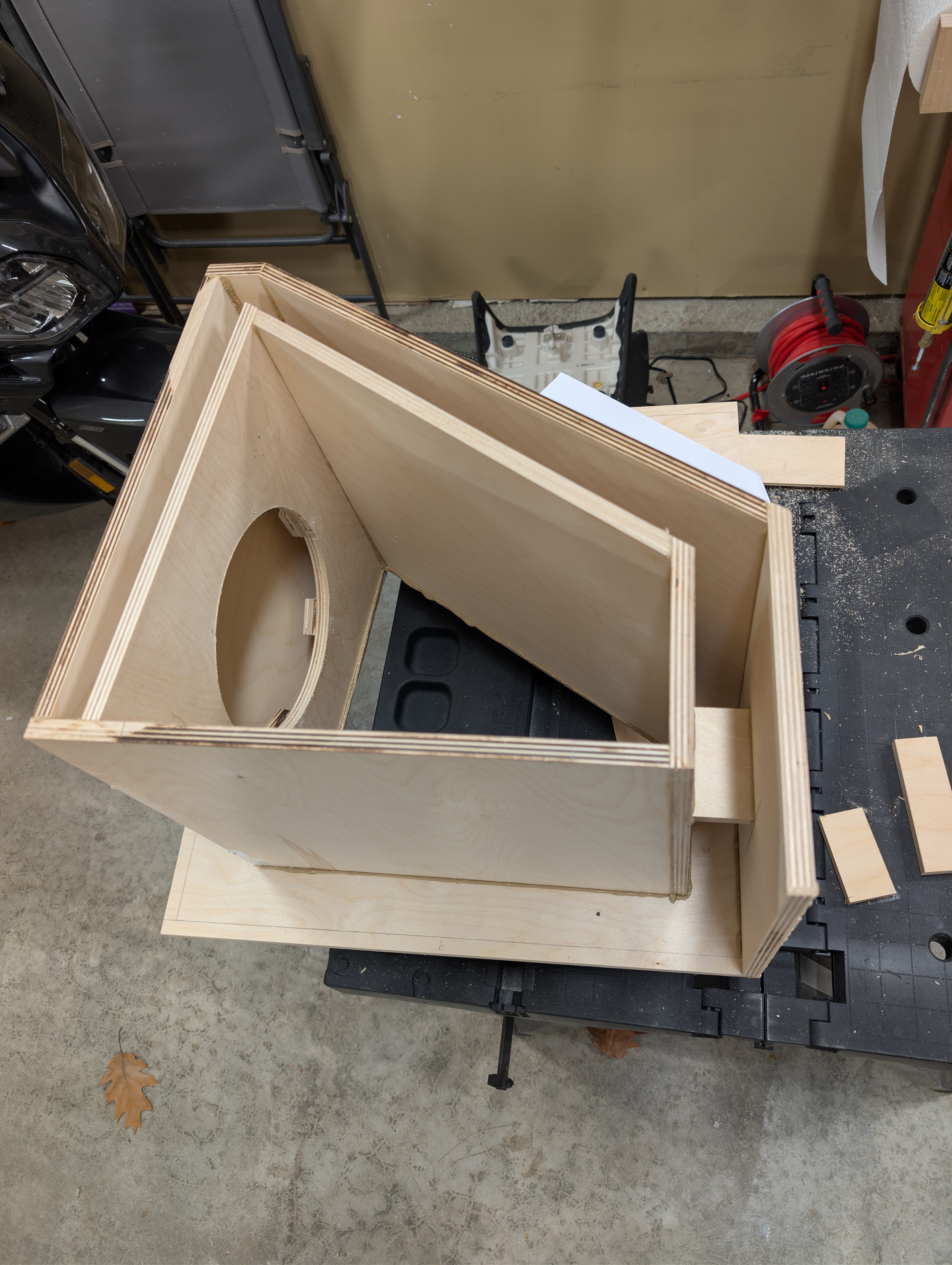

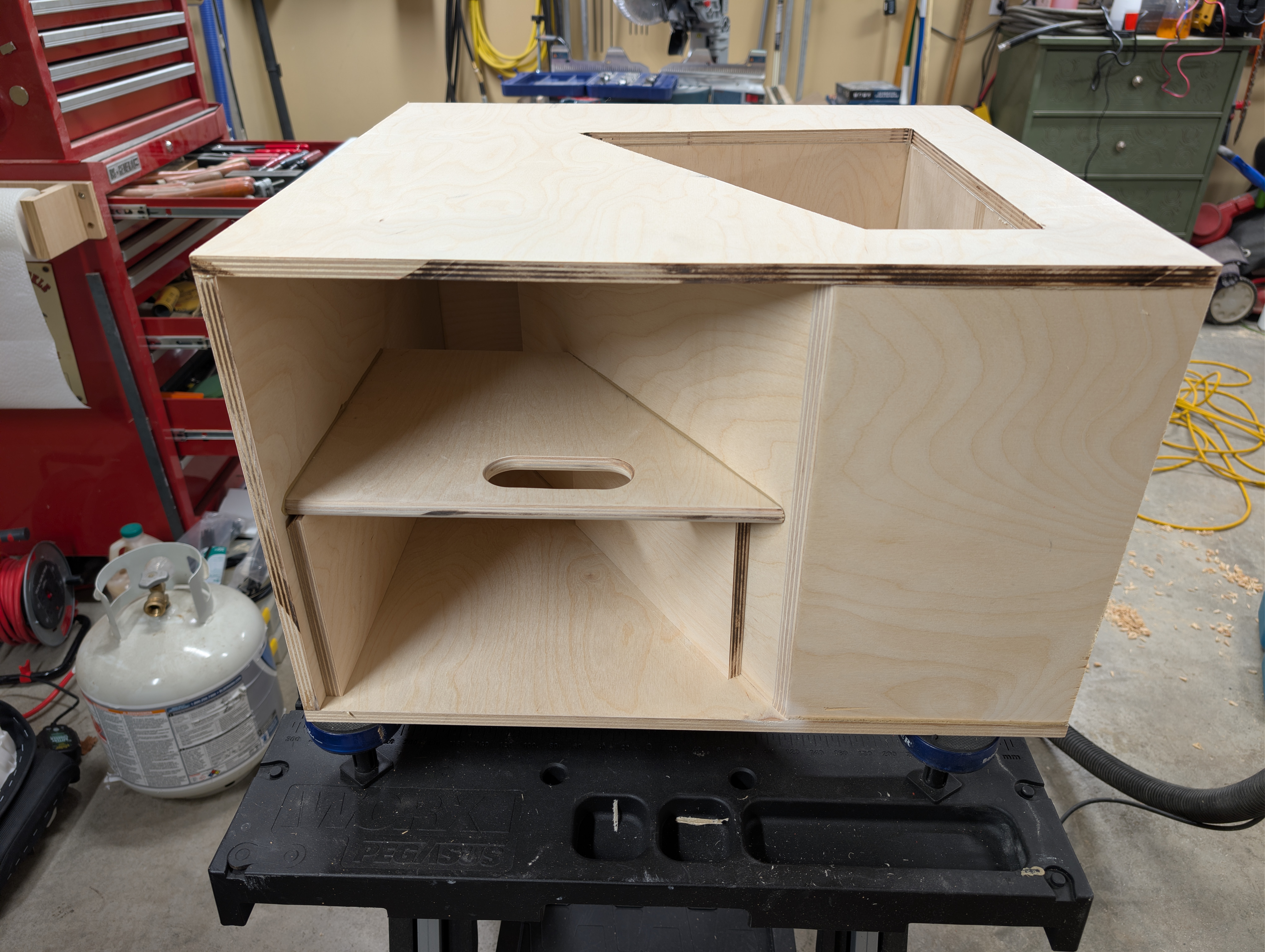

Got the mouth brace with handle cutout installed. Pieces under it in the image are jigs to keep it straight.

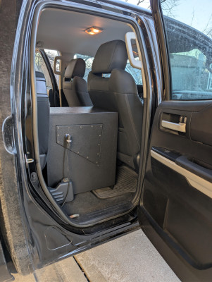

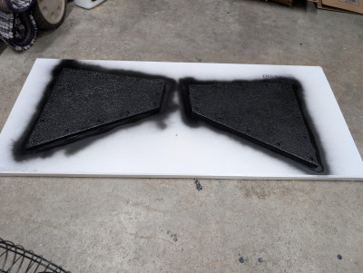

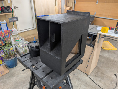

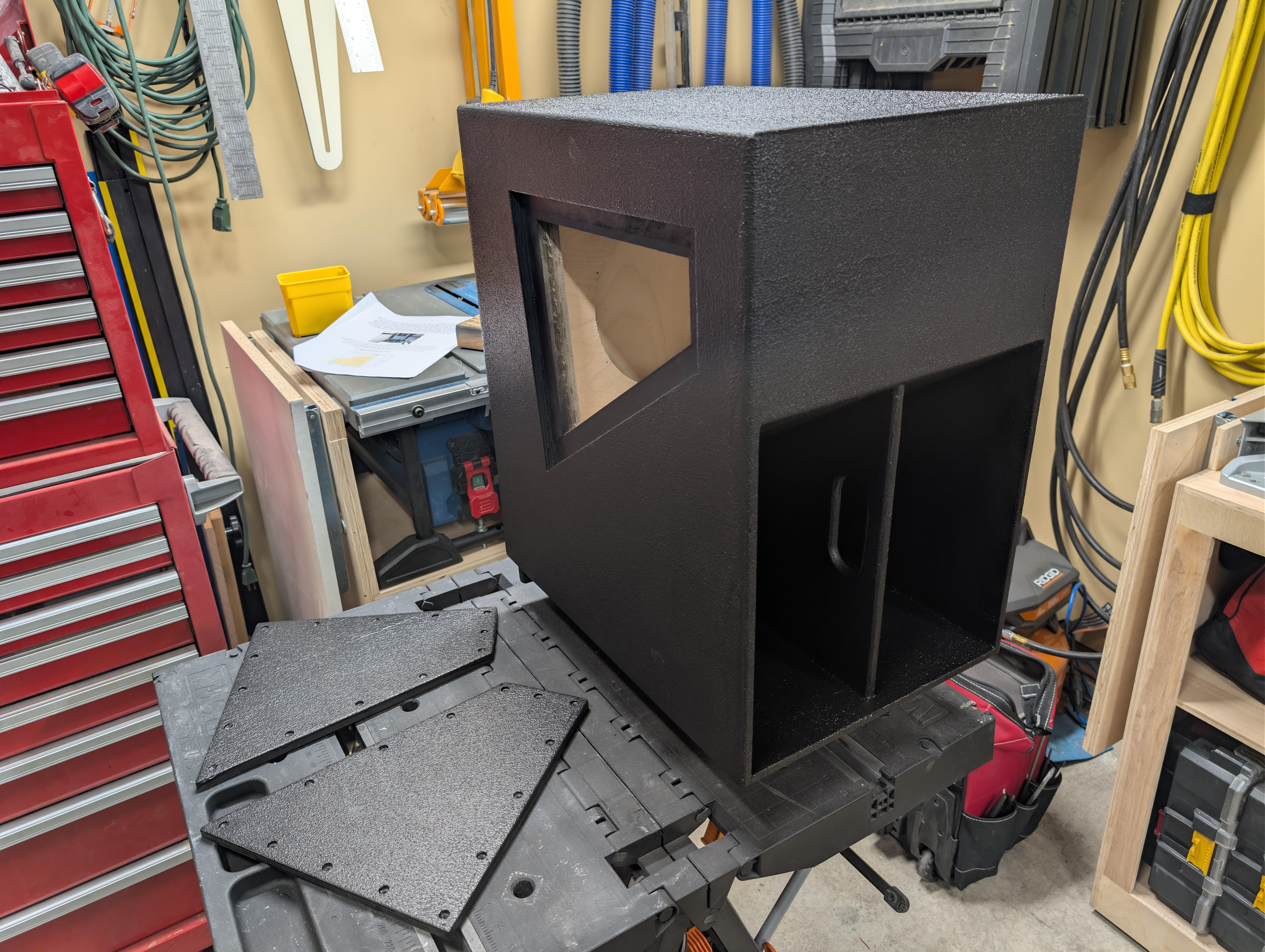

Driver chamber cover flanges installed. Got the cab all sanded and corners rounded. Also got the "foot" installed so the cab is level in the back of the truck. Decided to go with Duratex as the finish as it's tough and will match the black interior of the truck pretty well. Also way easier than trying to carpet it or wrap it in vinyl.

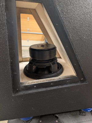

@Bill
I found what might be an error in the plans. On page 28, the driver cover image description says "Cover for inlaid mounting" but the dimensions in the image are too large for inlaid mounting. Perhaps the description there should be for "overlaid" mounting.

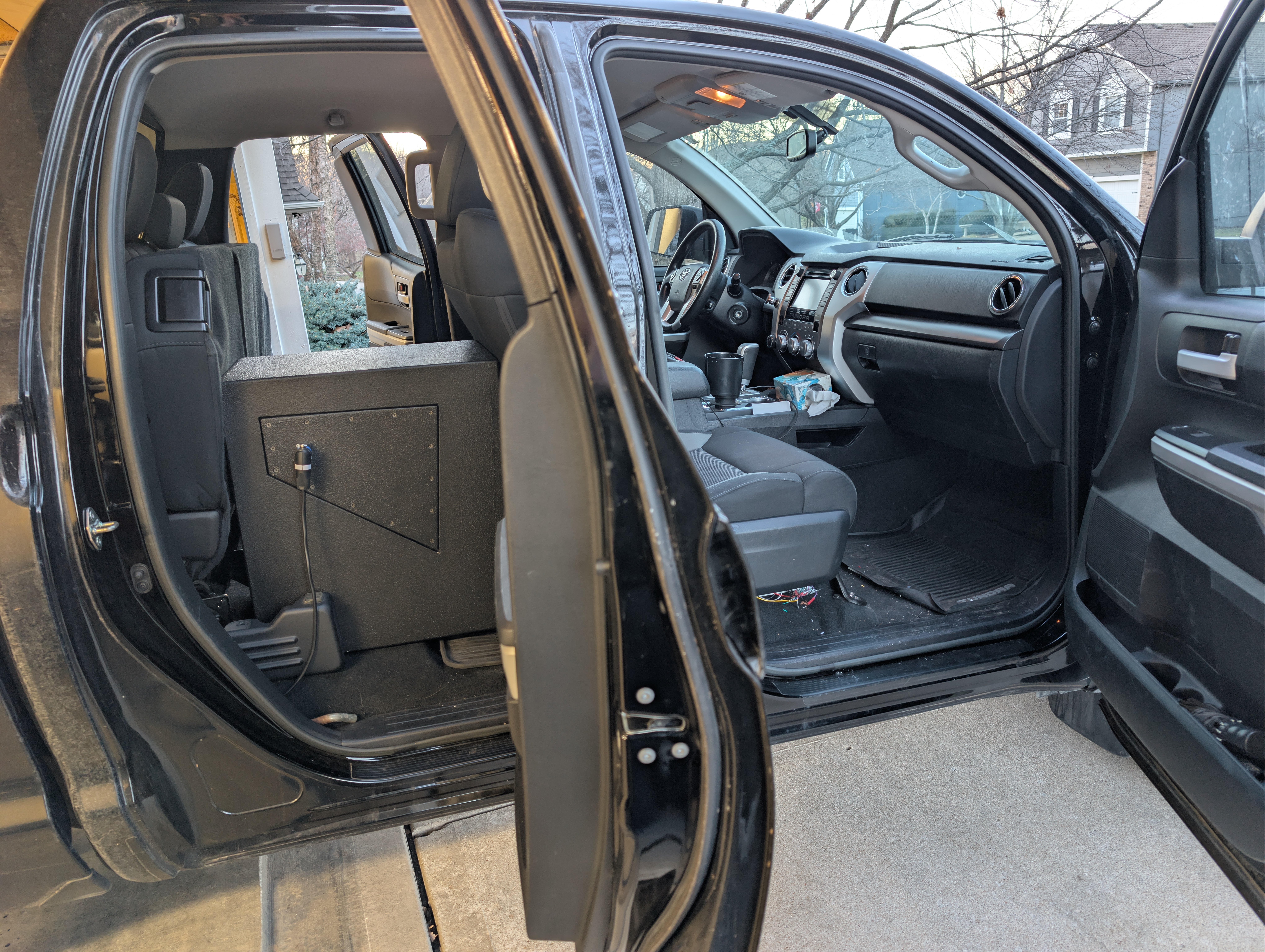

FIN
Got the DSP wired up to the factory system which was a PITA (yes I used aftermarket wiring harnesses so I'm not hacking apart the stock wiring harness. Learned that lesson a long time ago). The DSP allows for things like setting a HPF for the door speakers and LPF for the sub as well as built in EQ and such. Neat piece of kit.
I've got the initial dial in of the sub done. I'll definitely be tweaking it over time.
First impressions: this thing is utter madness! I've had an autotuba before but never in a truck. This thing kicks like no one's business. Definitely puts out more clean, clear, accurate sound than a single 8" woofer and probably 100 watts of power has any right to. That's a testament to the efficiency of Bill's designs!
