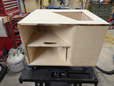

Good morrow everyone. Been working a few days on the TAT that will go into my double-cab Toyota Tundra. Will be 8" loaded and 14" wide OD.
On to the PITCHERS!
Look at all that beautiful squeeze out

MOAR PITCHERS
Currently letting panel 10 set up. Will hopefully get panel 11 in place today.
Semi-pro tip: using an infrared heater on medium low really helps the PL set up faster in cold weather. That's why you see the heater in a lot of the pics.

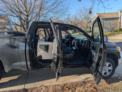

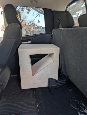

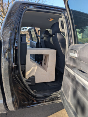

Got the second side attached. I was able to do a test fit in the truck and it fits perfectly between the seat rails!
@Bill (or anyone who would know): the ID width of this cab is 13" (14" OD). Is the mouth brace necessary for a cab this skinny? I'm rethinking the handle situation after test fitting it in the truck. If the brace is necessary (which I assume it is given that the plans don't say otherwise), then I'll make it work.
Posts: 29016
Re: TAT Build
#9 Post by Bill Fitzmaurice »
I go with no more than 6 or so inches of unbraced panel width. It may not be absolutely necessary, but I'd rather be safe than sorry.
shane2943
Posts: 273
Re: TAT Build
#10 Post by shane2943 »
Thank you sir. I will add the brace

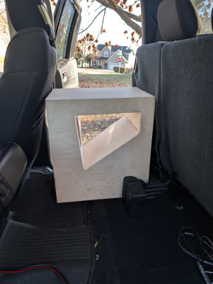

#11 Post by Rich4349 »
It LOOKS like the top, forward corner where it first interrupts the seat reclining angle could be trimmed down a bit, so long as the new angled throat dimension remains greater than the preceeding smaller throat area. (Titans have angled corner bracing there.) Trimming with commensurate polyurethane sealing could make your passengers' rides more comfortable.
shane2943
Posts: 273
Re: TAT Build
#12 Post by shane2943 »
Rich4349 wrote: Tue Dec 16, 2025 3:13 pm It LOOKS like the top, forward corner where it first interrupts the seat reclining angle could be trimmed down a bit, so long as the new angled throat dimension remains greater than the preceeding smaller throat area. (Titans have angled corner bracing there.) Trimming with commensurate polyurethane sealing could make your passengers' rides more comfortable.
Though about that and decided against it. The main person that rides in the passenger seat is my wife and she doesn't like to recline the seat. So I opted to just keep it "stock."

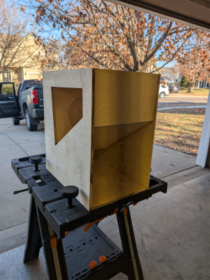

Got the mouth brace with handle cutout installed. Pieces under it in the image are jigs to keep it straight.
