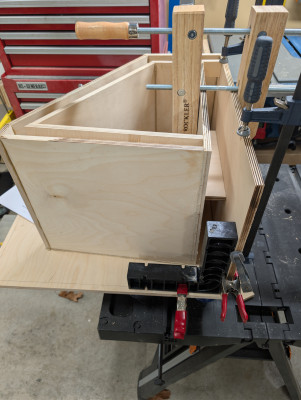

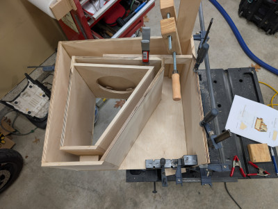

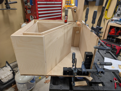

Good morrow everyone. Been working a few days on the TAT that will go into my double-cab Toyota Tundra. Will be 8" loaded and 14" wide OD.
On to the PITCHERS!
Look at all that beautiful squeeze out
TAT Build

MOAR PITCHERS

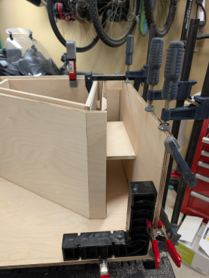

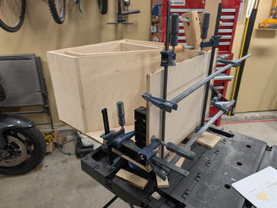

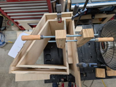

Currently letting panel 10 set up. Will hopefully get panel 11 in place today.
Semi-pro tip: using an infrared heater on medium low really helps the PL set up faster in cold weather. That's why you see the heater in a lot of the pics.

Re: TAT Build
Spritz it too, cold air is dry air.
Re: TAT Build
Ah, good tip. Thanks!

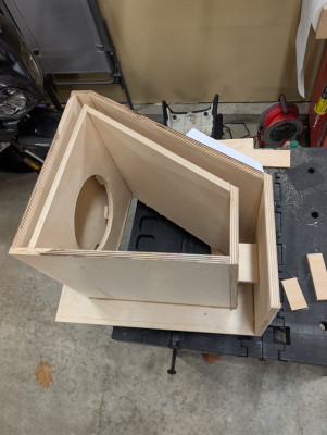

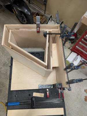

Panel 11 is now in place. Once it's set, I'll get the brace cut out. The brace is going to double as a brace and handle as I want the sub to be easily removable from the truck cab in case I need the space in the back seat.
Also, can NEVER have too many clamps!
