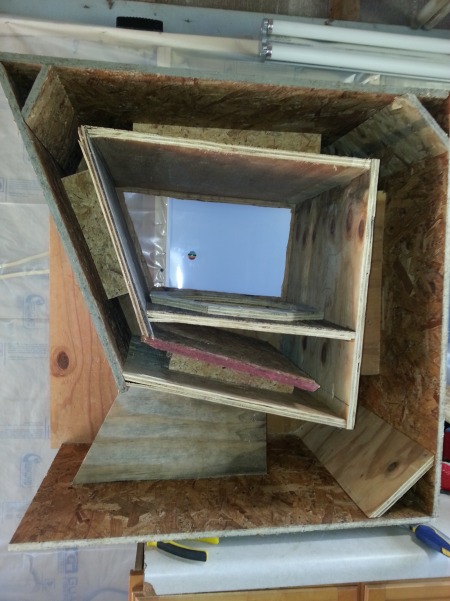

This build consist of wood glue, Asian Ply1/2, Asian Ply 3/4, and OSB 1/2. Cant wait to hear this baby :hyper: :hyper: :hyper: :hyper: :hyper: :hyper: :hyper:

OSB? :wall:

#3 Post by darklango »
Bill Fitzmaurice wrote:OSB? :wall:
:D :D
I wanted to practice b4 we did the real box. But I'm curious on how its sounds now
Re: Tuba 30 Build (I upgraded Bill plans) Thank me later Bil
#4 Post by miked »
I hear you on practicing before using the expensive wood. But don't expect this box to last long. OSB will delaminate quickly with the pressure the box will be under. PL probably filled all the gaps in the OSB, but the box won't last long if you move it much.
Hopefully you're building the real thing out of 1/2" Baltic Birch.
#5 Post by Ian Westwood »
miked wrote:PL probably filled all the gaps in the OSB
Not sure if it is my eyes, but I can't see much evidence of PL squeeze out... or any glue for that matter. Is this a dry fit / practice build?
#6 Post by sine143 »
The forst section in the horn also does not look quit right to me. Notice how as it goes around the bend the horn gets smaller. Id double check the measurments
#7 Post by Ian Westwood »
sine143 wrote:Notice how as it goes around the bend the horn gets smaller
I think that is correct... as far as I know the T30 is the only one like this. Not sure why, or what you would call the restriction in speaker building parlance?
#10 Post by Michael Ewald Hansen »
sine143 wrote:The forst section in the horn also does not look quit right to me. Notice how as it goes around the bend the horn gets smaller. Id double check the measurments
He built it correctly. The first part is supposed to be wider before the fold than after..
#11 Post by 88h88 »
If he hadn't said it was a test build I'd almost say this was the perfect troll build. Differing widths of cheap asian ply, OSB, WOOD GLUE... :lol:
#14 Post by Michael Ewald Hansen »
88h88 wrote:If he hadn't said it was a test build I'd almost say this was the perfect troll build. Differing widths of cheap asian ply, OSB, WOOD GLUE... :lol:
#15 Post by darklango »
A little wood glue, mostly dry fit
