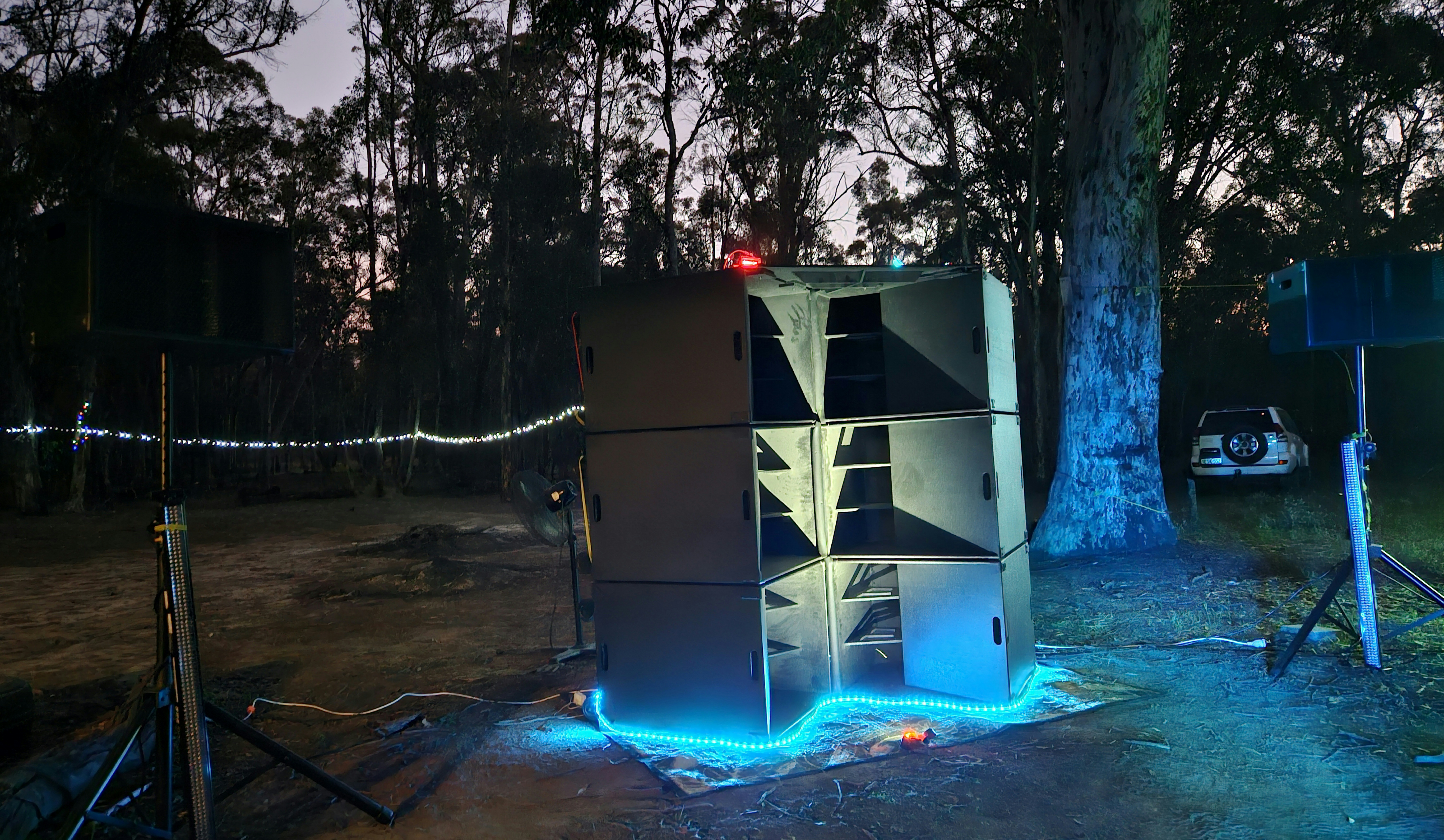

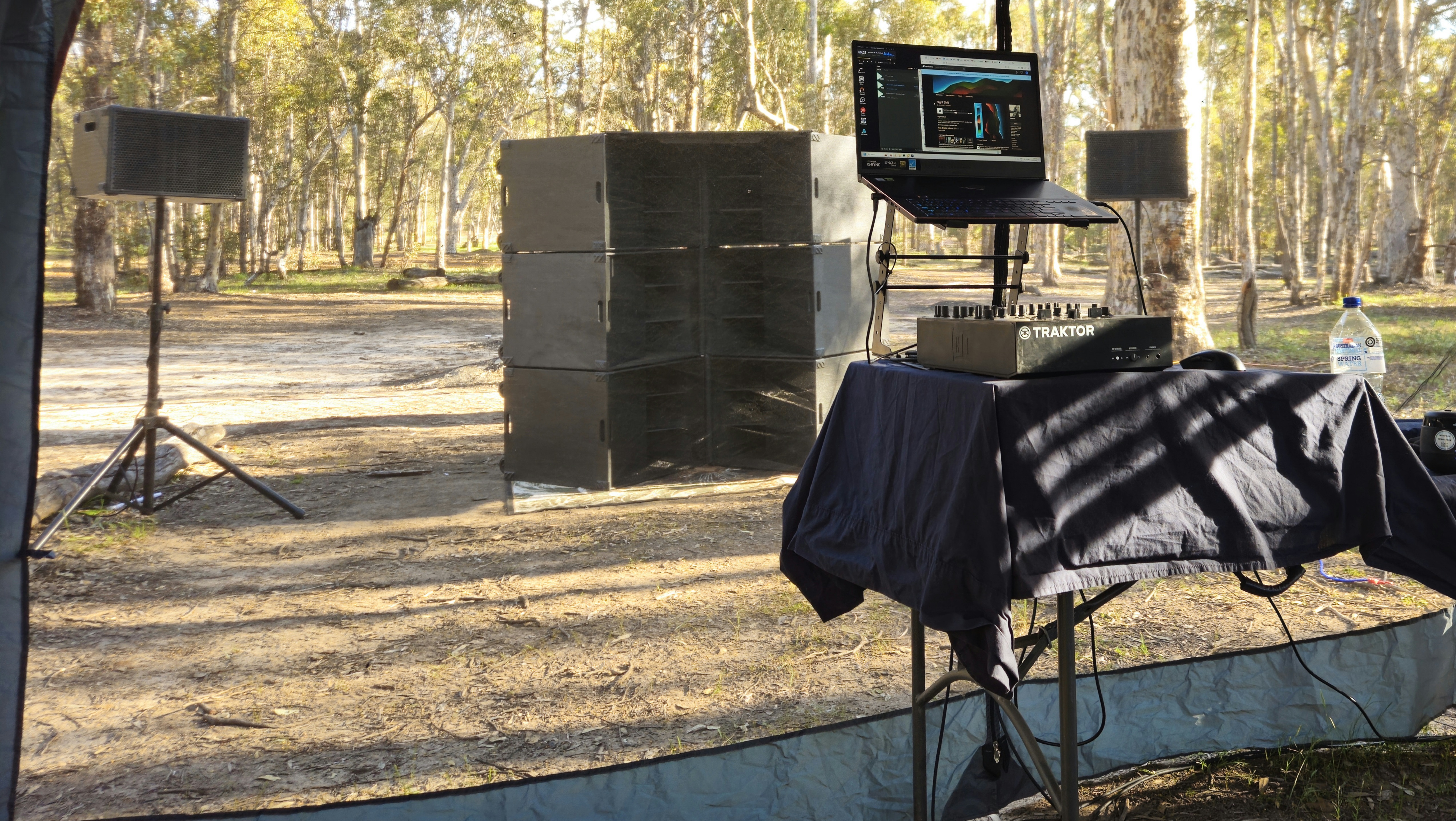

I mainly do outdoor gigs/private parties (that being said, got a semi indoor gig coming next week on a rooftop). Usually anywhere between 2 and 6 cabs, and usually V-plated (even with 6). V-plate is a very worthy addition outdoors, we usually try to seal the mating edges of the cabs with tube lagging as quite a lot of air pressure is lost there. Pic attached of a 6x setup outdoors.
I play 100% EDM spread between D&B, house, techno, breaks, and hiphop.
I'd say the blast zone coverage area of that setup outdoors is apprx 100m² so it's not massive, but its loud and low enough.

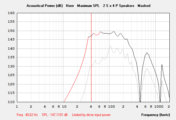

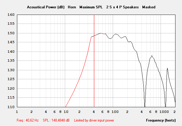

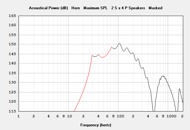

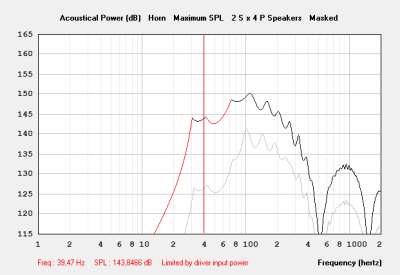

Soooo,
i think i figured at least the hornresp horn modeling part correct.
The following figures resulted:
Tuba30, external width 30", dual 12" Driver (applies to all)
Here the Stack of 4, V-Plated, Driver is the 3012LF, max SPL:
T30 30 dual 3012LF 4Stack maxSPL VPlate.png (10.67 KiB) Viewed 191 times
Here the Stack of 4, V-Plated, Driver the LaVoce, max SPL:
T30 30 dual LaVoce 4Stack maxSPL VPlate.png (9.97 KiB) Viewed 191 times
Here The T30 single vs stack of 4 without V-Plate, max SPL:
Titan 48, external width 30", dual12" loaded (applies to all)
Here the Stack of 4, V-Plated, LaVoce Driver, max SPL:
T48 30 dual LaVoce 4Stack maxSPL VPlate.png (10.64 KiB) Viewed 191 times
Here the T48 single vs. Stack of 4 without V-Plate, max SPL:
T48 30 dual LaVoce 4Stack vs single maxSPL.png (11.69 KiB) Viewed 191 times
So, first of all: if anyone feels there has to be an error, give it to me please.
Assuming this (more or less) is correct, it seems as the T30 really goes a bit lower, even in stacks of 4.
The difference between T30 4Stack and T48 4Stack is just around that 5db (Comparing 4 cabs to 4 cabs, so half the Volume of space from the Cabs)
Doing 8 T30 stacked V-Plated:
T30 30 dual LaVoce 8Stack maxSPL VPlate.png (10.79 KiB) Viewed 191 times
To compare the same Volume of cabs - we even surpassed the T48 limits. T48 brings a dent at around 80 Hz, from there on the T30 (double cab count, same volume) tops it out.
And the roll-off down below is smoother within the T30 stacks, no matter which variant.
The limiting point seems to be the Driver, not the cab itself.
So, to get to my questions from the beginning of ths trip:
- I don't think there is something the T48 would achieve i could not reproduce by just building more of the T30. The better upper range extincts within the same volume of cabs (there is doulbe the amount of drivers included)
- i need double the amount of drivers and amp power to achieve that with the T30, on the same power there is around 5 db difference but still the T30 plays lower
BUT the storage space needed still the half. The result of 8 T30 will blow me away anyway, even if the simulation is typically of by 2-3 db.
- The Hornextension doesn't seem to be in any sensible relation comparing the size of the horn to the result. I don't think i will follow that, maybe when i run out of ideas what to build next.
As the driver used limits the output situation, i will keep an eye open for other options that may fit (and will come back with the questions about them when they simulate better)
If anyone sees errors in there, please hint me on them i will try to fix that. Or any ideas which alternatives to simulate.

I think that red part of the trace indicates that, at that voltage, cone travel exceeds Xmax. Reduce the voltage until you get all solid black above the high pass frequency and that will be your max SPL plot... and maximum voltage.
Good job BTW. Thumbs up.

Also the black parts are limited by either excurson, voltage ore maximum power intake; but all driver related. Thats just how hornresp works, driving every frequency until there is a limit reached, when asking for max spl.
I'd also assume to take the lowest dent in a given area, and take that as a max spl you can drive that combination safely into.
For the t30 4stack plated i'd say its around 143db from 28 to 60, from there around 145db. This will be measured when built and eq'ed respectivly.
The t48 4stack plated would be around 147db from 35 to 70, and then probably quite flat upwards from there.
But all the curve does so far is showing the limits of the cab/driver combination.
I tend to go for the t30 so far tbh.
Also a bit more flexible, in terms of doing whatever small private events and picking just 4 of them; compact as hell when nothing more is needed.
and extendable as well, 2*stack of 4 or 2*stack of 6 or even 8 would be an option as well as just 4*stack of x cabs.
And lining them to an endfiring array would be an option too, sometimes helpful to have it somewhat more directive than just a ball in every direction.
