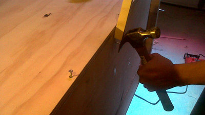

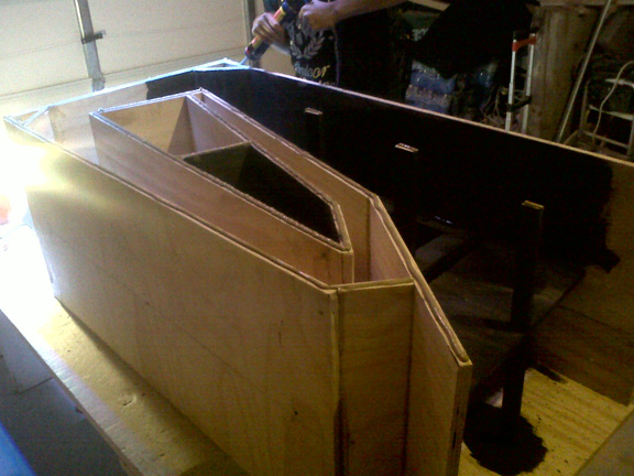

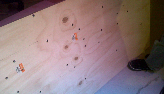

Transferring the number of screws per panel from the driver side panel to the cap panel.

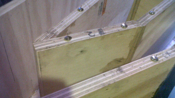

Spacing the screw hole markers (aka HD thumb tacks)
Aligning the cap with the tacks before using a rubber mallet to drive the  tacks in.

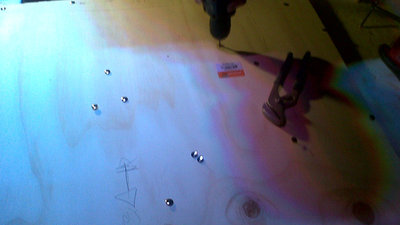

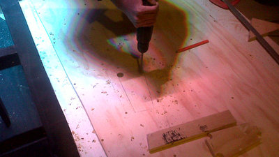

The inside of cap panel marked.
Drilling out to and counter sinking from the outside.

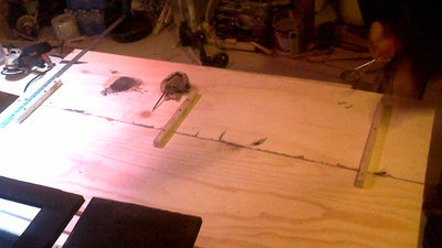

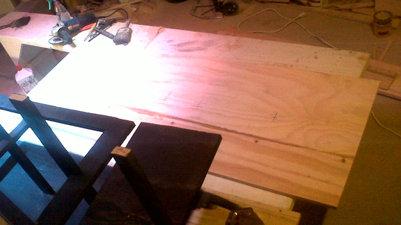

Sanding the panels more or less flat so the PL squeezes out uniformly.
Double checking.
Double checking.

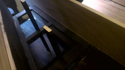

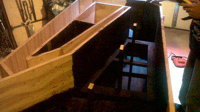

The cap side access to the Speakon connection.

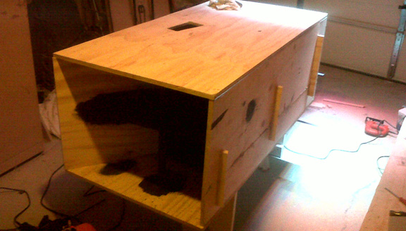

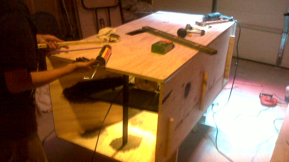

Bracing up panel 12 before cutting. Normally id leave this to cure another day but like I said were in a crunch.
Marking and drilling the holes for the braces.

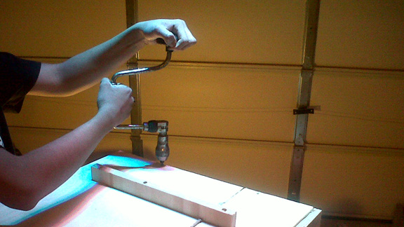

Grandpas ratcheting hand brace fitted with a screws bit. Its takes a while to get used to the added torque it gives you so but extra long screws for when you strip the wood.

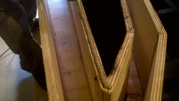

Nice even squeeze out of PL.

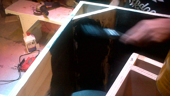

Panel 12 and Speakon access chamber staining.
We use ¾ a tube of PL when capping  “just because .”

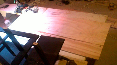

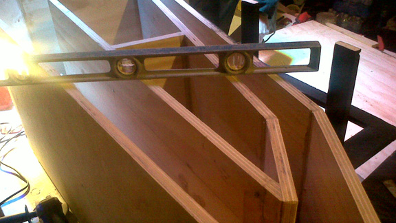

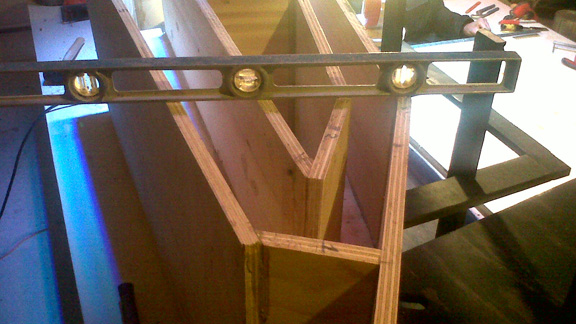

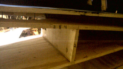

Using a screw to true panel 12 to the cap panel.

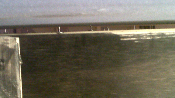

Using light and looking at all the joints for PL squeezage. Lol is it doesn’t, we filling with more PL.

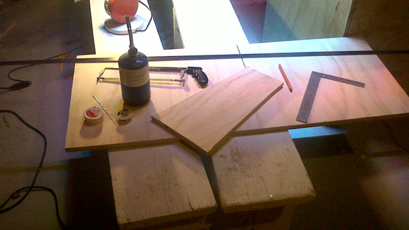

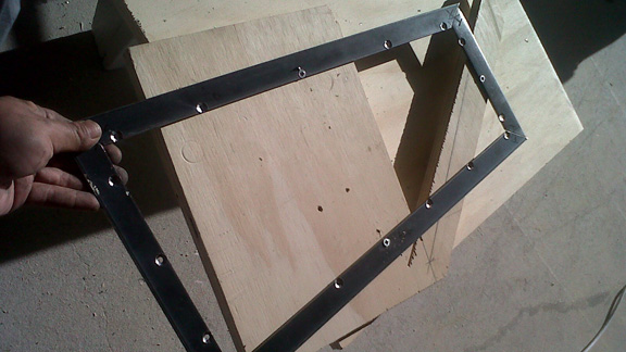

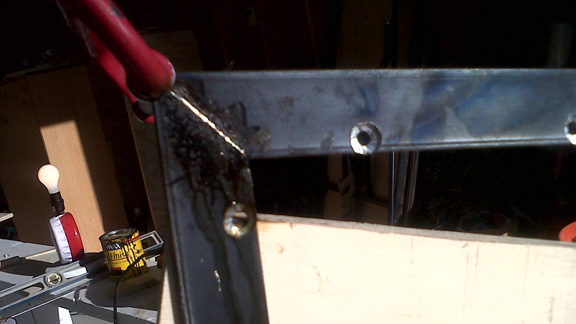

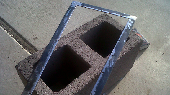

I took an silver smithing class in High school, I guess if your handy with welding then you can do this to, but is you can solder electronics you can solder 1x60 12 gauge metal bate from home depot.

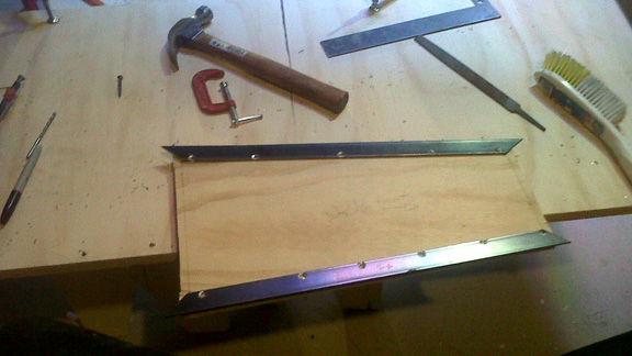

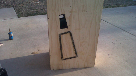

3/8 of the metal contacts the drive access panel and is sealed with pl so accuracy is the key.
Dry fitting the pieces before soldering
Wipe with flux, and heat until the flux boils and take the flame away and see if the solder runs up the joint, If it doesn’t then keep heating the bar.
Sanding the back side helps the PL bond a little more to the driver panel than a smooth surface.

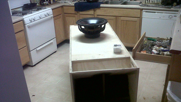

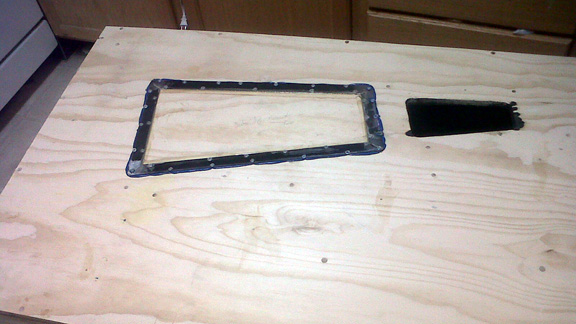

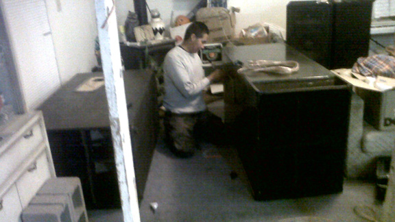

Test fitting the drive access panel to the Tuba.

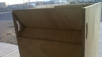

More smiling handle holes.

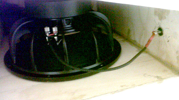

The Driver and Tuba meet for the first time and it’s love at first sight. Lol
Soldering the female connectors to the wire and tin the driver leads to save the wire.
Sealing the the driver chamber with Blue RTV silicone gasket maker, we use small strips of wax paper between the driver panel surface the driver panel access cover to make future access easier.

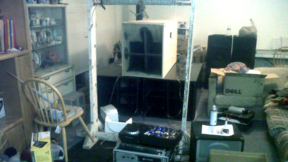

Prepping the previous tubas for their last sing before we ship out their Peavey lo Riders  for Lab 15s.
Using the tee configuration to test the tuba. One word WOW.  You tube video to follow shortly.
