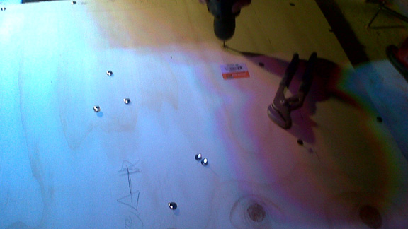

Transferring the number of screws per panel from the driver side panel to the cap panel.
Spacing the screw hole markers (aka HD thumb tacks)
Aligning the cap with the tacks before using a rubber mallet to drive the  tacks in.
The inside of cap panel marked.
Drilling out to and counter sinking from the outside.
