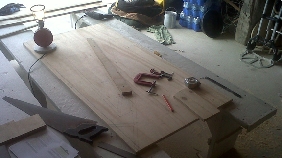

Ripped a 5x5 plywood to 2-60’x30’. (mind the saw kerf)  It’s just easier to find a square piece of plywood for the sides. I found a cabinet supplier that keeps odd sized plywood in stock and this prevents having two buy 3 sheets of 4”x8” .

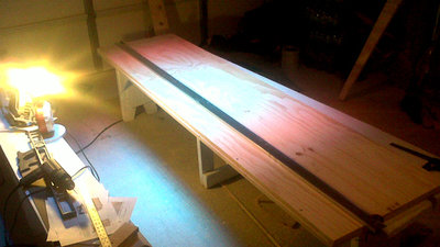

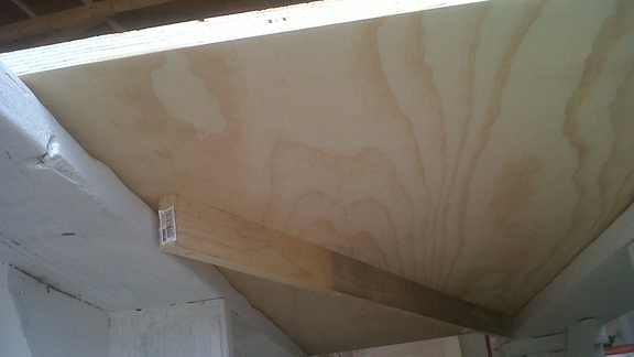

Warped sheets of plywood cause many problems further down the build you go. So we bought many 2’ broads that we a friend plane true on the long edges. These are used for the joining jigs and in this case truing the driver side panel. Always remembering to plug the screw holes after the broad is no longer needed.

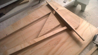

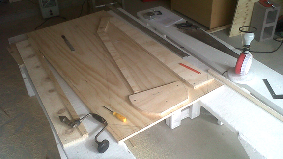

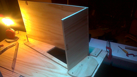

The braces cause many headaches. We found its easier to cut the brace using the drawn horn path before processing on. These are the also the straighten jigs for the first few panels.
Braces are screwed directly to the driver panel.

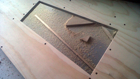

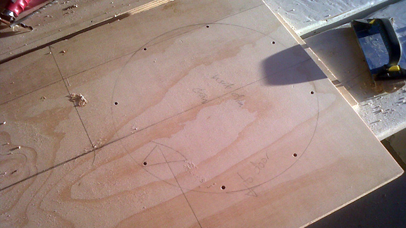

Using a guide screwed to the braces to help plunge cut the driver panel. We use a 90 degree angle because we use a metal flange to seal the driver chamber.

Finished driver panel cut out.

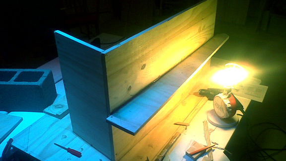

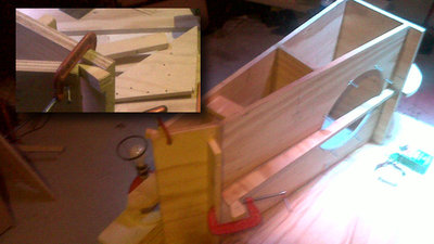

Here we are using the braces as joining jigs. Drill out as extra large hole in the panels to be joined to joining jigs. (Allows for movement in joining pieces) PL the outline on the driver side, Then screw the panel to the joining jig tight to straighten. Then screw panel to driver side. When attaching an adjoining panel first drill one hole extra large. (the previous panel becomes the other half of the straightening jig). Then screw that panel to previous panels using the larger screw hole. Then screw new panel to the driver panel and screw the new panel to the previous panel. ( take the measurements from the driver panel outlines to help true the new panel)

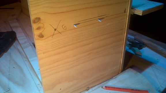

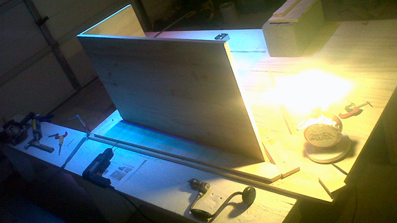

Panel 2 brace holes and a marked guide hole with a G. Brace can’t go in until after the driver panel is installed.
We made sure to Scribe all important measurements up the panels.

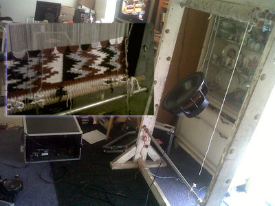

My cousin delivered the Lab 15 at noon and we quickly set about breaking it in. 20Hz sine and the amp turned halfway up with the driver coat hung on my Loom.

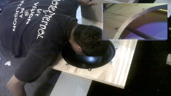

Wait until you have the driver before going past panel 3. You need it for a 360 degree all around satisfactory fit. We Drill the t nut holes with the diver centered on the driver cutout then returned it back for break in. Per BillF place drive hole “off axis”

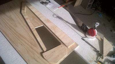

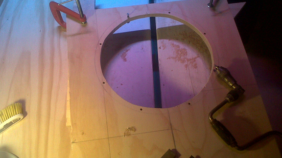

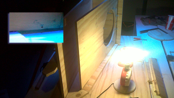

This is after using a using a jig saw to cut a comfortable sealing surface for the driver gasket with ample room for driver excursion.

Here is the oversized guide hole on the drive panel for the straighten jig/braces. Screw home tight then, perfect fit!!

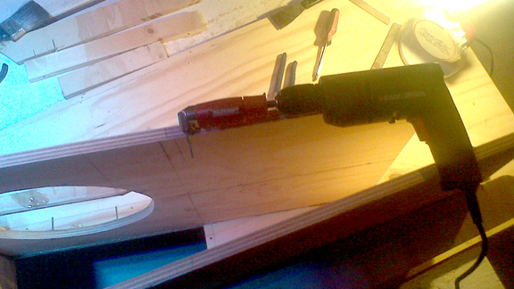

Milescraft 90 degree dill attachment for screw bits and 1 ½ inch long drill bit. Heaven sent for use in tight spaces. Lol
We made sure to Scribe all important measurements up the driver chamber panel.

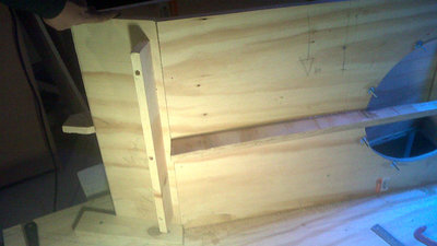

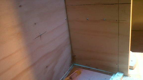

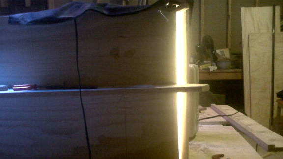

Straighten braces is use. With the next tuba there’s going to be a sacrificial straighten board on the inside of the driver panel. There was ¼ of an inch bow in the center of all the panels.

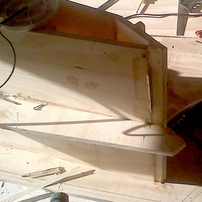

The horror realized.  Panel 4 did not join panel 1 right. *We faced this situation before and instead of rushing to force the panels to fit, we tried using some logic. Panel 3-4 fit perfectly, so we checked the edge of panel 1, and disasters the edge was off by ½ inch on the outside. So to save the alignment of the panel 3-4 joint we slimed the extra ½ inch gap and clamped down. We used spacers to maintain the space between panel 1 and 3 until the PL sets. And tomorrow we deal with the offending gap. The first, the most important is where it went wrong. Next time circular saw jigs from the start we were so close.

Woke up late this morning And It was very cold. Today was slow going as most of it was spent on fixing the mistake of the previous night. Mistakes when carefully dealt with can be eliminated and time will repair your ego. :wall:
The PL wasn’t setting from the night before so a space heater and a lamp provided a heat source until outside warmed up.

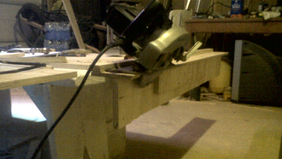

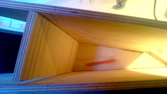

The mistake wakens. To fix this I needed to create a wedge with a 56 degree and 90 degree angle that went from a point to ½ inch wide over 24 inches. Impossible? Naw It just take time to create another jig.

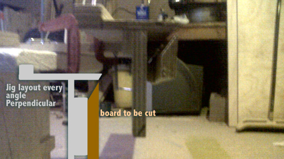

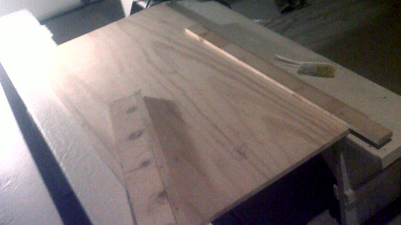

This was the easiest way I could get the 56 degree angle. It puts the circular saw on the edge of the plywood and that inverts the angles on the saw. So setting the saw to 34 degree creates a 56 degree angle. This jig is not for the faint of heart very dangerous. I use screws so there no chance to anything falling during the cutting.
This jig has to be perfect, and if you don’t have a planner/joiner hire a carpenter to make it.
The wedge PL-ed into place with the extras to be sanded down after everything sets.
