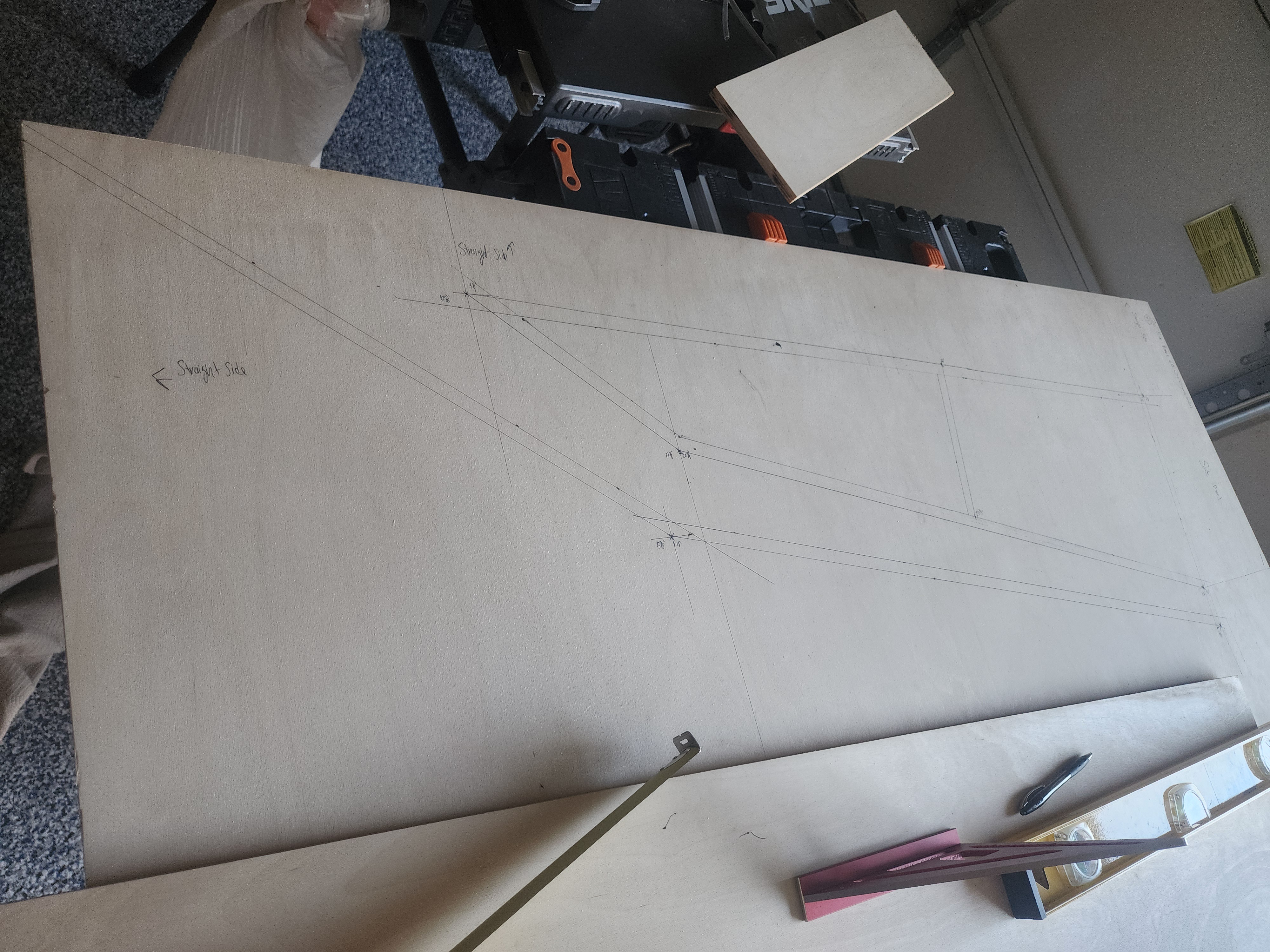

Was able to get through layout four. The plans are 100% spot on slowly chip away and take your time. Frustration causes you to make mistakes.
Speed squares a godsend to try and get lines straight and or Square.
Hoping to get layout diagram five complete tomorrow and that would complete all the layout.

I finished the panel drawings today triple check them they're all within 1/8 inch I would say.
I stacked the two panels together and my other panel ( which doesn't have the drawing I'm going to be drilling through) is about a quarter inch larger. I'm hoping this is not a major issue, that I can just trim off whatever excess whenever I glue panels together at the end
