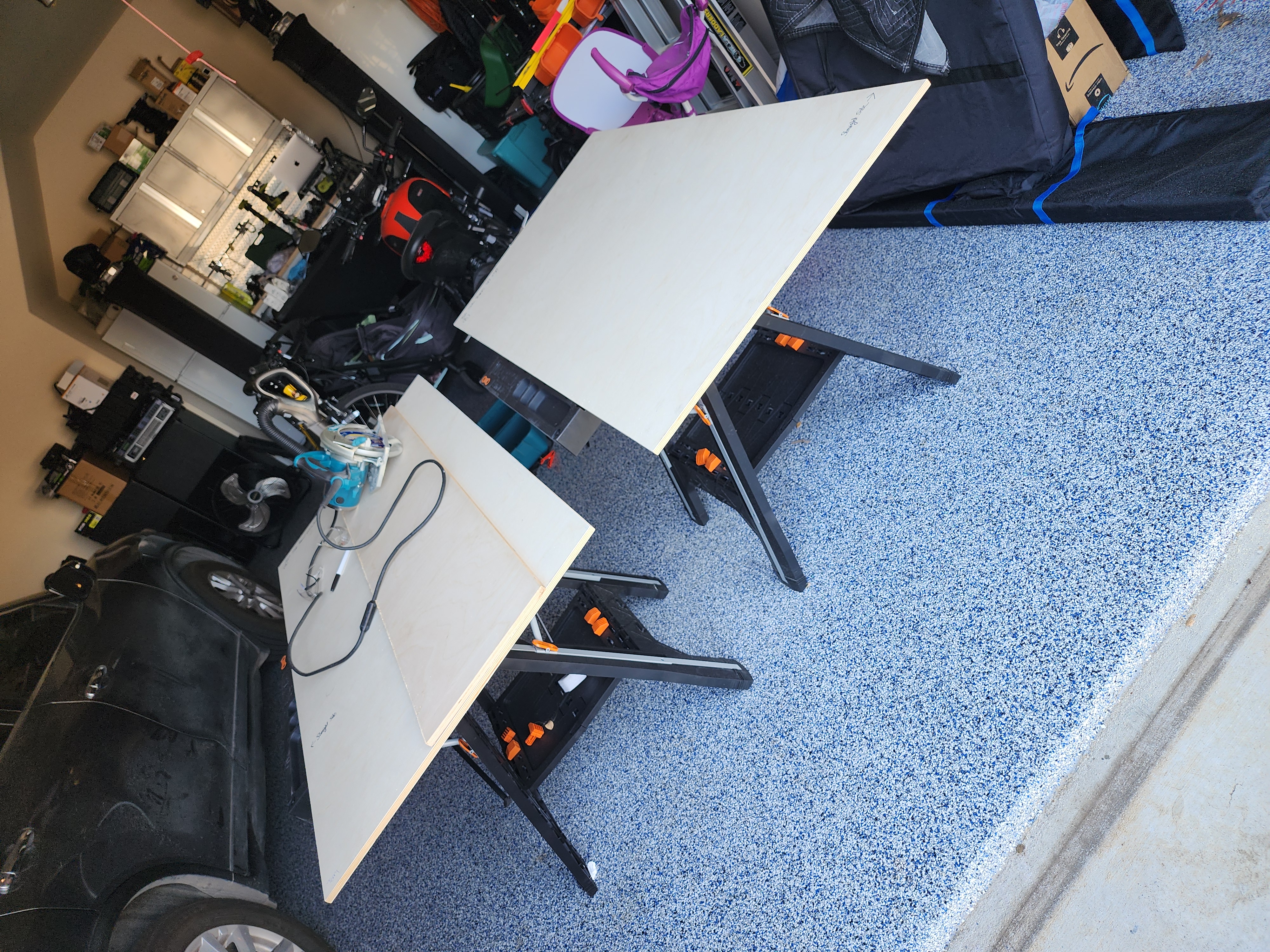

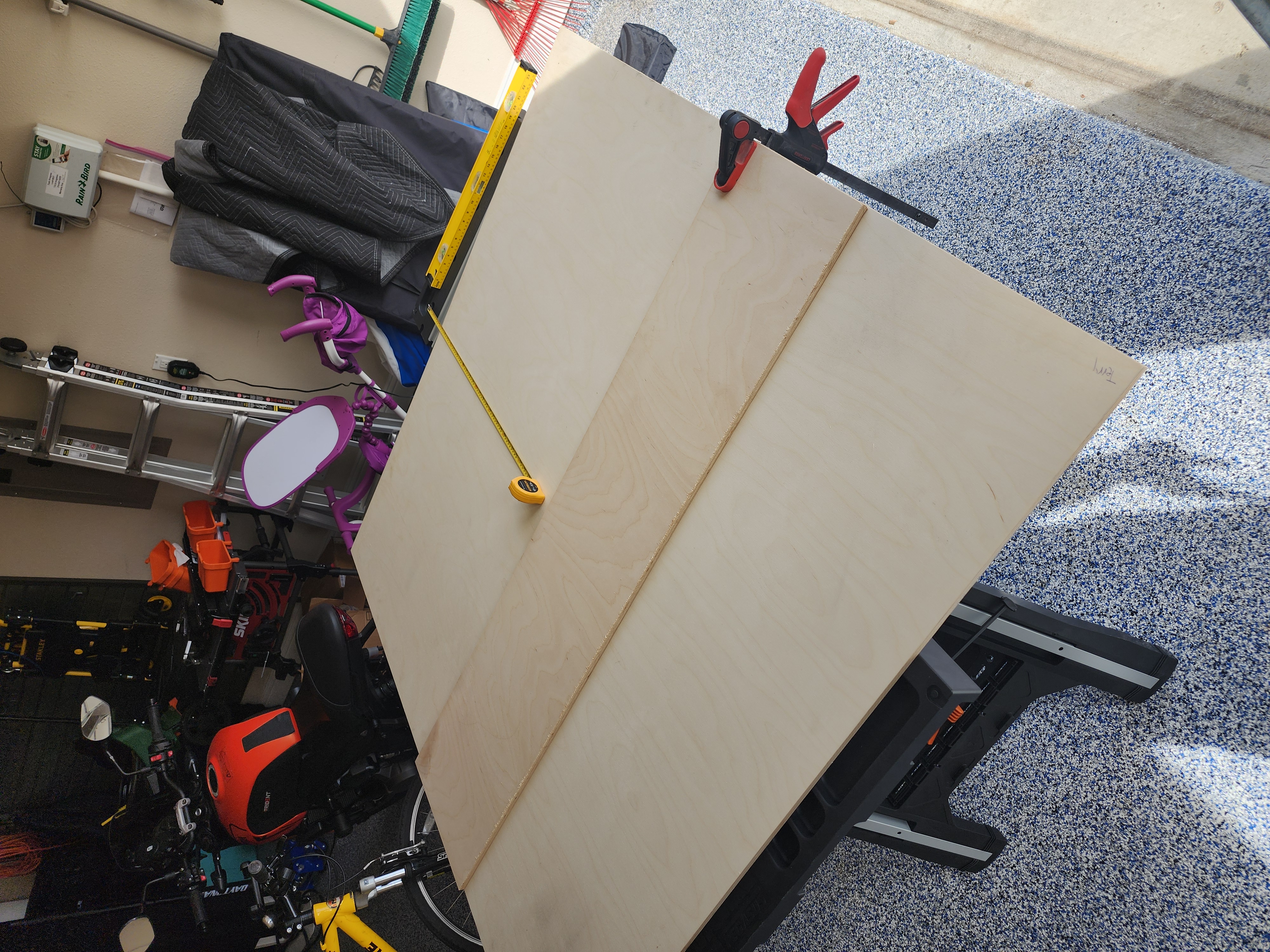

Few days ago I ripped the 5' sheets in half for the side panels first, using a table saw. They're a bit off by maybe 1/8 to 1/4 of an inch. That an issue? I assume when build is done, I can use a router to flush the edges, alongside sand?

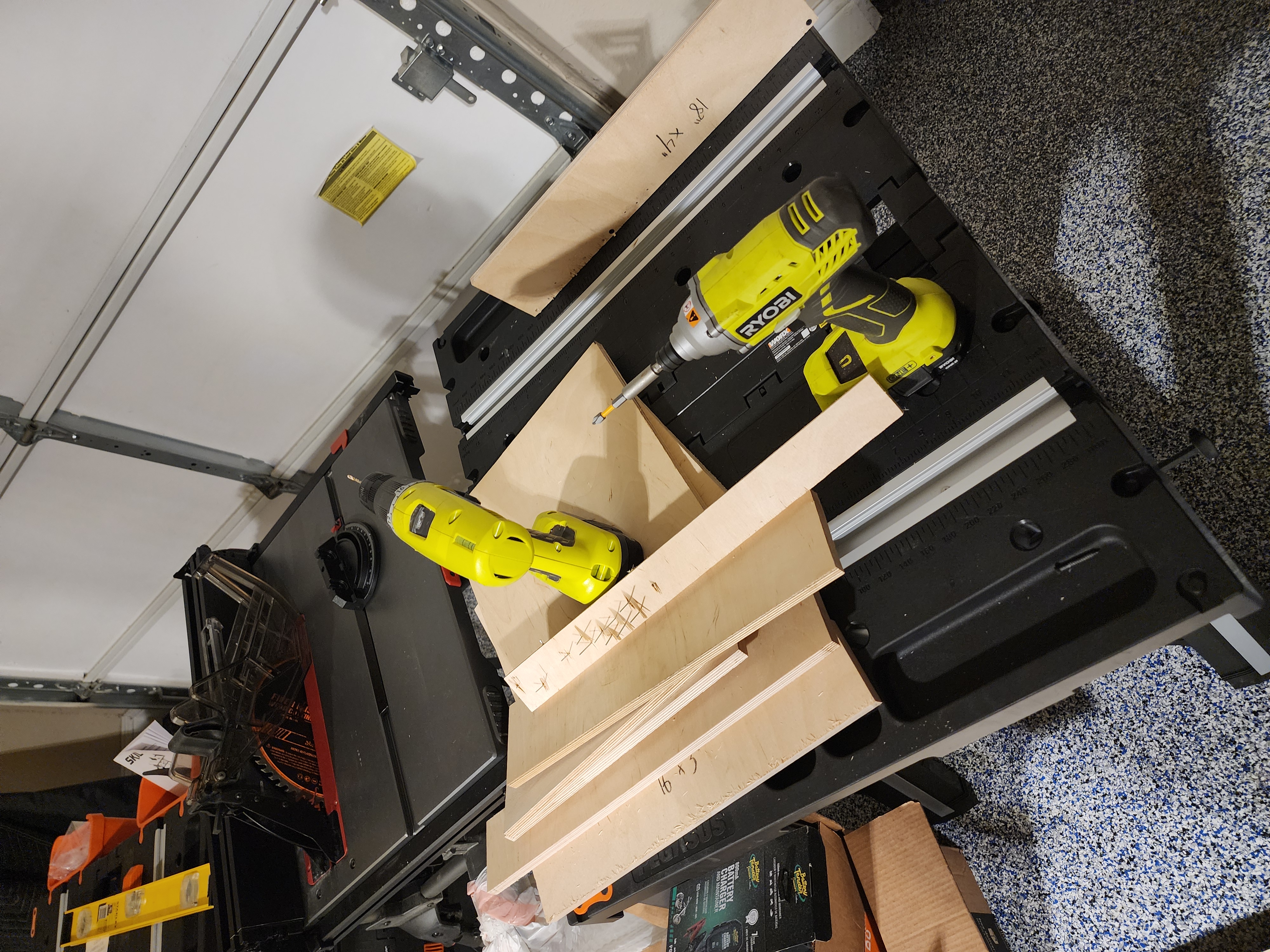

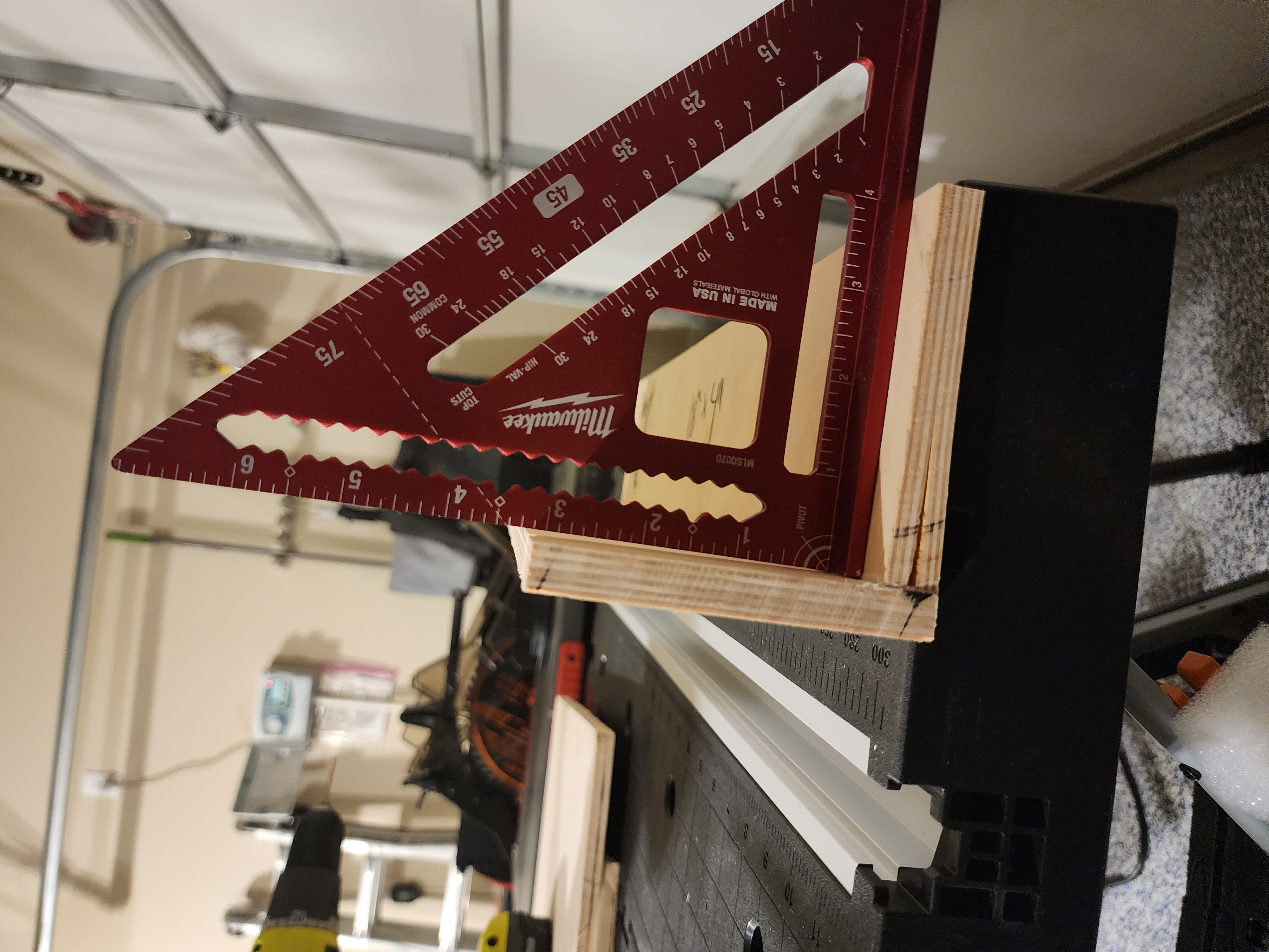

Today I practiced making some of the right angle jigs. Struggled alot on my first one. The plywood splitting due to no pilot hole/not perpendicular. Then switched to brad nails, there is a technique so you don't blow through the wood..shoot it parallel to the bottom piece. Videos and practice got me better at it. It;s close to 90 degrees..may be off by a degree or 2..I hope thats not a deal breaker.

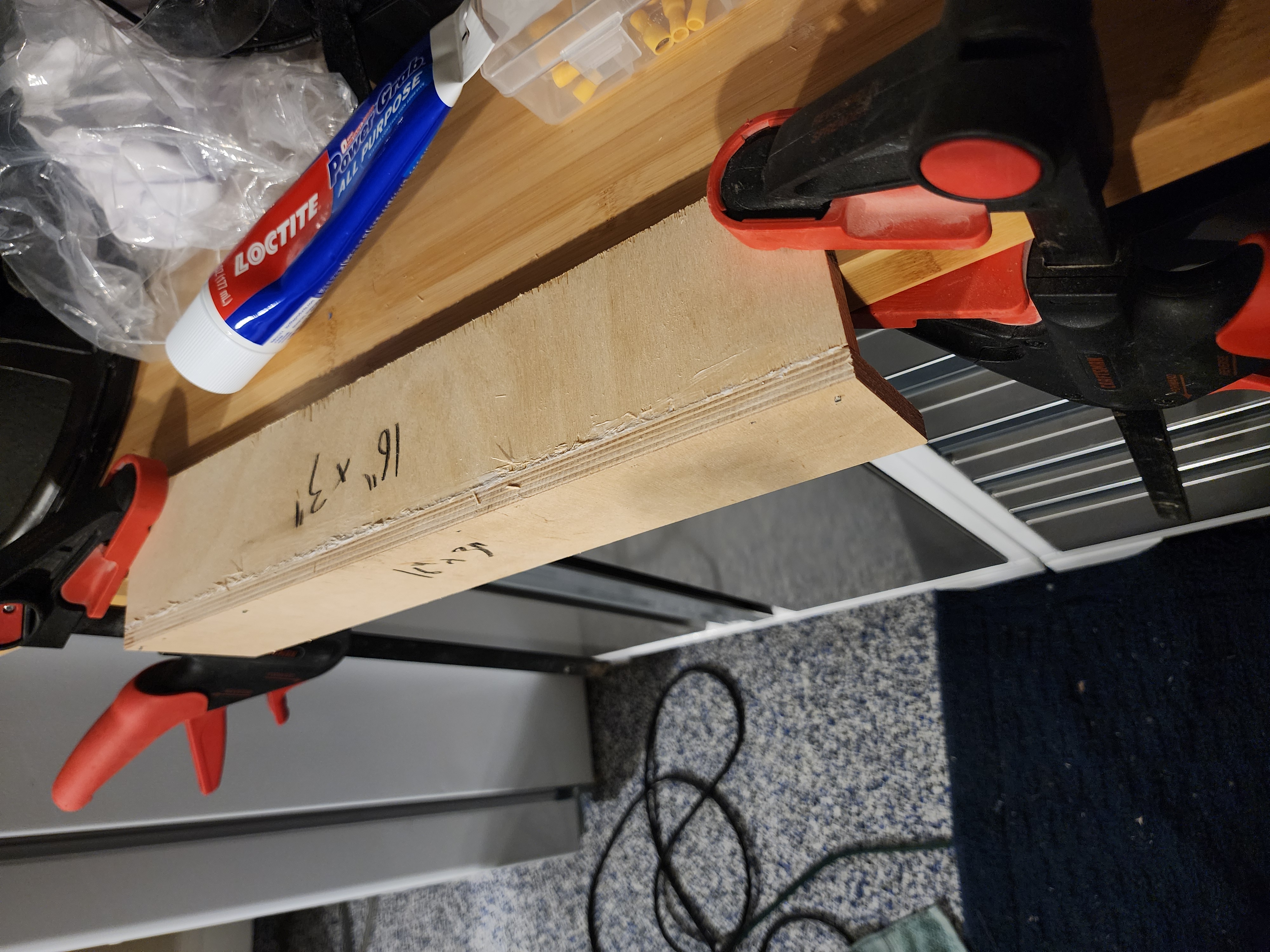

In one of the pics you will see I used "Loctite PowerGrab All Purpose". I do NOT plan on using this for the actual panels (I have the Loctite PL Premium). I just didn't want to open the loctite PL premium for such few pieces today..close it..and then opening in a week only to find it dried up. Any advise on storing loctite PL is appreciated!

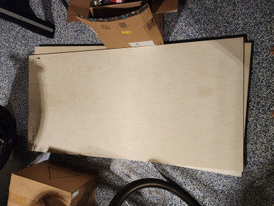

I will make a total of 3-4 right angle jigs..then move to cutting the 20" wide panels..then start my drawings. I need to square up my table saw..some of the measurements are 1/4" off. Hopefully next update by end of this week...

Looks like a good start! It's ok for the side panels to be a bit oversize if you have a flush trim bit, but it's a good idea to make sure your first panel that you draw the layout lines on is as close to perfect as possible or at least be aware of the discrepancy so you can compensate when drawing the lines. 1/4" short could be an issue depending on the panel in question. 1/8" here and 1/4" there start to compound off of one another and can make things difficult, so I'd recommend getting your table saw dialed in before you go too much further. The PL expands to fill small gaps, so don't worry too much, but do your best to get accurate cuts and keep everything square.
PL keeps for a pretty long time; at least a month or more after opening. I put a nail or screw in the end to keep it from oozing out.

Buy disposable gloves and wear them when working with PL. To store my PL between uses, I put a finger of one of the gloves over the tip and use masking tape around the tapered portion of the applicator tip to create a fairly air tight seal that's easily removed, replaced, and stays put between uses. Works fairly well for me. Won't keep it forever, but I've been able to pick it up and use it a month or so after it's previous use. It cures with the moisture in the air, so basically anything that will keep the tip sealed should work. I intentionally use masking tape because it doesn't stretch and basically creates a tapered casting of the applicator tip. Although, something like electrical tape, applied without too much stretch, but just enough... might create a little snugger fit and seal. Maybe I'll test it on my next tube.
