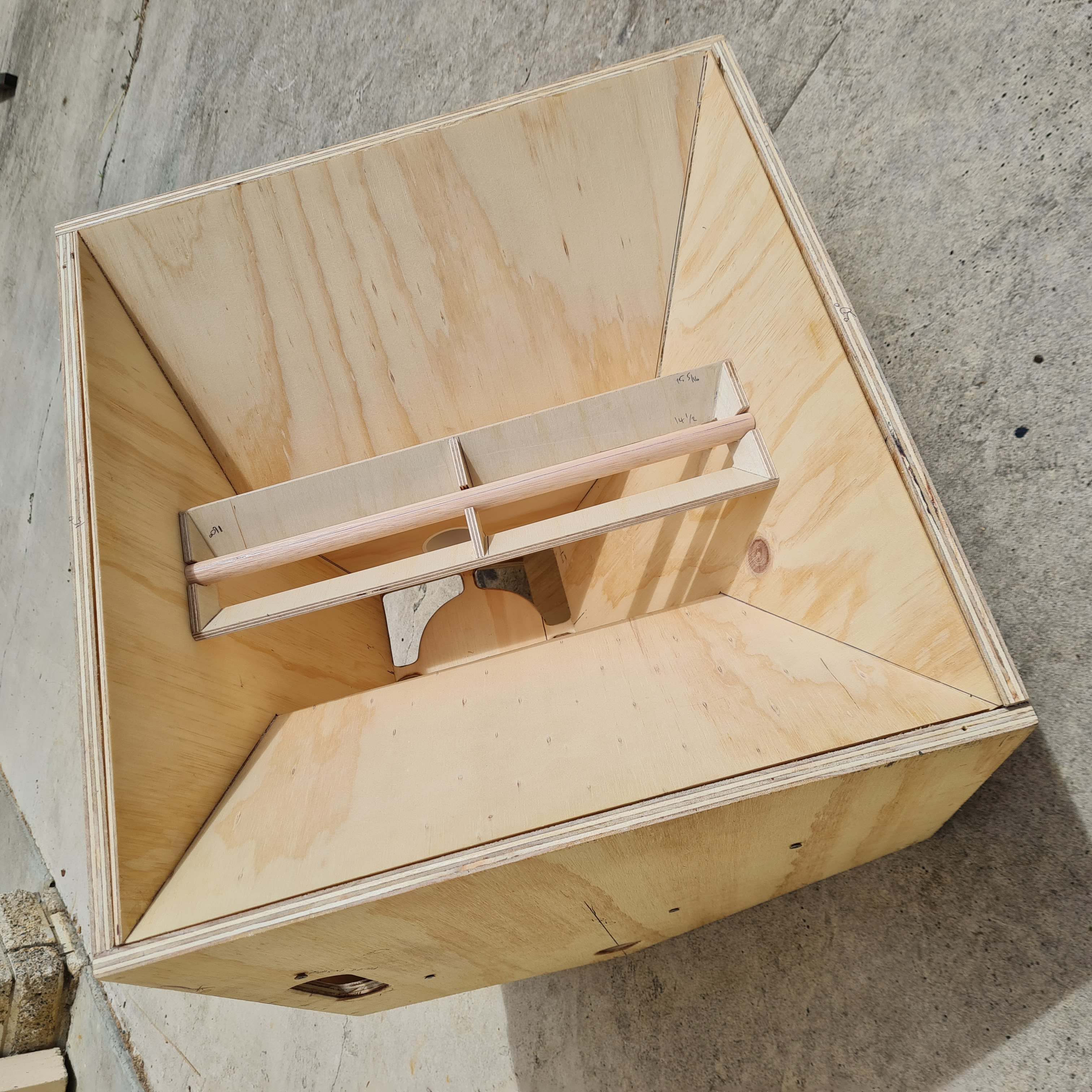

Checking in before l marry the horn to the flare & continue on with the shell, are you seeing any problems?
Posts: 29105
Re: WH10 CD vs Peizo
#9 Post by Bill Fitzmaurice »
Looks good, if there's enough clearance to fit the HF driver.

Keryn O'Shea wrote: Sat Feb 28, 2026 11:22 pm Checking in before l marry the horn to the flare & continue on with the shell, are you seeing any problems?
I applaud you taking on WH10s. I built three of them many years ago - not an easy build with all of the combination miters.
Looks good.

Bill Fitzmaurice wrote: Sun Mar 01, 2026 8:01 am Looks good, if there's enough clearance to fit the HF driver.
Ok great, yes there's plenty, using an ASD1001B equivalent. Thank you
Bruce Weldy wrote: Sun Mar 01, 2026 9:09 am I applaud you taking on WH10s. I built three of them many years ago - not an easy build with all of the combination miters.
Looks good.
Thanks Bruce, yes l read your post on cutting the miter angles with a table saw, that'll definitely help others.
I'm using a track saw which l think makes those cuts easier.

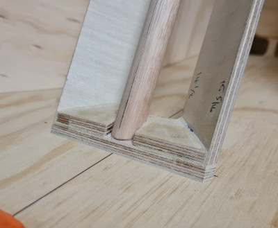

The lower diffuser bracket has been the most challenging peice of this build so far, the only dimension which hasn't changed is the 1.5" side where it meets the horn, its been stretched & has opposing angles & taken a couple of attempts to get right. In assembly l've added a degree or two so it's not resting flat on the cabs horn mouth. I want the diffuser brackets to sit square so there's zero tension when screwed down at fitting.
A second laminated peice added & I'll use the mitre saw to correct the angle instead of removing material on the single peice & weakening the bracket.
I may build the next CD horn in the mouth of the cab if l can find a way of holding the mouth reflectors in place while the adhesive sets, or just add a laminated peice from the start.
