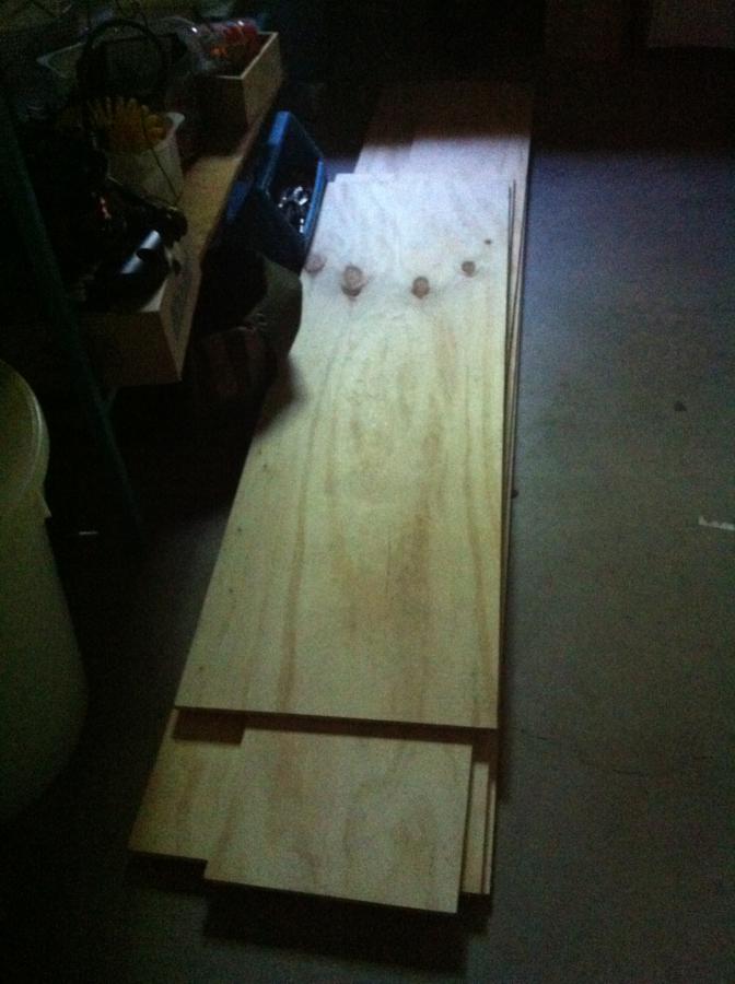

panels ripped to size

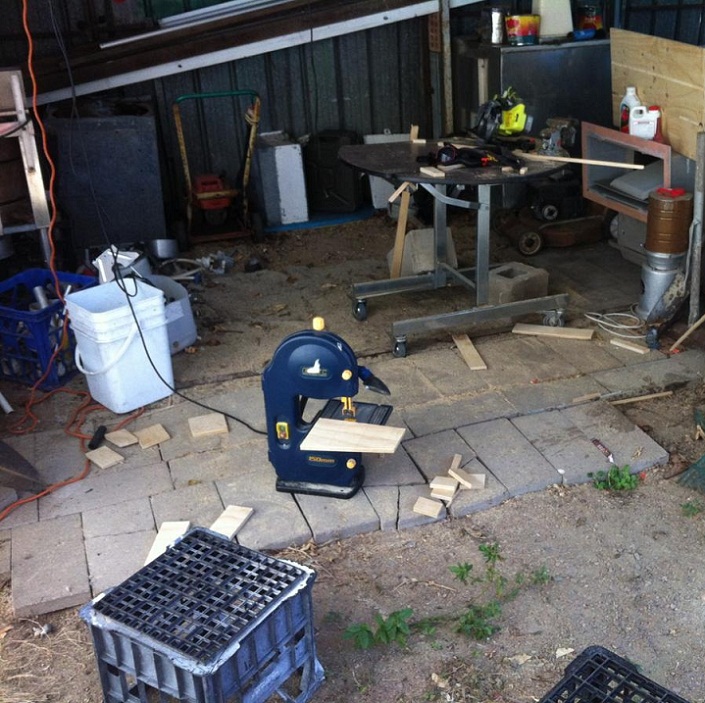

the 'workshop' where I ripped up the panels

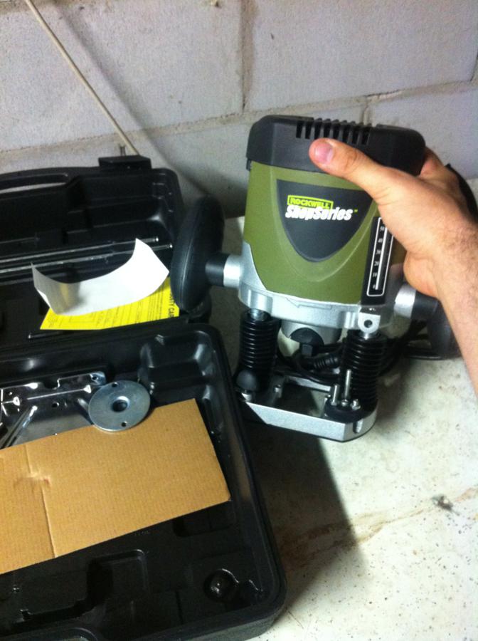

bought some new tools for this project, my first circular saw and router :) my previous build (autotuba) was done only using a $20 jigsaw and it was not much fun.

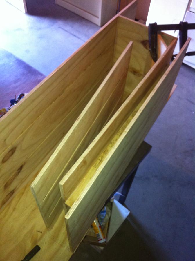

some more pictures

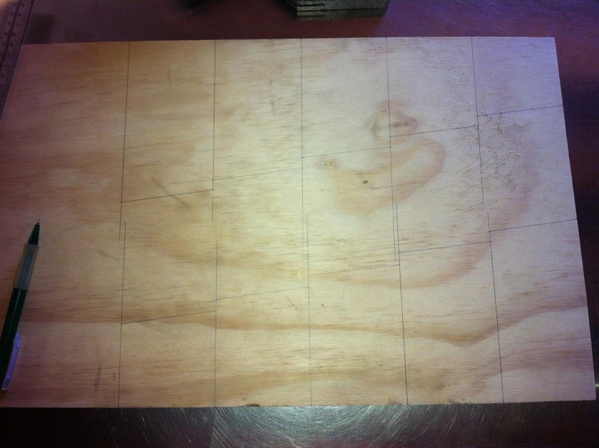

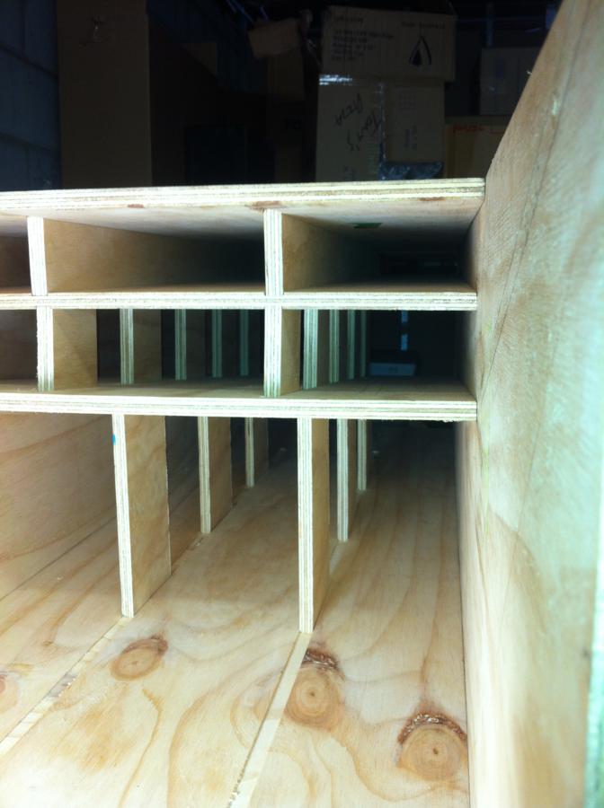

full set of braces
full set of braces
cutting the braces did not take a long as expected. I just used cheap bandsaw and a steady hand, didn't even need sanding afterwards.
more dry fitting, I decided to continuous braces for the bottom most for ease and segmented braces for the mid and top I hope this is ok?
quite happy with how these turned out
first time using a router, things went better than expected

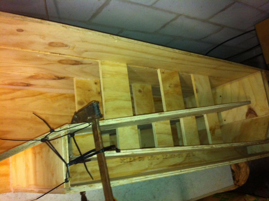

and more

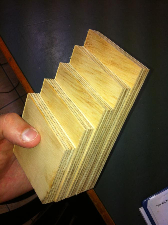

I used this for the braces

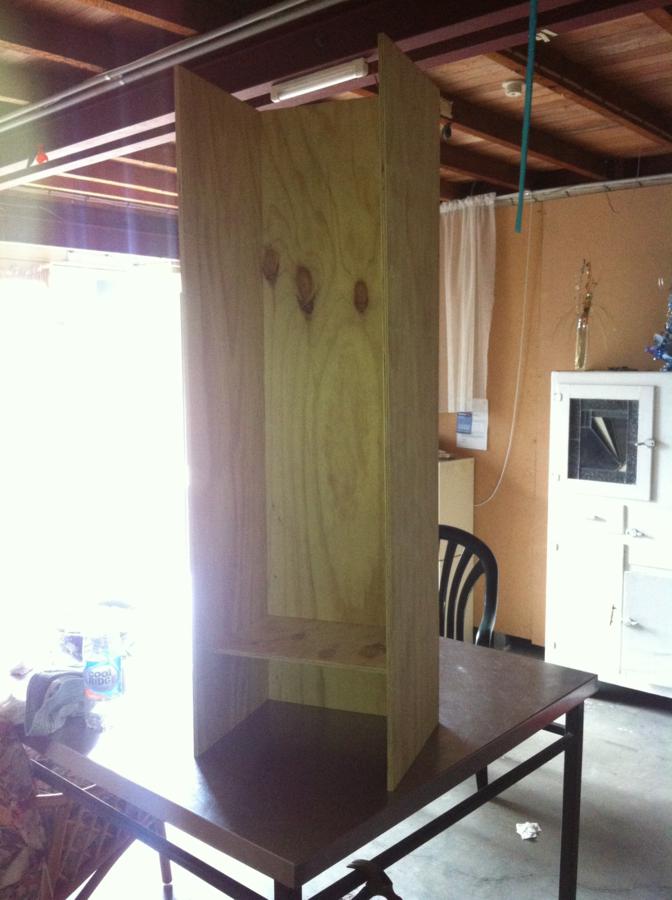

my build order and techniques might be slightly different than the plans
who needs clamps and jigs when you pre-measured and have lots of screws.
The first panel goes on
I ended up redrawing the mid braces in autocad, I modified them so the sides are perpendicular to one of the ends (they are not in the sketchup), this makes measuring and cutting them out easier.

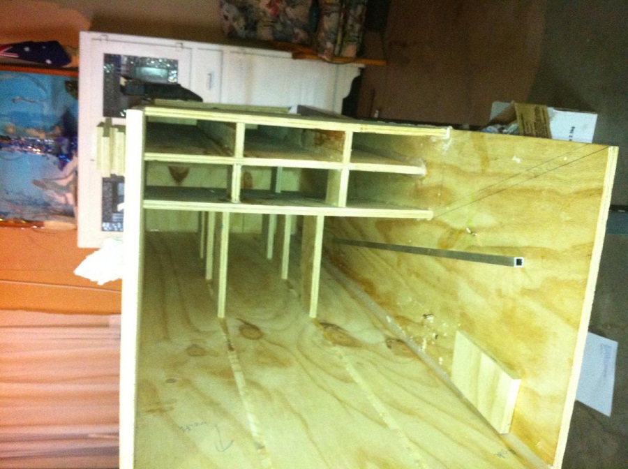

they keep comming

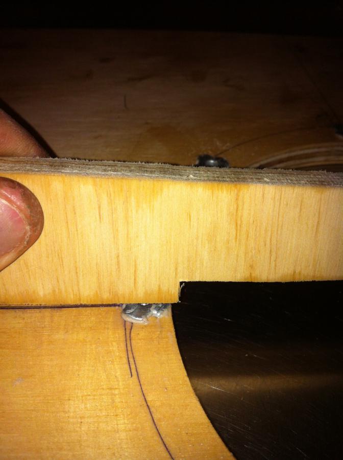

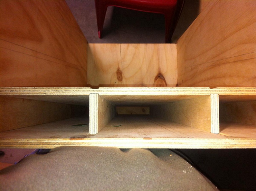

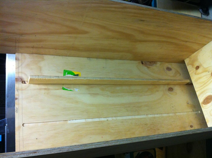

This is how I solved the problem
I thought about mounting the brace slightly offset but decided against it.

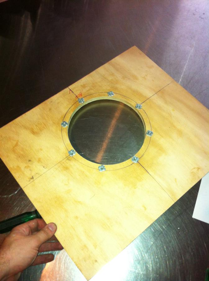

shit, my t-nuts interfere with the brace.

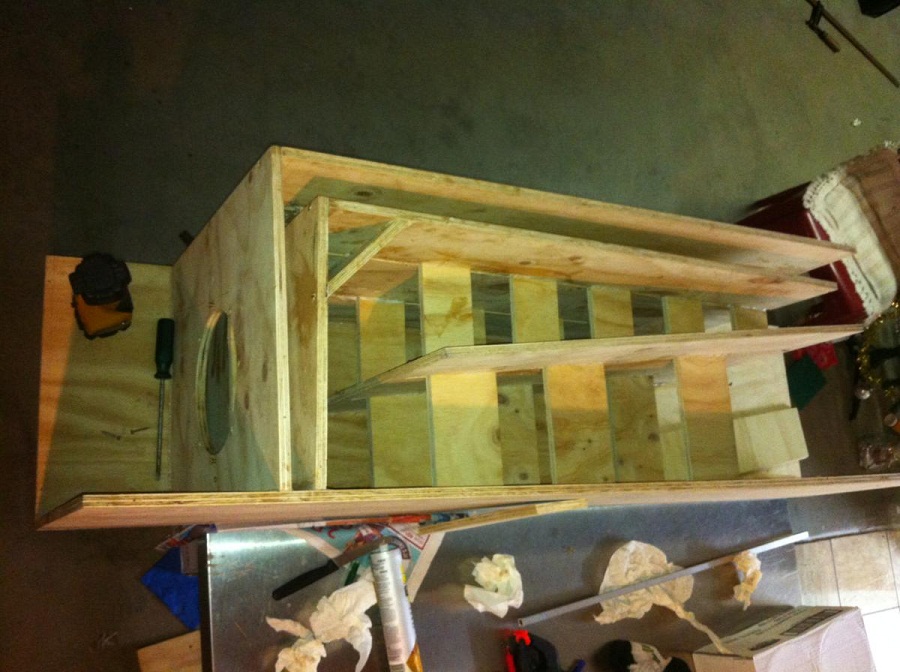

driver cut-out for the 8 inch dcs205-4

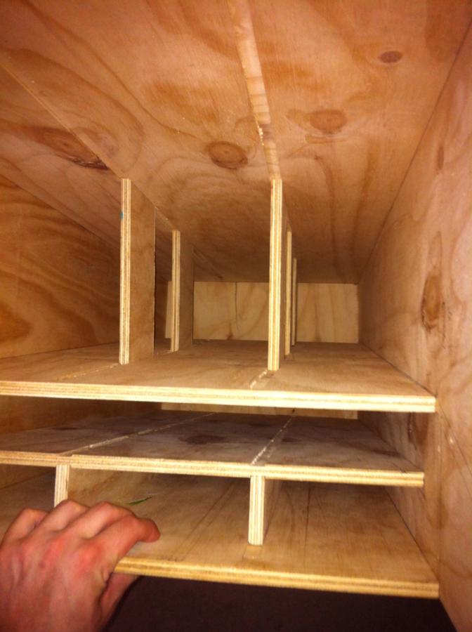

I thought the braces looked quite cool, so I took a bunch of pictures.

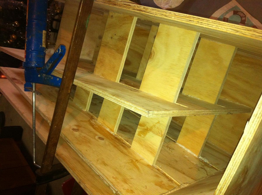

braces are glued, this was SOOOO much easier with dadoing

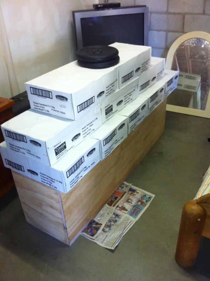

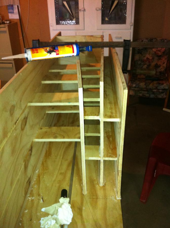

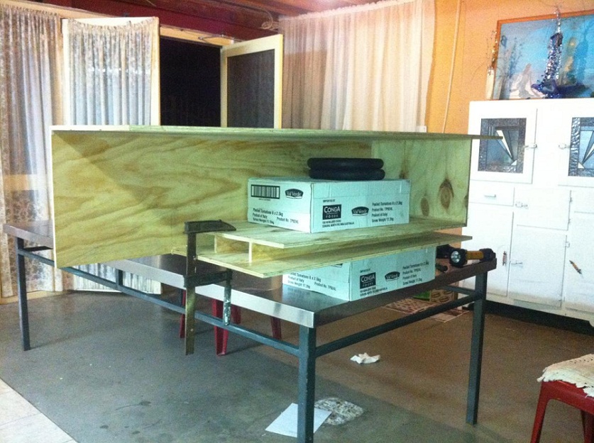

This is how it is sitting at the moment, I don't have any clamps large enough for this thing, but I have plenty of heavy boxes, so I stacked about 200kg on top of it :lol:

:shock: Have you double-checked the clearance of those two t-nuts underneath the baffle brace?
It looks to me that as the fastener pokes through the t-nut it will end up contacting the brace. That could end up distorting the panels, or busting a glue joint in that area. :fingers:
Other than that, great build so far. Nice use of the router :clap:

Radian wrote::shock: Have you double-checked the clearance of those two t-nuts underneath the baffle brace?
That's the same reason I off set mine so it don't end up on a brace. If so just cut the bolt or put a smaller one in that place.
Agreed, great build. :clap:
I checked the length of the screws under full gasket compression, so no problems there :)

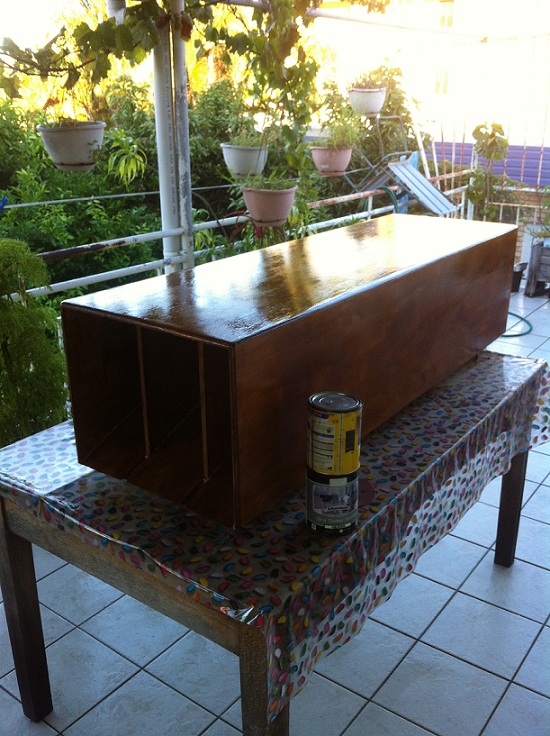

Sooooo I finally ended up finishing my TTLS :)
Re: My Table Tuba LS build
#14 Post by LelandCrooks »
Nice job staining that plywood. Not fun getting an even color on ply.
