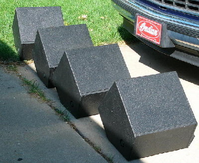

My standard for PA cabinet coatings is lower than Duratex - which is very nice. I want something tough, cheap, easily applied, and easily touched up infrequently.
My new favorite "in-house" cab coating is water-based, hardens nicely, and contains texturing which looks pretty good when applied with a roller.
$40 USD per gallon, stocked at Walmart, available globally http://www.plastikote.com/plastikote/splash/index.jsp
It is much harder & more durable than Tolex, and compares favorably to Line-X, though it is not as durable or pretty.
I've rolled it on at 40 DegreesF and it cured overnight in my cold shop. (Bring it in the house to dry faster - it doesn't stink!)
Don't buy it in a spray can - it clogs the tip too easily.
Wedgehorn 8s coated with Plastikote
