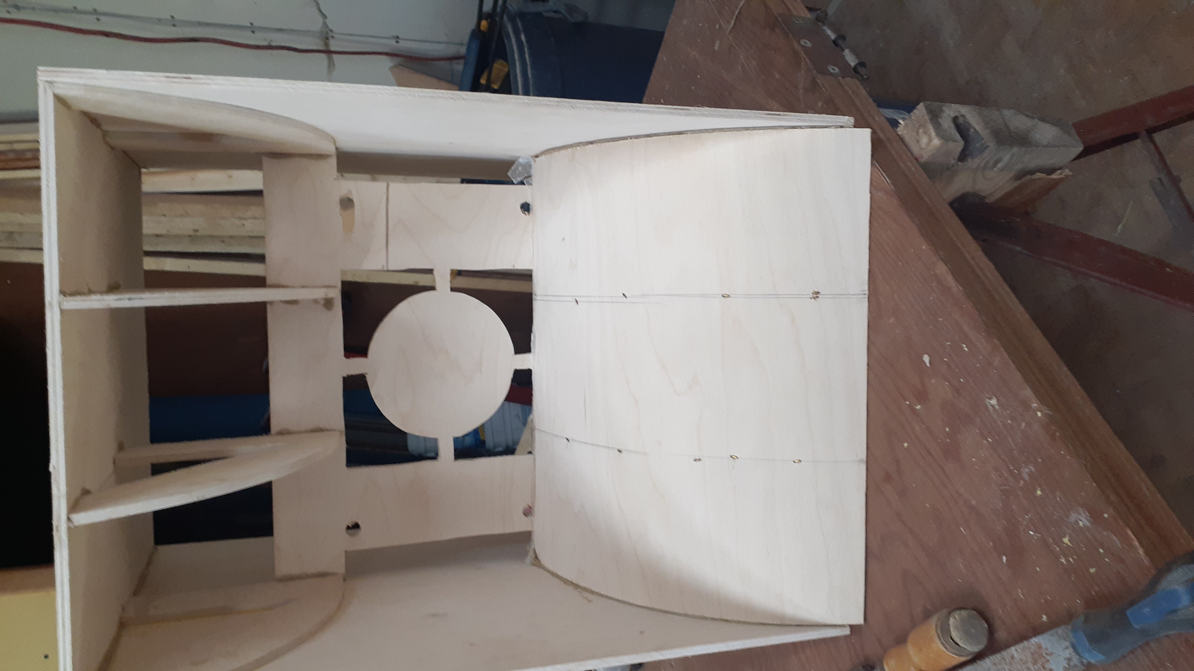

Started cutting for 2 with another 2 planed. Taking pictures but nothing post worthy yet. Its been in the plans for over 2 years but had to make the first step and buy the ply. Will be full melded array for the first 2 , partially for bass but want them to be PA capable.

First question, of many to come. When gluing the front horn braces that go directly on the bottom and top panels. Is it ok to use white carpenter glue for these as they are flat to the panel. Just thought it might be easier to get them flat, tight to the panel.

You may, but it's got to be airtight.

T_Gowan wrote: Tue May 27, 2025 9:11 am First question, of many to come. When gluing the front horn braces that go directly on the bottom and top panels. Is it ok to use white carpenter glue for these as they are flat to the panel. Just thought it might be easier to get them flat, tight to the panel.
I wouldn't. Unless your cut is dead-on 90 degrees (or whatever the slant is on the Lites), there will be some wiggle when you square it up between the top and bottom. That's where you could possibly get a leak. Not worth it....use the PL everywhere. The squeezeout proves that it's airtight.

Just doing a set or 2 a day. Doing 1 box now to make my mistakes on it lol.
