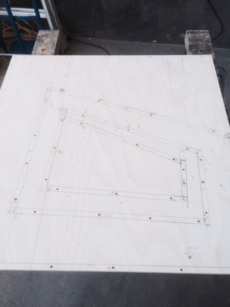

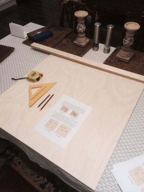

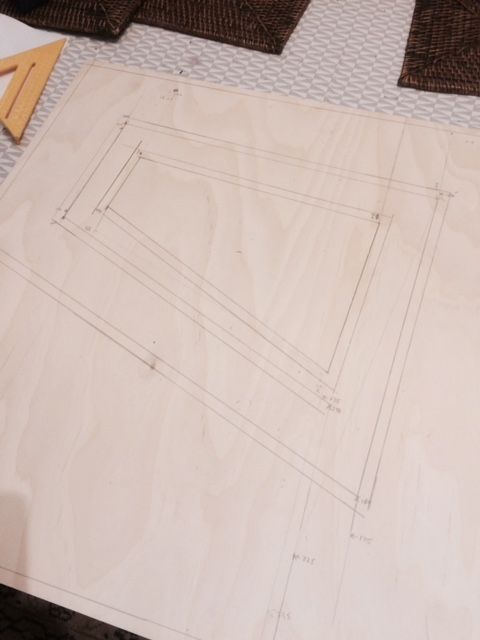

Table Tuba 18 inch starts
Pulled the trigger on this project for stereo music listening.
At this stage, I'll use one single horn to partner with my Azura horn system.
Target xover point is 80Hz.
I was lucky to have access to lovely Euro birch ply....9 layers per half inch. Zero warping will make for an easy build.
Opted for Tang Band driver, 8 inch.
Andrew
