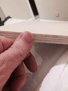

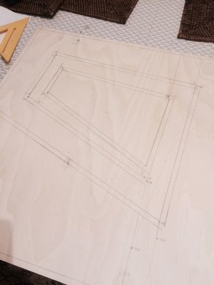

I was lucky to have access to lovely Euro birch ply....9 layers per half inch. Zero warping will make for an easy build.
Opted for Tang Band driver, 8 inch.

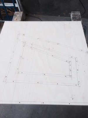

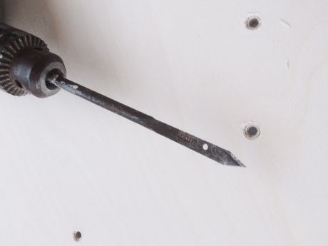

Screw holes and chamfers made today.

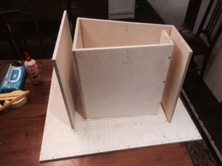

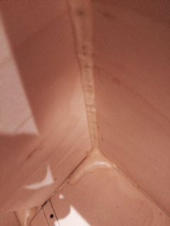

Started glue up tonight.
Using screws to secure each panel...as they've been precision cut, the screws pull the panels perfectly square. Easy.
I haven't added baffle panel...so I'm completing it out of strict order.

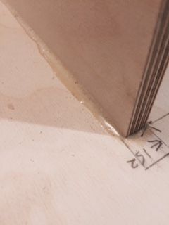

Poly glue foaming up nicely.

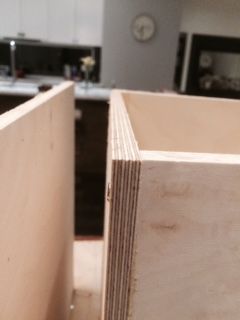

Two panels need a few mm trimming. All the angles have worked out fine...except one panel where I cut the two angles the wrong way. Luckily, I have some spare ply to fix.
See pic to show how the levels our all true.
Used iPhone compass app to check vertical true.

You're using PL Premium, right? That doesn't look like PL squeeze-out to me for some reason.

Yes. That's not a good pic. Other sections of glue have bubbled up to be over half inch thick outside the join.bassmonster wrote:You're using PL Premium, right? That doesn't look like PL squeeze-out to me for some reason.
andrewtilsley
- Posts: 37
- Joined: Sun Apr 19, 2015 10:01 pm
Re: Table Tuba 18 inch starts
I meant to attach this pic.bassmonster wrote:You're using PL Premium, right? That doesn't look like PL squeeze-out to me for some reason.
Don't be to harsh lol. PL premium, as far as I've been able to ascertain, is only available from one source here.bassmonster wrote:You're using PL Premium, right? That doesn't look like PL squeeze-out to me for some reason.
And minimum order is by the box.
So you will perhaps find some Aussie builds with Sika product or similar...

Phew.
I've built dozens of horns...and this product is excellent.
I debated getting the thicker Sika product (used with tube gun), but it was less economical.
