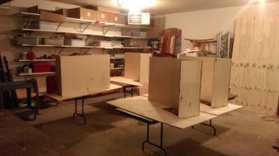

Anyways Day 1 progress- Kinda slow because I had to mark and cut out access panels on all 4 cabs. when building 2 or 1 it doesn't seem to take that long but 4 it just drags! After I got panel 1 and panel 2 cut out for all 4, installing became rather quick. Lay the pl, slap the panel in and shoot brad nails right in. then put panel 2 on and away you go. here are some pix.

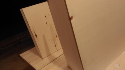

Oh and I feel I should confess. I have sinned. With all of my cuts I have not been using guides with my circular saw. I just layed a line and cut along the side of it. I've been getting straight cuts with this method, much more efficient because I take extra caution, with the guide I get the occasional glide off the path or even put too much pressure and the guide slips a bit. Eventually I'll bite myself in the a$$, but that's why I bought an extra sheet of wood! XP Here's a sample of how straight I can freehand :fruit:

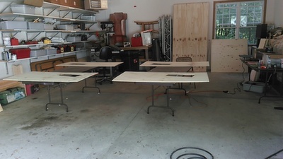

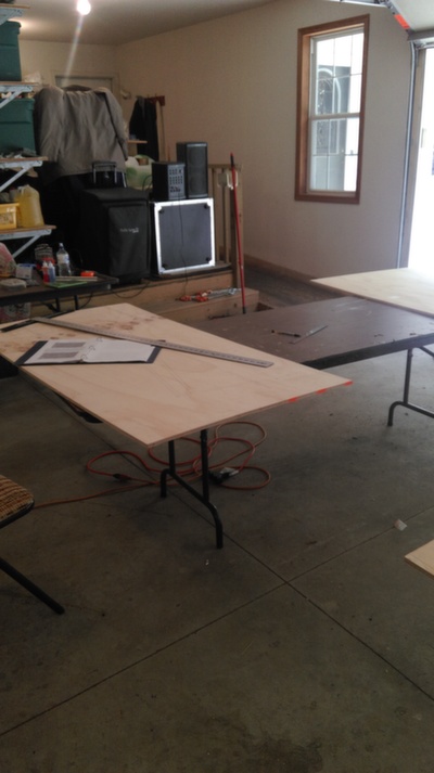

Day 2 pictures.
Considering I had to route 16 holes, and epoxy down 64 t nuts I think I made a respectable amount of progress today. If anyone is looking to build t60s, I would opt for opening up the center and putting the jacks inside on the divider. On my previous ones I put them on the front and the back bottom corner, I just didn't like it that way for some reason. Im not sure if anyone knows it but neutrik sells combo jacks so you can plug 1/4 and speakon into the same jack, and it looks like a regular speakon. I think most amps have these, and I went and spent the extra $2 because it just gives more versatility.
