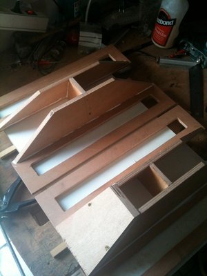

first build for me: a pair of DR 250 (3010 and melded array...)
the big challenge: having 'em finished at the end of august.

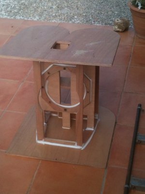

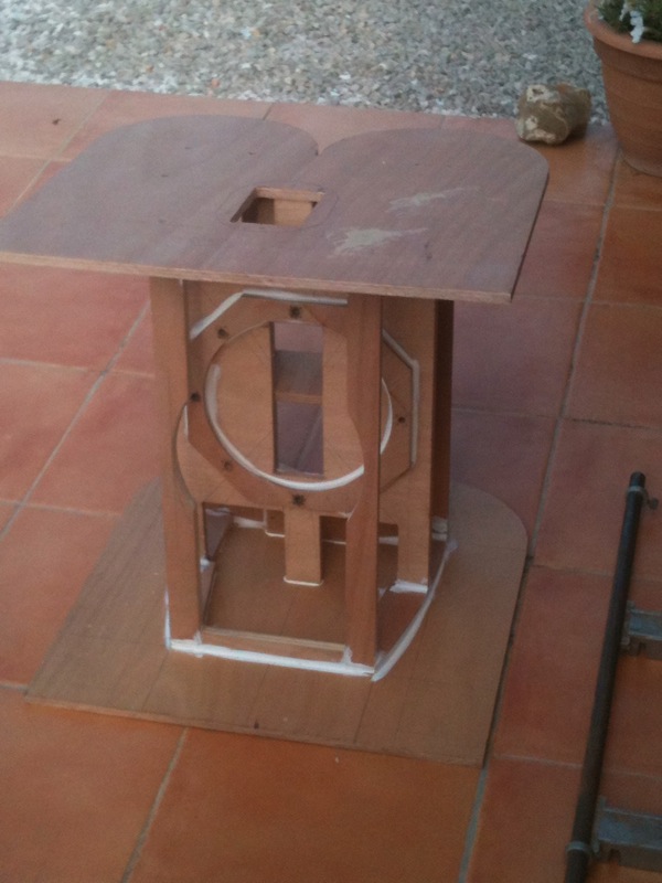

ok the main parts are done...i'm beginning with the tricky phase now...

I'm sorry, Kranku68, but you installed the T-nuts on the wrong side of the woofer baffle. If they are not glued in, it's not a big problem. Pull them, drill all the way through the woofer baffle, then install hardwood dowel to fill in the holes. Use "Kreg jig" style screws to attach the woofer, and leave the T-nuts out.
Other than that, good looking build!
Kranku68
Posts: 52
Joined: Fri Jun 20, 2014 3:15 pm
Re: DR 250 in France...
#10 Post by Kranku68 »
Yeah and i knew that but i had to make a choice...in fact i ordered too shorts screws !
So to be able to mount my speakers that was the only way...so i've glued the nuts and i'll probably have to install a joint for the speakers :cry:

Kranku68 wrote:Yeah and i knew that but i had to make a choice...in fact i ordered too shorts screws !
As you tighten the bolts, you will pull the t-nuts out...even with glue. If you don't tighten it enough, you'll get leaks around the speaker gasket.
You really have to re-do this.

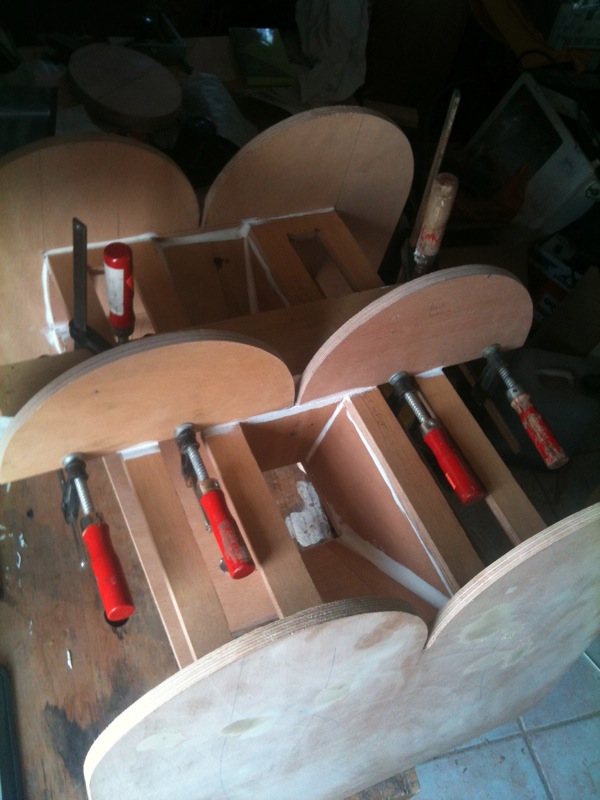

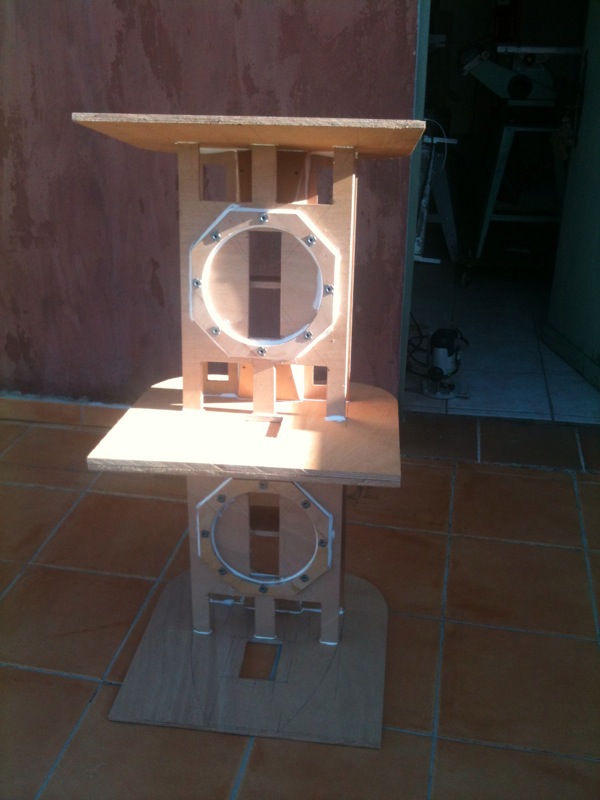

ok some progress...
so i've followed the advices and taken away the t-nuts from the wrong side and put'em on the correct side.
an afternoon making some dust and the sheath cleats have been cut and glued...
the back braces are now cut and i'm beginning the glueing process...

#15 Post by Tom Smit »
Is that white silicone at the joints? May I suggest that you use a knife/chisel to trim it out? The horn sheaths have to go tight to the cleats, and those beads may impede that to happen and you risk having the cab not be air-tight..
