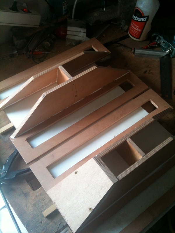

Kranku68, I hope you are not using that Tite-Bond wood glue instead of an expanding polyurathane adhesive, such as Loctite brand PL Premium. Tite-Bond does not have the expanding, gap-filling capabilities of PL Premium, and this is a must for air tight finish.

DjPhatman is right (although the Google translate is a bit confusing...)
Tu dois absoluement utiliser la colle PL Premium. Elle prend une légère expansion ce qui permet de faire des joints parfaitement étanches.

Yes !
Don't worry...the tite bond bottle was there cause I was glueing a fretboard at the same time and assembling some pieces of plywood to cut some new parts of the throat horn
... No tite bond for the dr 250, I've read some of the posts and it's written in the plans !,,,
But Thanks for the advice anyway

I'm sorry, Kranku68, but you installed the T-nuts on the wrong side of the woofer baffle. If they are not glued in, it's not a big problem. Pull them, drill all the way through the woofer baffle, then install hardwood dowel to fill in the holes. Use "Kreg jig" style screws to attach the woofer, and leave the T-nuts out.
Other than that, good looking build!

Yeah and i knew that but i had to make a choice...in fact i ordered too shorts screws !
So to be able to mount my speakers that was the only way...so i've glued the nuts and i'll probably have to install a joint for the speakers

As you tighten the bolts, you will pull the t-nuts out...even with glue. If you don't tighten it enough, you'll get leaks around the speaker gasket.Kranku68 wrote:Yeah and i knew that but i had to make a choice...in fact i ordered too shorts screws !
You really have to re-do this.

Damned...you're just f####### right...how could i have been so stupid
So let's re-do that part...

Kranku68 wrote:Damned...you're just f####### right...how could i have been so stupid![]()
You aren't stupid
You just proved that you are smart.

ok some progress...
so i've followed the advices and taken away the t-nuts from the wrong side and put'em on the correct side.
an afternoon making some dust and the sheath cleats have been cut and glued...
the back braces are now cut and i'm beginning the glueing process...

Is that white silicone at the joints? May I suggest that you use a knife/chisel to trim it out? The horn sheaths have to go tight to the cleats, and those beads may impede that to happen and you risk having the cab not be air-tight..
