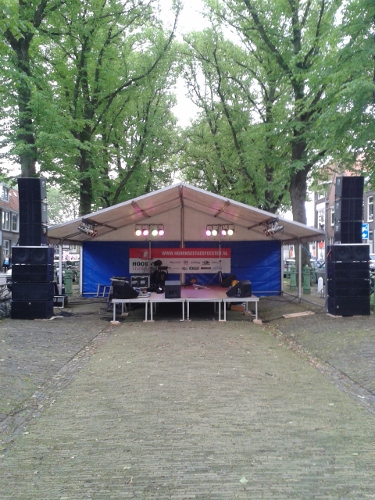

Six DR250 and Six Subwoofers with RCF LF18G401 Speakers and two Subwoofers With 4 Eminence 15 inche speakers.
This system is great for outdoor for about 1200 people.
The sound is clear and loud without distorion. :D :clap:

Very nice, I like how you stacked those 250's, :clap:

#3 Post by Bill Fitzmaurice »
Lastcat wrote:Very nice, I like how you stacked those 250's, :clap:
-1, I'm afraid. A J array should have the lowermost speakers tilted downward, the uppermost aimed at the furthest point of the coverage area, not the other way around. And as sooner or later someone will bring up the insufficient distance between the sub stacks to prevent power alley effects, I just did.

#5 Post by sine143 »
i was going to point out the top cab pointed downwards. seemed a bit oddd.

#6 Post by Lastcat »
Oh ya, there can be changes. Subs could be farther apart, they look close to 53'. Tops too low, subs should be together, and of the same type cabinets. We could go on and on...
But, I was admiring how he connected the 3 DR's. Look how he use's adjustable rods on the side of the DR250's. To adjust for height. Then the Aluminum plate for the base. That is where credit is due. Let alone building 6, if he/she was the builder. Pat on the back piet :clap:

#7 Post by piet »
I know your are right we are working now to that problem to change that.

#8 Post by Charles Jenkinson »
I'm interested to know where the subs should go, and how they should be stacked in this scenario. It's plain to see why everyone does it wrong all the time given commercial offerings and general lack of knowledge in the PA set-up arena. ...Plus what support solutions can people suggest for elevating/positioning the DR's, and what height they should be etc. My view on the latter is light weight aluminium scaffold to get elevation and have the array inside the foot print of the scaffold, or more elegantly, a vertically oriented aluminium (triangular in cross section) truss behind the DR stack and hang them on the front of it, with the truss fixed to an adequate base.
2xT30
Re: Six Dr 250 with eight subwoofers
#9 Post by Chris_Allen »
Well, that is often the problem. The environment in which you place your speakers limits your options and when you are outdoors, this can leave more complications than indoors when you factor in security and safety.
In that situation, I would have probably set it up just the same. I understand the power alley problems but what else are you to do other than cut the frequency? Some people probably like the power alley (you crazy bass nuts!) but the top pointing down at the top probably does need working on.
I think we often struggle on here with the difference between perfectly acceptable for the crown being played to and audio eliteness. As long as we understand the best way of doing things and why, common sense can fill the other gaps.

#11 Post by Charles Jenkinson »
Well.
A quad of end-firers would fit under that stage, pointing straight out. Would that be better?
TBH, I think I was influenced by your profile pic. The problem only exists when we post next to one another. From memory, 'escape' isn't bound by the same inhibitions as us.

or you could use these :
http://www.wikizic.org/admark-line-arra ... lery-1.htm
i personally woulduse something like this because it's on hand
http://www.altrex.com/be/product/1277/s ... eiger.html

#15 Post by sine143 »
subs all across the front, vertical, deployed curved pattern for cardoid, or delay compensated for cardiod pattern. I assume the tops DR280s are pointed down because a stack of that height was giving them wayyy too much coverage in the long throw game (probably running into someone elses soundspace). if they stacked the dr's on top of scaffolds of shorter height than their 4 sub stacks, they could either properly J array them, or just keep them all facing straight out ( i assume no j array due to insufficient power amp channels for powershading)
