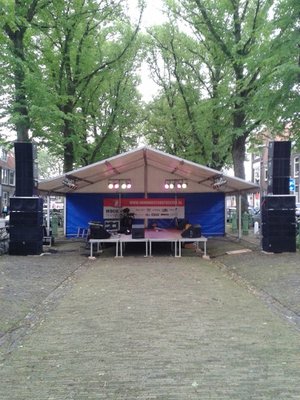

This system is great for outdoor for about 1200 people.
The sound is clear and loud without distorion.

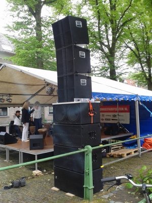

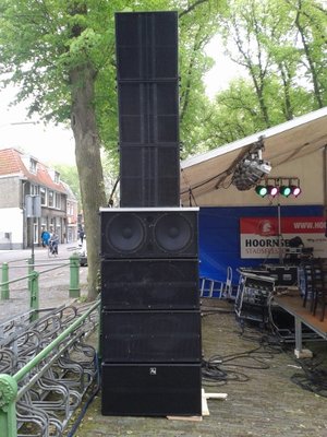

-1, I'm afraid. A J array should have the lowermost speakers tilted downward, the uppermost aimed at the furthest point of the coverage area, not the other way around. And as sooner or later someone will bring up the insufficient distance between the sub stacks to prevent power alley effects, I just did.Lastcat wrote:Very nice, I like how you stacked those 250's,
i was going to point out the top cab pointed downwards. seemed a bit oddd.Bill Fitzmaurice wrote:-1, I'm afraid. A J array should have the lowermost speakers tilted downward, the uppermost aimed at the furthest point of the coverage area, not the other way around. And as sooner or later someone will bring up the insufficient distance between the sub stacks to prevent power alley effects, I just did.Lastcat wrote:Very nice, I like how you stacked those 250's,
Oh ya, there can be changes. Subs could be farther apart, they look close to 53'. Tops too low, subs should be together, and of the same type cabinets. We could go on and on...Bill Fitzmaurice wrote:-1, I'm afraid. A J array should have the lowermost speakers tilted downward, the uppermost aimed at the furthest point of the coverage area, not the other way around. And as sooner or later someone will bring up the insufficient distance between the sub stacks to prevent power alley effects, I just did.Lastcat wrote:Very nice, I like how you stacked those 250's,
I know your are right we are working now to that problem to change that.Bill Fitzmaurice wrote:-1, I'm afraid. A J array should have the lowermost speakers tilted downward, the uppermost aimed at the furthest point of the coverage area, not the other way around. And as sooner or later someone will bring up the insufficient distance between the sub stacks to prevent power alley effects, I just did.Lastcat wrote:Very nice, I like how you stacked those 250's,
