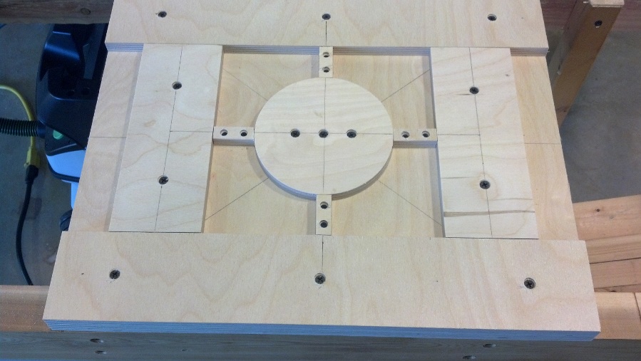

Sorry if this has already been posted, but here is a really simple way to build baffle templates.
Only requires routing a circle and cutting some straight edges, screwing them down and routing around them with a top bearing template bit. The inner material is easily removed by plunging the bit.
Once you remove the screws/wood you are left with the master jig.

Actually, I haven't seen a jig thread in a long time.. So this is great advice for new builders.. You do need to mention that you need a top bearing template bit for this to be possibletpgreen wrote:Sorry if this has already been posted, but here is a really simple way to build baffle templates.
Only requires routing a circle and cutting some straight edges, screwing them down and routing around them. Once you remove the screws/wood you are left with the master jig.
I do templates like this with a festool plunge saw and finish cuts with a jigsaw - gives perfect straight cuts aswell and is a bit faster than cutting out all those small pieces imo - but each to their own

Good point about mentioning the top bearing template bit(just edited it). I had never owned/used a router before my first BFM build a few months ago.Michael Ewald Hansen wrote:Actually, I haven't seen a jig thread in a long time.. So this is great advice for new builders.. You do need to mention that you need a top bearing template bit for this to be possibletpgreen wrote:Sorry if this has already been posted, but here is a really simple way to build baffle templates.
I found I was way too unsteady with the jigsaw - hence straight edges/circle, which even a novice can conquer with the right tools. With a T55 plunge saw and Jasper Circle jig I can at least cut a straight line and circle.)

You don't really NEED a top bearing bit. Just take a Forstner bit or something similar to drill 4 large holes; then flip the combo and route from the other side.
Top bearing bits seem to be virtually non-existing over here. I've seen them in distributor catalogs but never in retail.

I have a bottom bearing bit which mean my template is strapped to the bottom of whatever I'm cutting out. Might look for a top bearing bit.Rune Bivrin wrote:Really like the concept!

That's how I did the WH8 baffles, except I used a bottom bearing bit with the template underneath and hogged out the majority of the material first with a sabre saw. The router bit just trims away the last remaining bit of wood and finishes off the cutouts.
