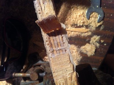

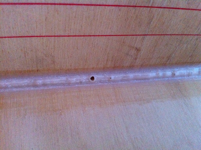

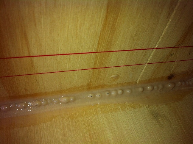

I have used this glue before in my autotuba build and it worked fine. However, this afternoon as I was assembling my TTLS I noticed a concerning behaviour. At the squeeze out of the joins the adhesive was bubbling in little pockets, these sometimes popped and left little craters (see images). I am worried this will cause joints not to be airtight. When I ran my finger along the bead to smooth it down you could hear the bubbles pop.
I think part of the reason this happens is the glue cures too quickly with the weather here, only about 33degC but over 80-90% humidity in the daytime. I did an experiment, I put some the adhesive in the fridge and glued up a test joint, let it dry and ripped it open, you can see the air pockets still form, but not always pop. I found lowering the temperature so the glue cured slower helped somewhat but not greatly.

Yes.AlessandroAU wrote: Does PL premium do this
No.AlessandroAU wrote:should I be concerned my joints will not be airtight?
Then don't smooth the bead down with your finger. You don't have to do that. It's not caulk. If you have that much squeeze-out, it's because you're using too much adhesive.AlessandroAU wrote:When I ran my finger along the bead to smooth it down you could hear the bubbles pop.

Your running your finger down the ooze soon after you have applied the adhesive will cause that bubbling and hole like in your post so don't do it at all.. Let it set with full ooze for about 12 hrs, then use a box cutter knife or chisel to remove the excess. Leaving it longer will make it harder to cut into.AlessandroAU wrote: When I ran my finger along the bead to smooth it down you could hear the bubbles pop.
Spritz the joints with water to make them slightly damp before applying the adhesive even though your humidity is high.AlessandroAU wrote: I think part of the reason this happens is the glue cures too quickly with the weather here, only about 33degC but over 80-90% humidity in the daytime. I did an experiment,
