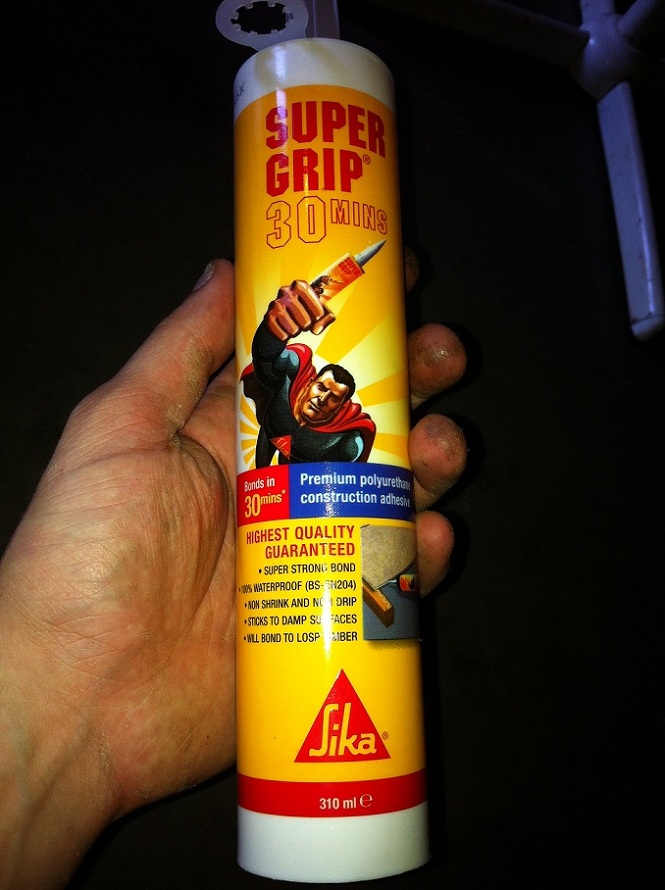

SIKA ( sold by Bunnings and Mitre 10 ), have a product called SuperGrip® ( 30 Minute; A transparent polyurethane paste adhesive. SuperGrip 30 Minute is a versatile, ready to use, fast curing, general purpose construction adhesive.)

I just bought some of the SIKA supergrip, burnings nor mitre ten didn't have any max bond, I'll do a panel with it and see how it goes.

I can't find it on the bunnings website unfortunately, but this is the stuff: http://www.glueguru.co.nz/product/423/ it was recommended by Harley in an above post.

I did some testing and more reading and am convinced that the selleys liquid nails platinum is the way to go. I finished my cabinet and I confident there are no leaks. I didn't like how little time the sika took to grab and how quickly it expanded, I ended up using it on the braces and it worked great there though.bitSmasher wrote:I decided to go check out Bunnings the other day, ugh so busy... adhesives, for reference:
