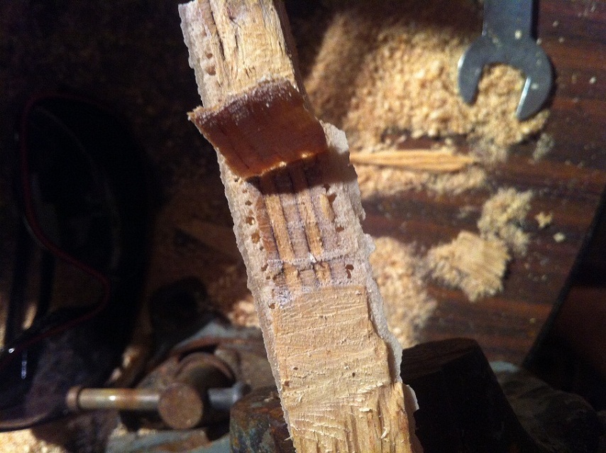

I have used this glue before in my autotuba build and it worked fine. However, this afternoon as I was assembling my TTLS I noticed a concerning behaviour. At the squeeze out of the joins the adhesive was bubbling in little pockets, these sometimes popped and left little craters (see images). I am worried this will cause joints not to be airtight. When I ran my finger along the bead to smooth it down you could hear the bubbles pop.
I think part of the reason this happens is the glue cures too quickly with the weather here, only about 33degC but over 80-90% humidity in the daytime. I did an experiment, I put some the adhesive in the fridge and glued up a test joint, let it dry and ripped it open, you can see the air pockets still form, but not always pop. I found lowering the temperature so the glue cured slower helped somewhat but not greatly.
Does PL premium do this, should I be concerned my joints will not be airtight?
tore apart a joint so I could see what was happening on the inside
you can see the bubbling under the surface
example of a bubble popping and leaving a small pit behind.

#2 Post by Radian »
AlessandroAU wrote: Does PL premium do this
Yes.
AlessandroAU wrote:should I be concerned my joints will not be airtight?
No.
AlessandroAU wrote:When I ran my finger along the bead to smooth it down you could hear the bubbles pop.
Then don't smooth the bead down with your finger. You don't have to do that. It's not caulk. If you have that much squeeze-out, it's because you're using too much adhesive. :wink:

I doubt it's the equivalent and Selley's products have always fallen well short of expectation in my experience - I avoid Selleys like the plaugue. The chiseling off of the cured product in the video on your link, indicates to me that it's not the right product.
SIKA ( sold by Bunnings and Mitre 10 ), have a product called SuperGrip® ( 30 Minute; A transparent polyurethane paste adhesive. SuperGrip 30 Minute is a versatile, ready to use, fast curing, general purpose construction adhesive.)
Also - http://hbfuller.com.au/catalog/diy/adhe ... ?Itemid=26
AlessandroAU wrote: When I ran my finger along the bead to smooth it down you could hear the bubbles pop.
Your running your finger down the ooze soon after you have applied the adhesive will cause that bubbling and hole like in your post so don't do it at all.. Let it set with full ooze for about 12 hrs, then use a box cutter knife or chisel to remove the excess. Leaving it longer will make it harder to cut into.
AlessandroAU wrote: I think part of the reason this happens is the glue cures too quickly with the weather here, only about 33degC but over 80-90% humidity in the daytime. I did an experiment,
Spritz the joints with water to make them slightly damp before applying the adhesive even though your humidity is high.
Ohhh...and try and find better products like I linked you too - they are out there.

You can cover those adhesive with a lot of Epoxy, epoxy would not expand but will penetrate and seal those cracks and holes. Apply epoxy several times until your sure that its strong enough.

I did some testing and more reading and am convinced that the selleys liquid nails platinum is the way to go. I finished my cabinet and I confident there are no leaks. I didn't like how little time the sika took to grab and how quickly it expanded, I ended up using it on the braces and it worked great there though.
