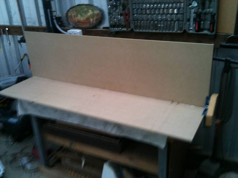

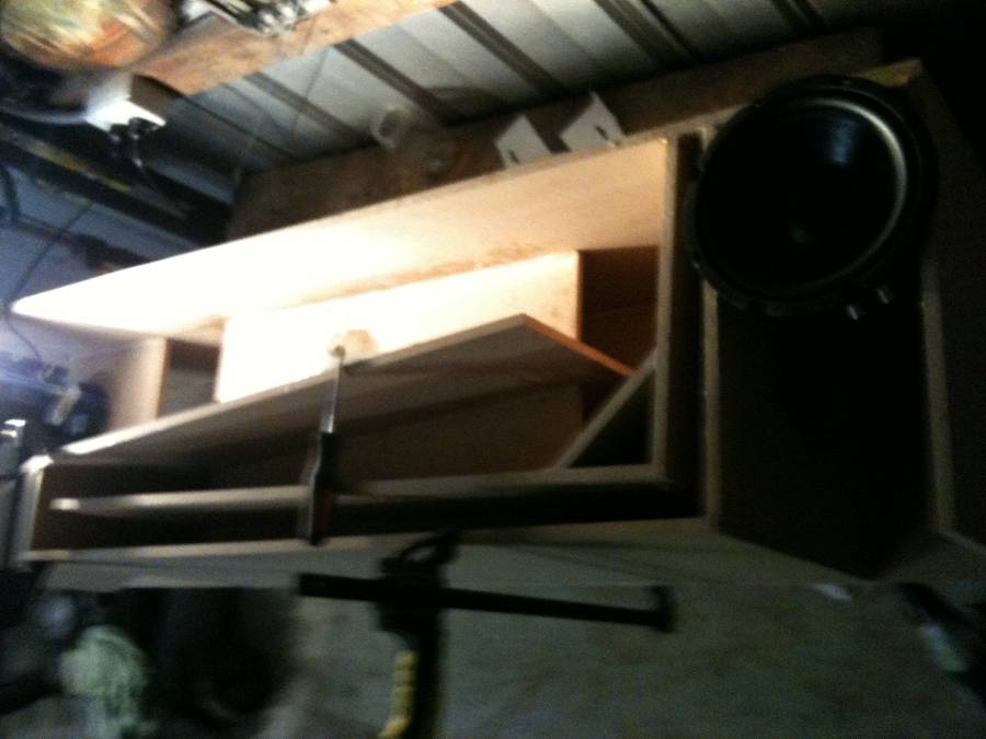

Starting building my TTLS 16" wide,
using 12mm MDF
Selleys Liquid Nails Platinum
Dayton DCS205-4
10-32 mounting kit from Parts Express

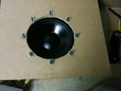

So far so good, I have been checking for any leaks
with the torch method and have been unable to detect
any. I had to redo the baffle because I cut out the hole
measuring from the wrong side :cussing:
T-nuts worked nicely and baffle has been installed.

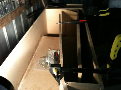

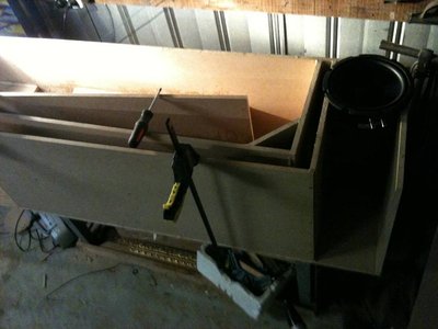

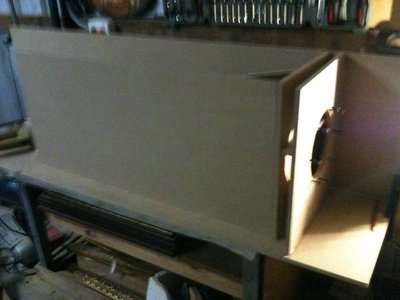

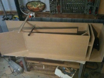

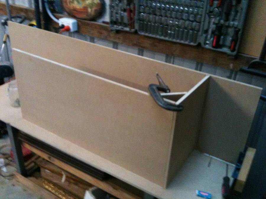

second day of the build and up to panel 9.
I got my MDF cut to width at Bunnings Warehouse
but what i'm using for panel 10 got cut 1/8" wider than the rest.
I might install it then belt sand it down before installing
the side panel. Circular saw is too much of a risk.
Building this for my room setup :) hopefully an improvement
over the pioneer ported 12" car sub i'm currently using.

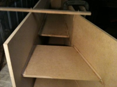

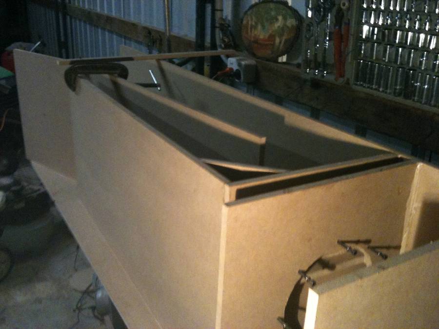

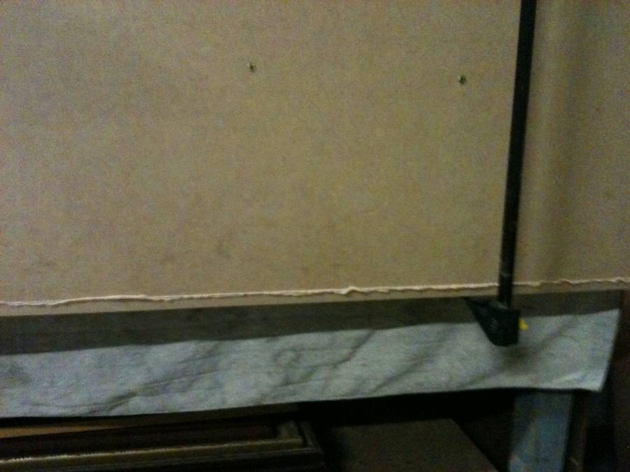

getting close now :hyper: going to grab some more liquid nails
tomorrow as i'm getting low and don't want to risk running
out when installing the side panel. Need to paint the inside
black while its still accessible.
squeeze out looking good
