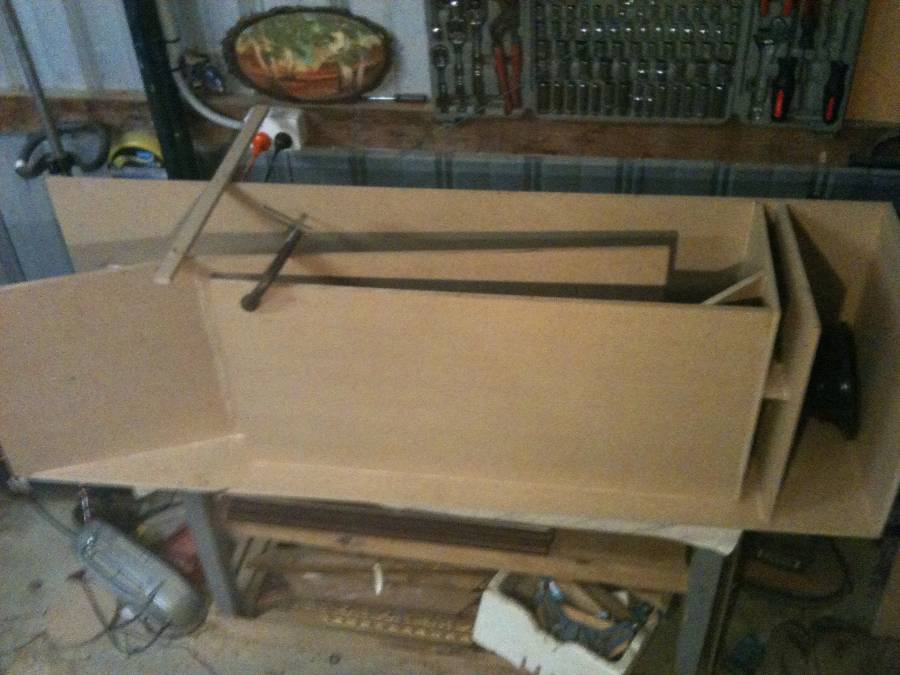

Starting building my TTLS 16" wide,
using 12mm MDF
Selleys Liquid Nails Platinum
Dayton DCS205-4
10-32 mounting kit from Parts Express
So far so good, I have been checking for any leaks
with the torch method and have been unable to detect
any. I had to redo the baffle because I cut out the hole
measuring from the wrong side :cussing:
T-nuts worked nicely and baffle has been installed.

I didn't see anything on Selleys website about how the Liquid Nails Platinum expands. Hope you don't have any leaks. :chainsaw:
Another site suggested that it expanded slightly, but the 3/8" expansion of PL isn't what I'd call only "slightly" expanding.
That sucker is going to be heavy! Clean build so far.

On Selley's website it says "expands slightly as it cures"
It is polyurethane based and a few people have used it before.
So should have better results than PVA adhesive anyway.
I used MDF because it was 1/2 the price, no warping and
voids or gaps to worry about and I wont be moving it around much.
Plywood when I built the THT :wink:

second day of the build and up to panel 9.
I got my MDF cut to width at Bunnings Warehouse
but what i'm using for panel 10 got cut 1/8" wider than the rest.
I might install it then belt sand it down before installing
the side panel. Circular saw is too much of a risk.
Building this for my room setup :) hopefully an improvement
over the pioneer ported 12" car sub i'm currently using.
