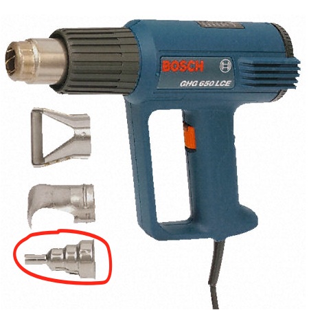

Is this sort of thing any good?

UROK wrote:Is this sort of thing any good?
It works great stripping the paint on my house. Soldering? Not so much. :conf:

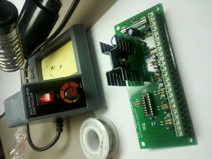

i used it to solder several of these controller boards and other diy projects. tin the tip properly and it'll last
