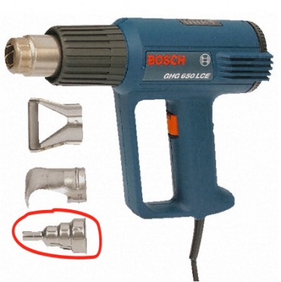

It works great stripping the paint on my house. Soldering? Not so much.UROK wrote:Is this sort of thing any good?

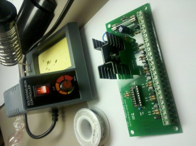

i used it to solder several of these controller boards and other diy projects. tin the tip properly and it'll last
