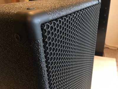

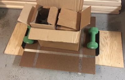

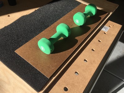

Revisiting the custom replacement grills I received from Reliable Hardware.
I was worried at first because these grills fit significantly tighter than the ones I had formed at work, which dropped right in. However, once I figured out that they fit so tightly in the baffle that they required no further fastening than somewhat brutishly press-fitting them into place, I was relieved.
I finally got around to ordering another batch of grill foam too, and read up on how Mr. Weber tackled getting the material to stick well enough to the grills. Hopefully the undercoating method works better than the contact adhesive I had tried previously. We'll see. If no luck this time around, I'll use them sans foam. Fingers crossed, but even without the foam, the new grills look great!
I'll be posting the ones I made in the For Sale section once the foam is re-installed.

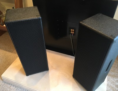

Grills turned out better than I was expecting. Was biting my fingernails there during the cure.
These SLA Pro are done now. Complimentary subs are currently in the works.

They look great! Nice job....
Re: Radian's SLA Pro 4x6 build
Those came out sooooo good looking. Great job Radian
They look great

how are your grills holding because I can't see any screw? Magnets?
Do you know which subs you will build for your SLAs?
Thanks all. Standing on the shoulders of giants here. Couldn't have done it without spending a ton of time in the Tips, Techniques, Suppliers section and checking out previous builds.
They are press-fit into place. The interference between the Line-X textured finish along the baffle and the vinyl coating of the grills is what's holding them. Rather tightly, I might add.jemo1234567890 wrote: ↑Fri Jan 22, 2021 7:15 am how are your grills holding because I can't see any screw? Magnets?
Titan 48's. I've got a build thread on them going already.jemo1234567890 wrote: ↑Fri Jan 22, 2021 7:15 am Do you know which subs you will build for your SLAs?
