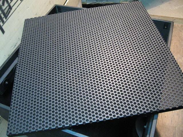

This is how the original plain perforated grill looked:

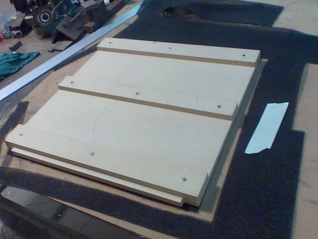

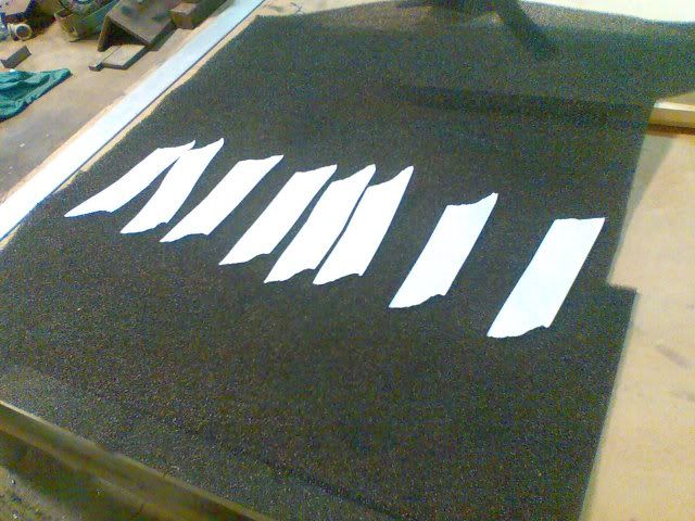

Here preparing the foam, holding the two pieces together with few cuts of masking tape:
Laying the back jig/template of the grill on top of the foam as a guide for cutting:

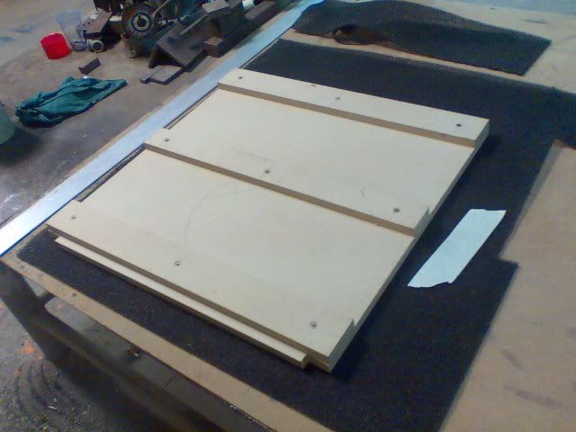

Foam cut:
Flipping the complete template and foam. Now ready for attaching the grill:

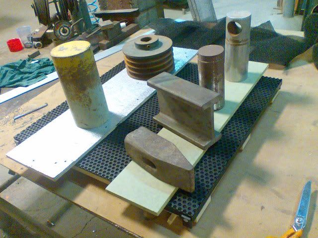

Immediately laying the sprayed grill on top of the foam. This causes the adhesive to 'drip' down a little into the foam and grip it positively. Straight away weights are added to insure good and even contact throughout the whole area of the grill:

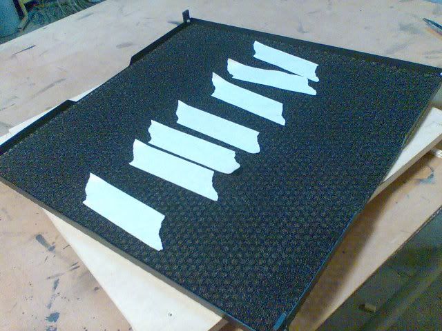

After initial curing of about 20 minutes weights are taken off, the grill can be lifted from the template (and in this case, the masking tape carefully removed):

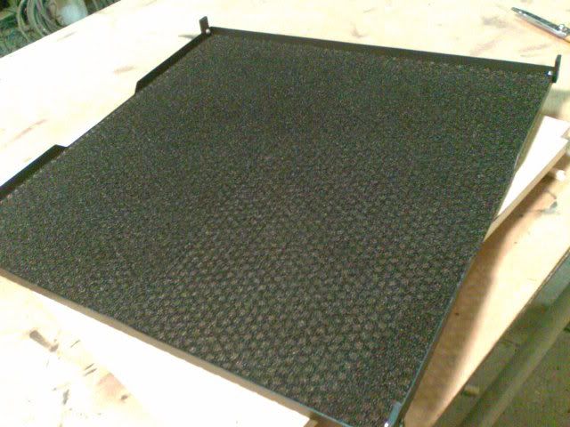

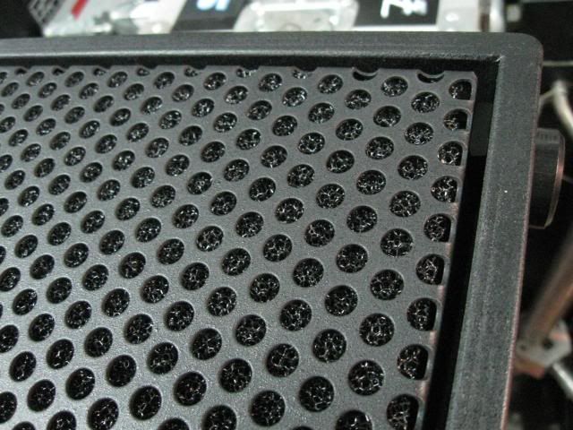

Here is a view of the finished work from the back side:
Here a better picture of the front side:
And a close-up:

Actually, I'd prefer to see a greater variety of weights used ( and lots more of them ) next time Nimrod.....ok ! :mrgreen:

P.S. Sorry about the weights, this is a metal workshop after all... :wink:

These grills were custom made (punched and bent) at a local shop according to my design.
Here seen at assembly trial before painting:
