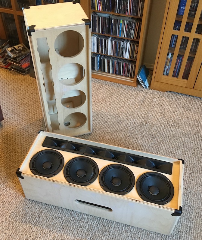

Just over a decade ago, Bill released plans for the SLA Pro and I got in on some Alphalite 6A's just before neodymium prices flew the coop. I sat on the drivers for what seemed an eternity, as life happens, eventually getting around to assembling everything.
It's been a helluva journey thus far. Here's the result of the build over the years.

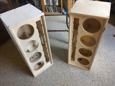

The dry fitting, a crucial step:

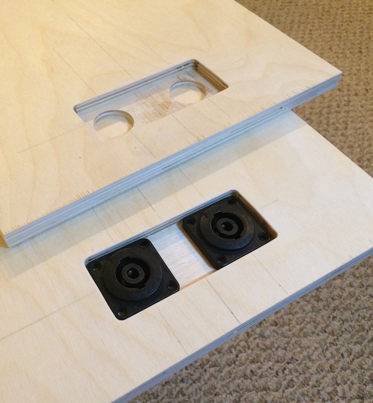

#2 Post by Radian »
Milling out and test fitting the SpeakON jacks. I glued another piece of 15mm behind the terminals to add some strain relief. Neutrik STX hardware:

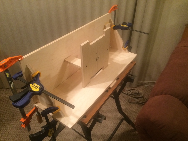

#3 Post by Radian »
Gluing up. Although these panels are all 90 degree cuts, ensuring that everything is dead nuts square is still no less important than any other cab build. All too easy to pick up a twist on the long side:

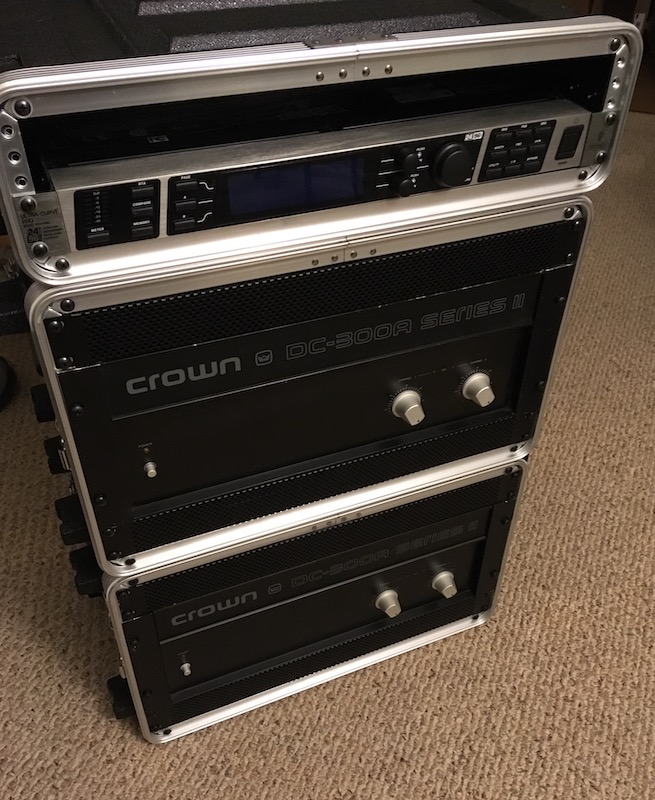

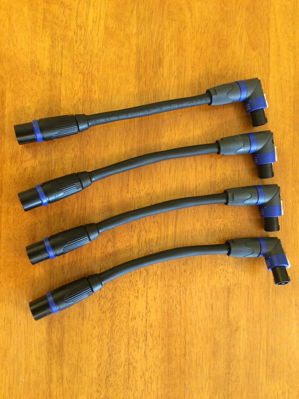

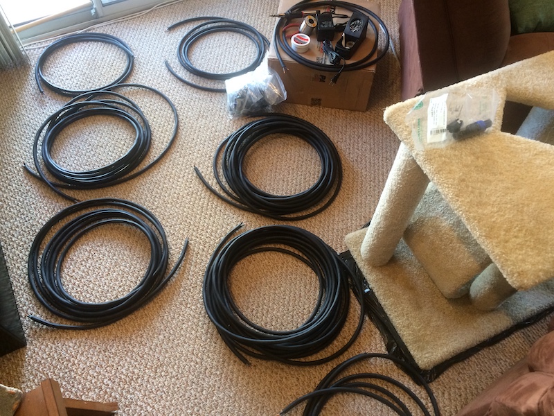

#5 Post by Radian »

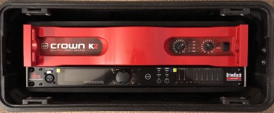

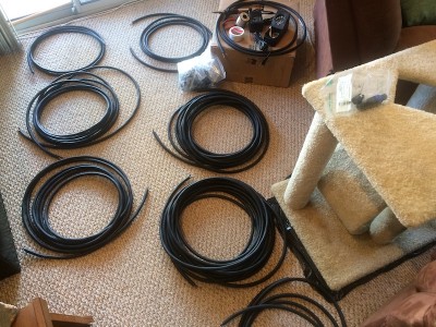

Figured I'd knock out cables and finish the amp racks while waiting for the cabs to return from paint. Yeah, the amps are "old school" but they're long paid for, still sound great, and that Venu 360 is no joke :wink: ...neither is 10-2 SJOOW for that matter. Assembling those 90-degree connectors with that wiring was a PITA. From here on out, I'll stick to 12-4 and just solder the ends together.

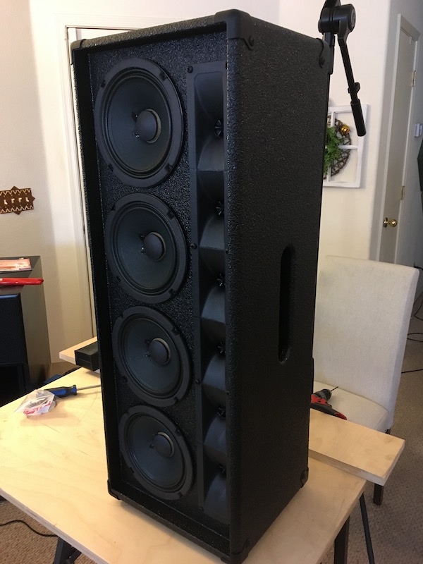

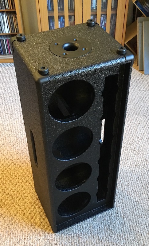

#6 Post by Radian »
Back from paint. Big shout out to Line-X of Tucson! :cowboy: Installing terminals, corners, feet, and pole mount:

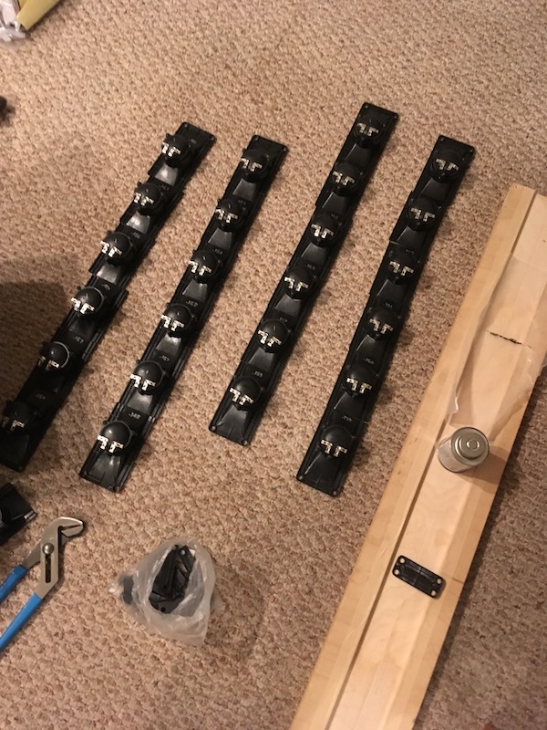

#8 Post by Radian »
IMO, the biggest PITA of this entire project. I wasn't thrilled about having to build my own drivers. It's a huge time suck even for a DIY project, and COTS is my normal go-to, but the allure of the piezo sound got the best of me. Plan ahead. Test fit everything. Fortunately, PE sent me a flawless batch of Goldwoods, and an afternoon in the CNC lab turned out perfectly milled tweeters that made final assembly a breeze. A big shout out to Xerocraft Makerspace for saving the project. These melded arrays are a very tight fit (particularly with the Line-X coating applied) and the finished assemblies rather delicate until installed:

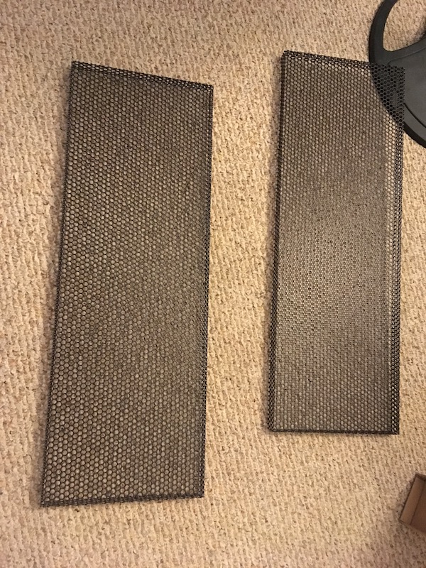

#9 Post by Radian »

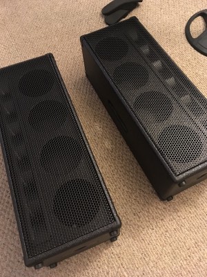

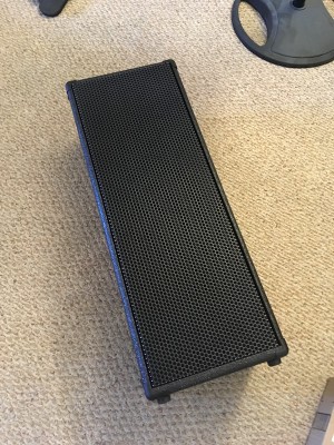

Ordered 6mm perforated grill stock from PE, which paired nicely with their acoustic grill foam. Unfortunately, due to a minor bending error they didn't fit so well on the baffle once the drivers were installed. Clearance between the drivers and the sides of the cabs is tight. 1/4" too short in width and the grills were sitting on top of the drivers rather than along the baffle as intended. Regardless, I liked the finished result and will eventually source fitted replacements. Could just be me, but I swear they sound a little better with the grills installed too:

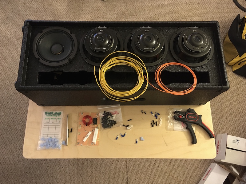

Wiring everything up. Once again, an ounce of planning goes a long way here. Even though I got the polarities right, I botched the routing. :bash: I'll be dipping back into these tomorrow to re-plumb the woofers in a more sensible way before adding the stuffing for final assembly:

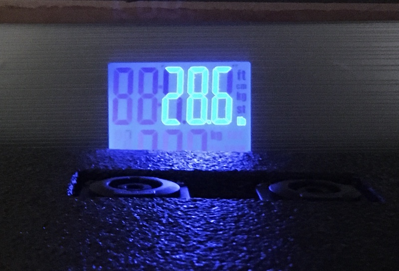

#12 Post by Radian »
Finished weight of the cabs (Baltic Birch) with the Alphalite drivers, minus the steel grills. Figure another pound for those. For comparison, I've got a pair of Klipsch HIP that check in at a toe-crushing 65 lbs...each :shock: These are a dream to place on stands.

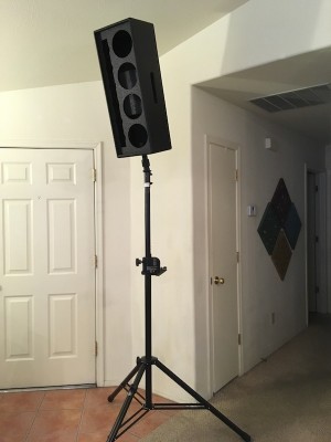

#14 Post by Radian »
Test drive up on the pole. Checking out the pattern through about 90 degrees. If you can figure out a way to fly these things, it's definitely the way to go. 3 meters up and 15 degrees tilted down in this shot. I cannot wait to get these things finished! :hyper:
