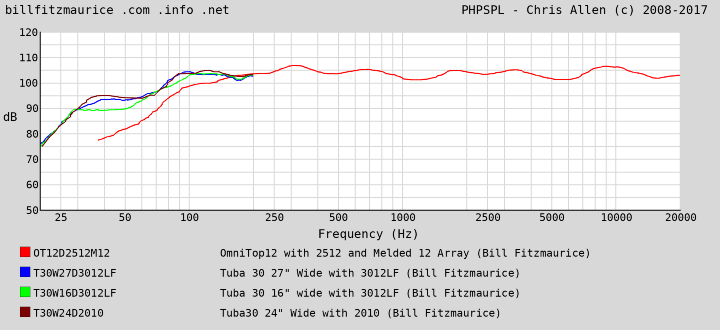

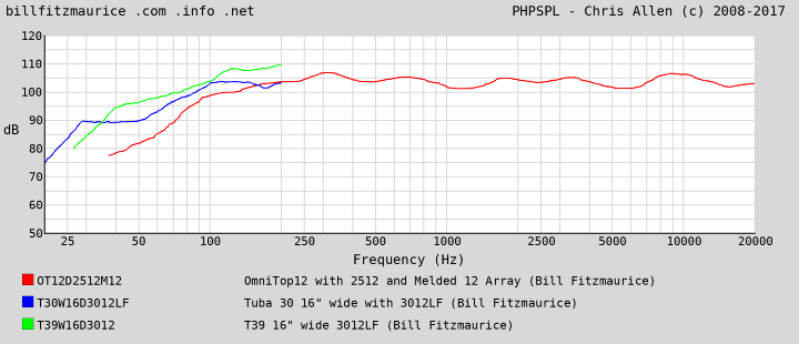

digi128pci wrote:Soon i will start the build of the two T30 subs. But i am wondering if i should go for the 24" or 27" T30?
The drivers i will use are the Delta 12LFA, i had theme laying around so why not use theme.
Do yourself a favor and build T39s. They use the same drivers as the T30 but get louder above 35Hz.
Since you play electronic music, you want the higher sensitivity in the sub.

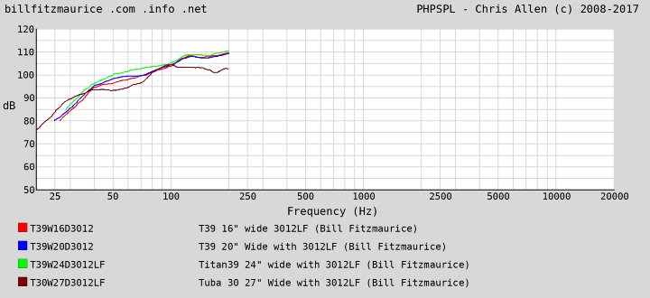

You made me rethink the subbs i planning to build. But i already bought the plans for the T30.
Maybe the T39 is easier to move around and to transport. Can you V couple theme too?
Is the T39 that much better than the T30?
Should i go 16" 20" or 24"?
Posts: 8664
Re: OmniTop 12 and Tuba 30
#41 Post by Bruce Weldy »
digi128pci wrote:Hello,
Probably depends on what you are using them for. If you are good getting down to 40-45hz and don't need to go lower - then by all means, build the T39s. Much easier to move at 19 inches deep and louder. Build 'em with the 3012LF and you'll be blown away. Yes, you can v-plate 'em. Make as wide as you can handle.

#45 Post by digi128pci »
So you mean 3 dB less?
