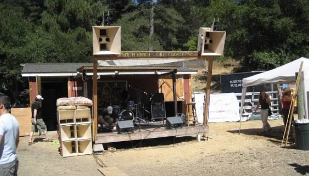

Anton, I believe that is the rig. I remember a photo of that rig beside a home-built stage with dirt at the front of the stage, and trees in the near-background. I think there was an OT12(?) at the roof on either side of the stage.

I had forgotten about those pics. Now that I see them I remember these too. Good find!

Seth...BINGO!
Good job! How did you find them?
Anyone notice the sandbags on top of the AT pile? They were placed there in order to keep that pile from walking.

Tom Smit wrote: Sun Feb 07, 2021 12:16 am Seth...BINGO!
I just did a google image search for "6 autotubas". The pics showed in the results, but wouldn't link with the "copy image URL" function at first. So, I just did a screenshot, crop, and reupload. But, then I inspected the images digital history a little and was able to find an image address that worked and was able to link directly to them.

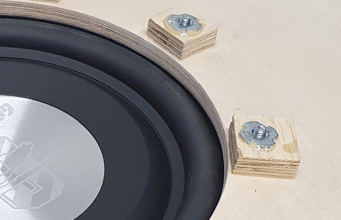

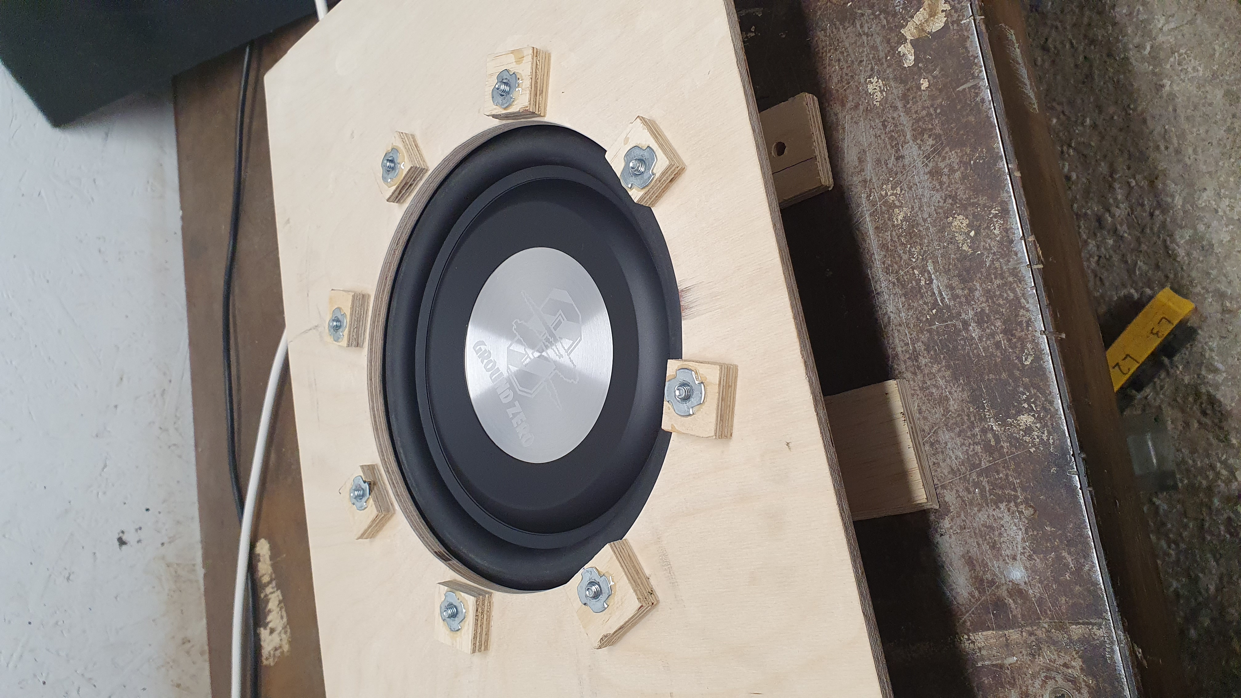

Loctite will be used 8)
And those nuts have PL before i punched them into place.
It takes a long time to cure and expand at 8°C

Line92 wrote: Mon Feb 15, 2021 10:17 am Loctite will be used 8)
That's looking good Linus :thumbsup:
Keep in mind that if you ever need to replace the driver, the use of loctite could cause the inserts to spin/strip in the wood... which would be a HUGE headache. If it were me, I'd use screws and screw retention blocks (as per the plans) instead of nut inserts an bolts. And if I did use inserts and bolts, I'd use lock washers and forego any loctite... even the purple loctite 222.
Also, PL cures with moisture/humidity. If it's taking longer than you want to cure, you can dab the area with a moistened paper towel to speed things up a bit.

Thanks for the tip Seth! Could save me that headache.
I will go with the lock washer, and maybe check bolts after a few hours of use to be sure it is secured and tight.
Yeah i use a glass of water and brush the areas that will be joined together, otherwise it wont cure at all now, very dry inside my garage to!👍

If you haven't already, you may consider breaking the driver in while it's mounted to that baffle so that you can verify that the surround isn't going to come into contact with the baffle at higher excursions. If it does make contact with the baffle, you'll likely be able to round over or bevel the edge from the driver side to make clearance.

Seth wrote: Mon Feb 15, 2021 2:42 pm 20210213_163556.jpg
I have, and it doesnt hit anything, after i sanded it down slightly hehe :cowboy:
I ran a 25hz test tone with up to about 12V max, it seem to hit its claimed Xmax of 13mm with around 9-10V in free air, no noise or sound what so ever from it! :hyper:
With 12V 25hz it seems to exceed it, crazy excursion, i would estimate the cone travel to be around 35mm p-p at those levels. Still only minor blowing noise from the coil vent 👍
