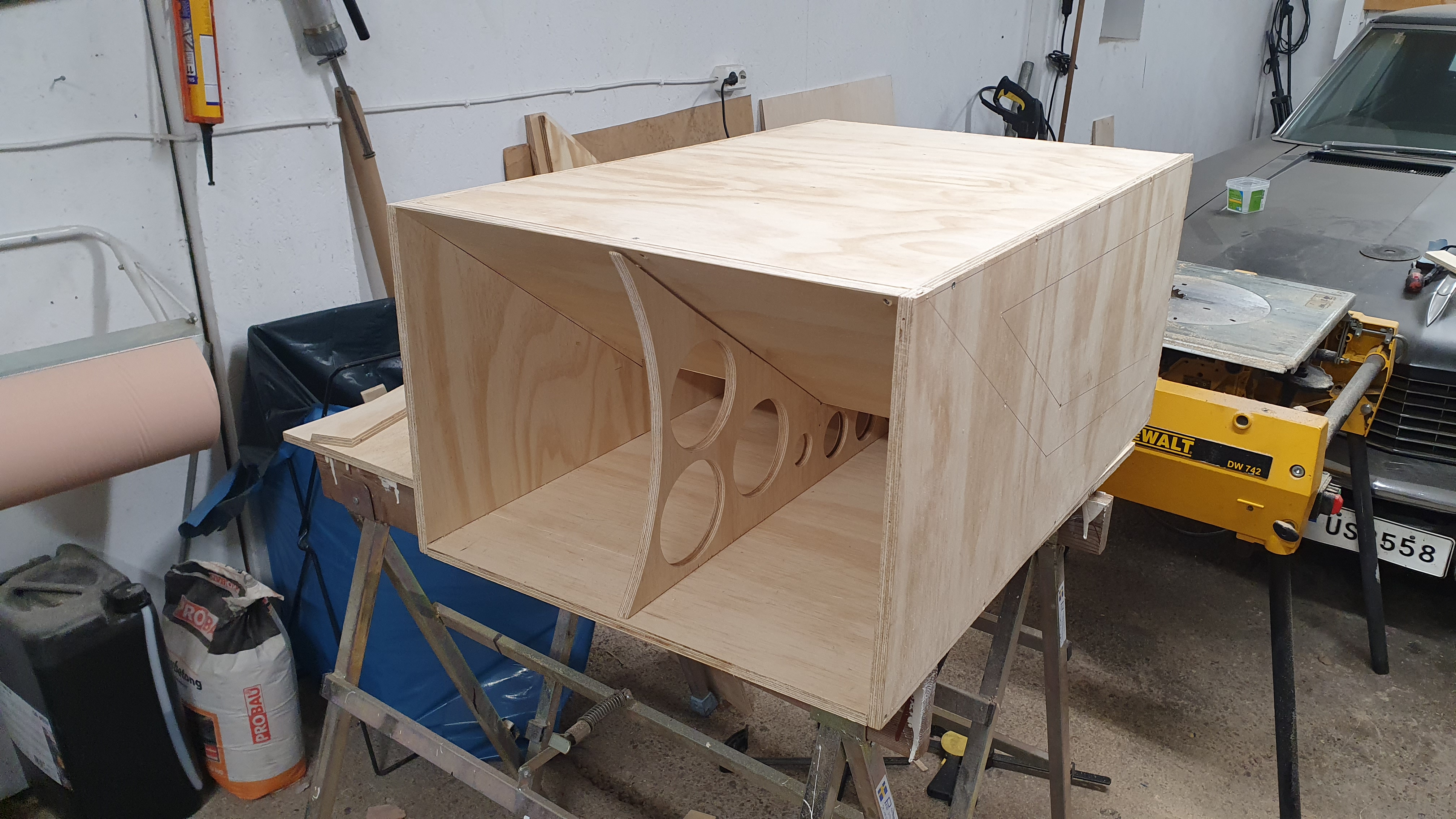

Hi, Linus here again!
I am currently building my first Autotuba and need some help.
I made it with 20" wide panels because it will fit my car (and living room) best that way.
Now i have ordered the Dayton LS10-44 but it will be a month more or so to delivery to Sweden.
I have searched alot to find a better driver within specs and height, it is really hard to find!
But yesterday i found the Ground Zero GZTW 10F that has parameters within specs and alot more xmax at 13mm.

Thanks for the advice, i could easily do some extra braces, could i also do some horizontal braces in the horn mouth like the T60?Bill Fitzmaurice wrote: ↑Thu Feb 04, 2021 10:19 pmIf you plan on running this at very high levels you should double the number of braces.
I was not really happy with the look on the big brace you can see, i f****d up the holes a bit, but like that curve to it so i will probably make dual braces like this but not with as many holes..

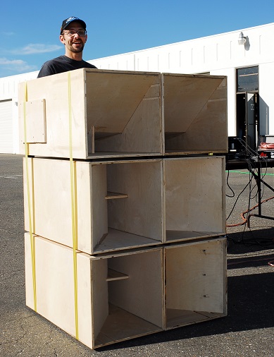

Re: AT 10" driver choice
Tom, Linus:
It seems this was back in 2007, in Novato CA. One of the attendants was none less than respected forum member Harley Dear. He was on holiday in the US from NZ and met quite a good number of builders in person. I do not remember who the other forum members were, nor do I remember the name of the guy who built the stack of Autotuba's.
