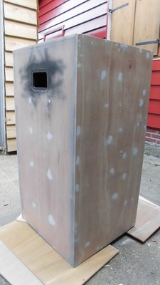

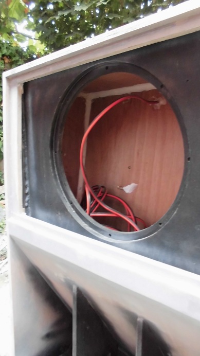

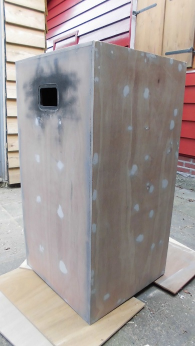

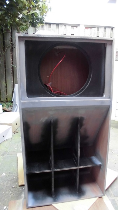

Pictures from the current situation. Tomorrow my tub of Warnex will arive, i hope i have time to paint it tomorrow night.
Patrick Mos wrote:Nice Build Bas! the first time you fire up a Titan is something magical...and after a few minutes it turns diabolical... :twisted:
I have been fighting the urge to put the driver in and take it for a test drive. But i'll wait becouse i know it will stay unpainted for a long time as it will be near impossible to take it apart again.
Plenty of holes to fill.
Front, all primered and ready
Caulk all around the inside of the back chamber, no leaks here.

Bas,
How wide is your cab?
Not trying to be horrible but the access panel opening looks like it is way to large. And you have no panel 7's...
Bas Gooiker
Posts: 752
Re: dutch Titan 39
#28 Post by Bas Gooiker »
The cab is 52cm wide. 49,5 inner panel size.
I am aware of that Grant, but i made a single large acces panel with bracing on the back side. I have the 2 other panels cut as per the plans but i did'nt like the look as much as with 1 full panel. If it turns out to be leaking and/or vibrating i will just do it as in the plans. If i fail i will report this and surrender myself to your "I told you so" 's! :cop:
I'll make a picture of my not following the plans sin later, as currently the front is wet with paint so flipping it over for a photo is not possible.
