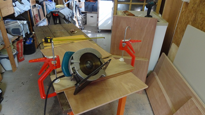

Cut 4 sides, 4 tops, 4 bottoms, 2x baffle 2, 2x driver anchors.
Made a jig for the router to cut out the driver holes, after the first hole i made a new jig becouse the result was less than satisfying. Bad jig... nothing to do with me using the router for the first time in my life! :noob: Ah wel, thats why you buy an extra sheet of plywood.

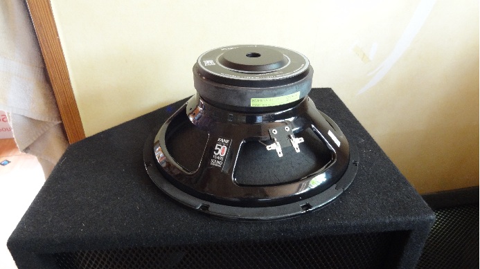

The width was chosen becouse the non recommended driver i used (Fane Sovereign 12-500LF) Becouse its inferior compared to the 3012LF i decided to keep the panels the width of a BP loaded cab, although the Fanes have slightly higher xmax & vd.

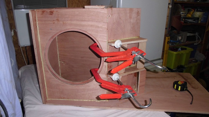

Made interior braces for inbetween panel 4 & 6, 3 & 5 and 5 & 8. Made some simple jigs & tools to make and install bracing to help me with the second cab and any other future ones. Its amazing how rigid the construction gets when a few panels are glued together.
first few panels in place

Say, Bas, those blocks are just temporary spacers, correct?
Bas Gooiker
Posts: 752
Re: dutch Titan 39
#7 Post by Bas Gooiker »
Tom Smit wrote:Say, Bas, those blocks are just temporary spacers, correct?
Yes, i use em as reference for spacing.
