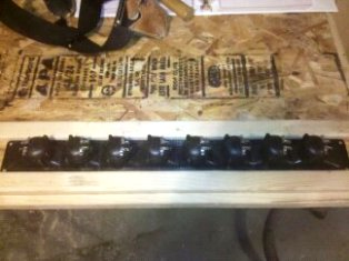

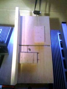

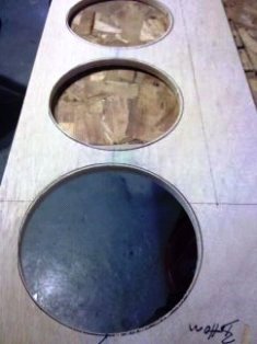

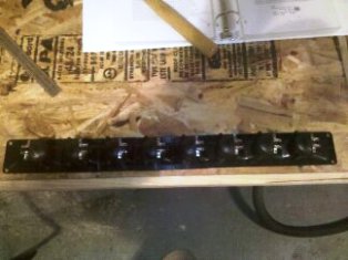

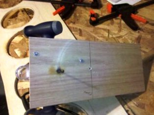

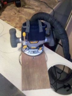

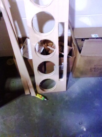

Got some stuff done today. Finished routing the holes and starting working on the piezos. Hit me up with any feedback folks, thanks!

- quick sled/jig for cutting piezo melding
- 1331681325574.jpg (14.49 KiB) Viewed 2513 times

- A lot smoother circles when you use circle jig
- 1331675946839.jpg (14.78 KiB) Viewed 2513 times

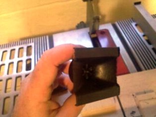

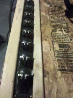

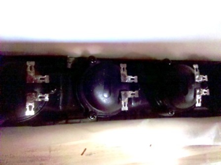

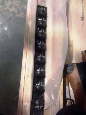

Heres one of the piezo lineups. Got some abs glue today from ace, man they done give that stuff away! Anyway I would have started gluing tonight except I didnt have any wax paper

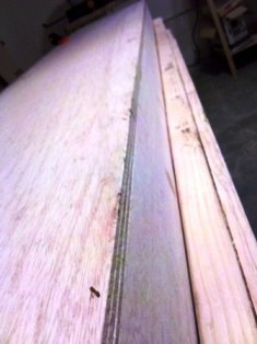

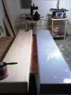

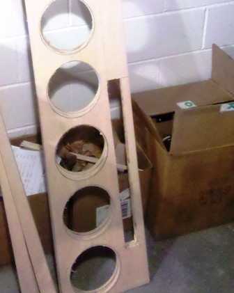

Ok, got the slots for the piezo arrays all cut and one of the piezo sets melded...Im one piezo short however b/c i cut my first piezo too short...needless to say i have 10 coming for backup..i cant believe i didnt order extras additionally!
Gonna sand and prime today!

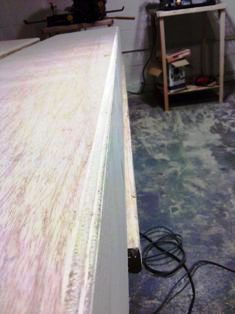

Re: TLAH PRO Build
Thanks for the info Chris, much appreciated!

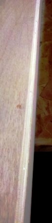

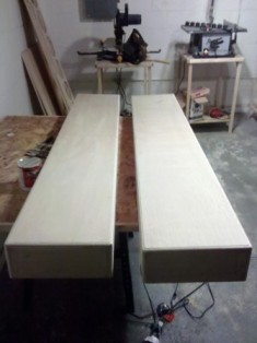

Heres some of todays progress..forgot to snap a shot of the piezos but they look great!! I cant believe how well they turned out actually.
I tried to get some good shots of my roundover'in job but I guess I'm meant for drumming, not snapping pictures!
