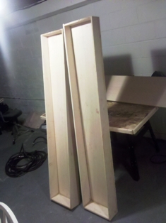

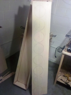

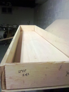

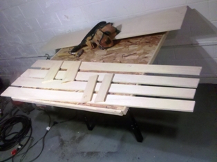

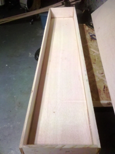

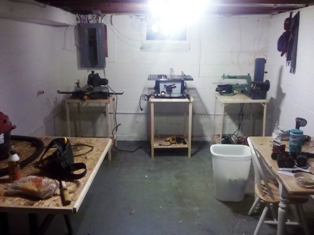

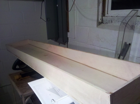

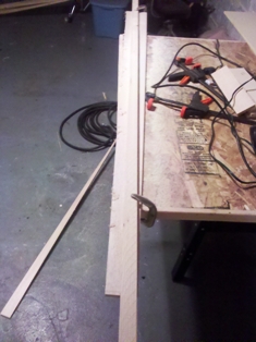

Ok, so this is my first build thread so bear with me folks! It might run a little slow b/c I work on these when I can and sometime time is limited (70+hr work weeks here).
Im build these for medium volume live music settings. I have other systems that I use regularly so I went low end with the 8" mids here just to see how much bang I could get for my buck. Ill have roughly 225-250 total investment when Im done, so if they arent up to par, ill swap them out for the recommended eminence drivers. These will be 72" tall, basically following plans.
Im using the recommended 1016 tweets which well be melded with the crossover/filter build as described in the plans. For mids ill be using the peerless 8" specials at parts express (http://www.parts-express.com/pe/showdet ... er=299-068). Ill be running these at roughly 250 watts...maybe 350 tops per channel. While im not sure what the recommended volts on these would be (sorry newbie, still learning), in figuring these should run roughly 425-450rms per channel, so I should be able to get what I need from them without over-stressing them. Lets hope, Im sure a $5 speaker wont take too much stress!!
Anyway, here some pics (we all like those), feel free to feedback guys, I look fwd to all of your expertise advice!

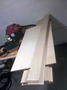

more pics..sorry about the random order, and all the typos. Man I gotta start proofreading!

Hey I saw those buyout drivers at PE too. I'll be anxious to see how they perform for you. The price is certainly attractive though. So your woodwork looks great too. Is it hardwood, or are you using plywood?
I'm just starting to cut wood for a TLAH Pro too for a sanctuary install. But I'm a slow woodworker. I'll try to post progress too as I follow you along the build.

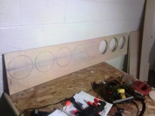

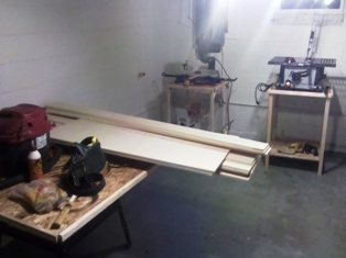

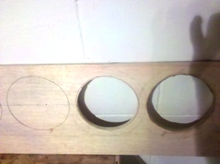

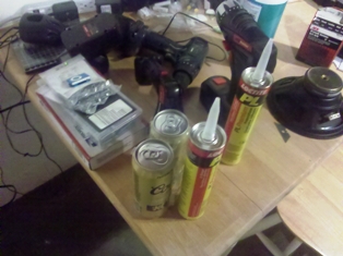

Ok, moving right along here. I got the holes traced out along with a general idea of where the tweet array is gonna go. Im cutting the holes out with a jig saw, which I am not happy about (too sloppy). I need to get some 1/4 or 1/8" stuff so that I can make circle jigs for my router. I have one hole that is a little big, so Im attempting to layer some PL inside the hole so I can get a better fit. Were talking 1/8" too big in a couple spots, nothing too major. Otherwise I think everything's going as planned, it should as this is a fairly simple build which is perfect for my first BFM project. Should have all the holes cutout tomorrow. From there I think Ill make a jig for my piezo melding, paint the baffles and build my crossovers. Ill post plenty of up close detailed pics so that I can verify they are being done right! Plus if they are right other folks may be able to use them as a guide
- Attachments
- Running low on two key components
- box14.JPG (64.79 KiB) Viewed 4448 times
- tomorrows cutting
- box13.JPG (47.46 KiB) Viewed 4448 times
- box12.JPG (55.5 KiB) Viewed 4448 times
- the middle hole is a little big, a little PL should solve that
- box11.JPG (50.5 KiB) Viewed 4448 times
- my assistant
- box10.JPG (55.86 KiB) Viewed 4448 times

Need a router and a circle jig for clean driver circles.chenry78 wrote:Ok, moving right along here. I got the holes traced out along with a general idea of where the tweet array is gonna go. Im cutting the holes out with a jig saw, which I am not happy about (too sloppy). I need to get some 1/4 or 1/8" stuff so that I can make circle jigs for my router. I have one hole that is a little big, so Im attempting to layer some PL inside the hole so I can get a better fit. Were talking 1/8" too big in a couple spots, nothing too major. Otherwise I think everything's going as planned, it should as this is a fairly simple build which is perfect for my first BFM project. Should have all the holes cutout tomorrow. From there I think Ill make a jig for my piezo melding, paint the baffles and build my crossovers. Ill post plenty of up close detailed pics so that I can verify they are being done right! Plus if they are right other folks may be able to use them as a guide
Re: TLAH PRO Build
I agree router would be great. On a limited budget one could also make a similar model circle cutting jig for the jig saw.

Re: TLAH PRO Build
Yup, my poor router was just chilling in the corner
, In the past I have made jigs to cut circles but I use 1/8 or sometime 1/4 to make the circle jigs and I didnt have any at the time. Oh well no one will see my holes after the speakers are in!
