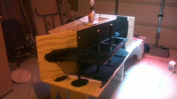

Cleaning and starting panel 5 and braces.
Just dry fitting the panels to finds its place, now things are looking up. :D
Since the braces are no longer being used as straightening braces so the joining jigs are now being used. All lines and angles look “prettyful”

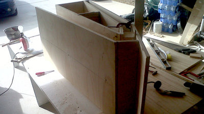

Panel 5 screwed into the braces to created a “study on perspective” ha ha ha

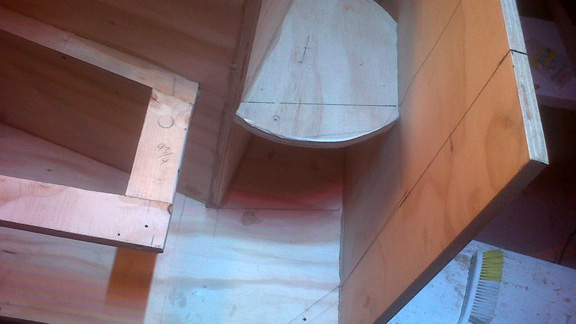

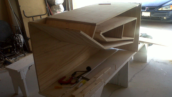

Details of horn path outline and attached panels.

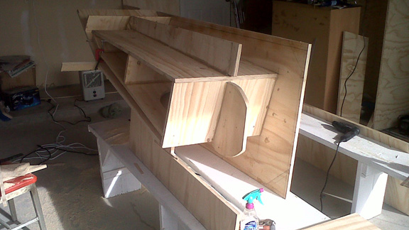

zefrenm wrote:File comment: The PL wasn’t setting from the night before so a space heater and a lamp provided a heat source until outside warmed up.
Bill Fitzmaurice wrote:Spritz it with water. PL needs heat and humidity to cure properly, and in winter the air is very dry.
zefrenm
Posts: 164
Re: Zefren's Reservation Tuba
#18 Post by zefrenm »
Cool New Mexico winters the relative humidity hovers at 28%

It will help it expand and push into the pores on the wood. I try to always spray my joints, regardless of RH

subharmonic wrote:It will help it expand and push into the pores on the wood. I try to always spray my joints, regardless of RH
I wipe it with a wetted paper towel.

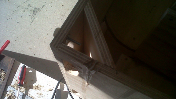

My cousin was off today to we started early, but not on the current tuba. We hoped by the end of the day to finish the tuba all the way the last panel. Wishful thinking but set high standards get more done right lol.

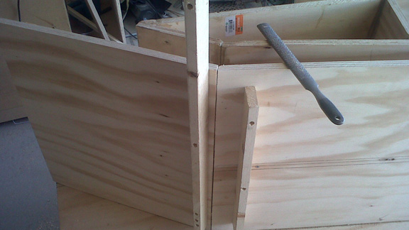

We opened the 1st tuba and set about fixing the “damn” tee nuts the striped during the build. We gently sawed using a hacksaw wrapped with yarn until we sawed all offending screws. We hooked it up and “subjectively” the Lab doubled the Tubas power lol compared to the Peavey Lo rider tuba. We promptly went to buy more Labs for the rest of the completed tubas.

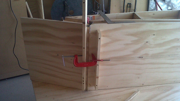

The “Dead reckoning” that’s talked about with fitting some panel’s lol the straightening jigs helps. Some plywood seems to want to warp the smaller its cut.

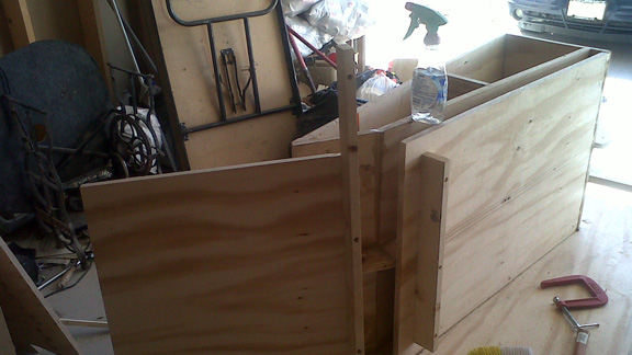

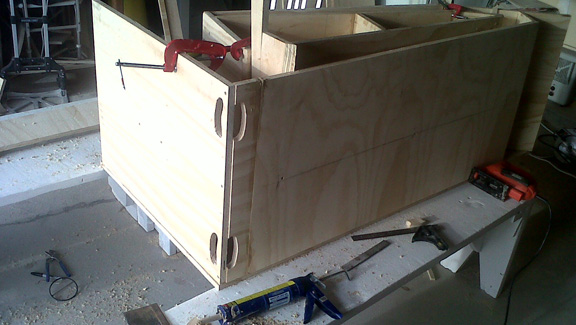

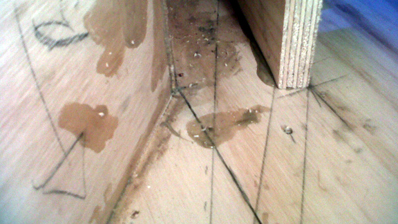

Here we sprayed the panel joints with some water to help cure the PL.

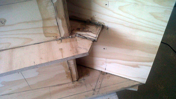

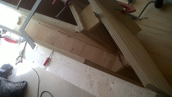

Here we’re Linking c-clamps to hone panel 6 and 5, all while using cut slims to space the horn path.
More Linking the clamps again to bring panels together.

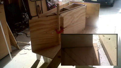

Transferring, marks for panels 7 and 9 and screws.

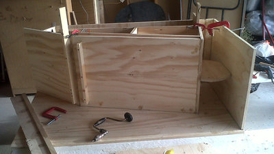

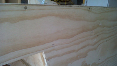

One 4’x8’ can provide 3 panels 8 it’s the only panel that not matches for the grain due to economy. The panel will still be short about 4 inches but there’s a way to deal with that.
Panel 8 is a pet peeve of mind so I transfer horn path measurements to the brace so I shim the panel straight on the open end.

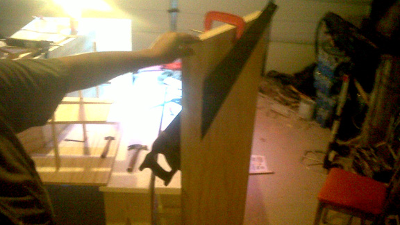

Checking the horn path measurements on the open end of panel 8 in a dry test fit.
I dry fit panel 8 shimmed squared and cut and panel 9 to fit.

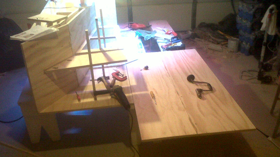

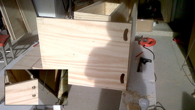

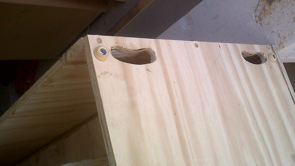

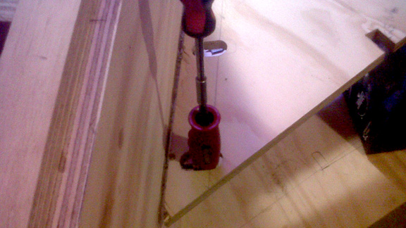

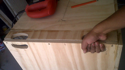

I found a 1960 1-inch blade drill and remembering the dent in my friend truck I decided to place hand holds in panel 10 for lifting. I prefer hands hold that mold to the hand so I got myself smiling hand holds on this tuba.
This is the extension cut to fit to complete panel 9. The hand hold needs to accommodate a large palm since many of the movers in our area have “heft” ….    in their hands.
The hand cut out turned out to be too small so it will be cut larger tomorrow.

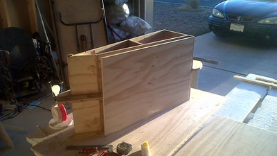

Gluing the panel extension and panel 10 and squaring the panels with more linked c-clamps. And that’s a day.

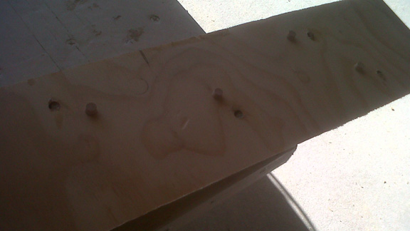

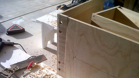

12pm – used the time to flip the tuba up and plug the countersunk screws. I found a masonry bit that would open the holes just enough to make the 3/8th plugs fit perfectly without glue.

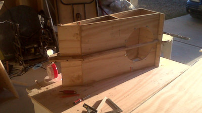

We needed to make the hand opening bigger so I grabbed and marked until the opening was big enough for the heftiest hand.
The comparison of using wooden dowels to 3/8th inch plugs.

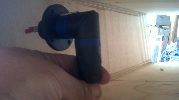

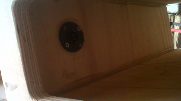

Bill Fits talks of using the sealed chamber for cable storage and having used the previous tubas this would be an added bonus.

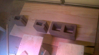

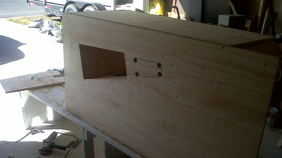

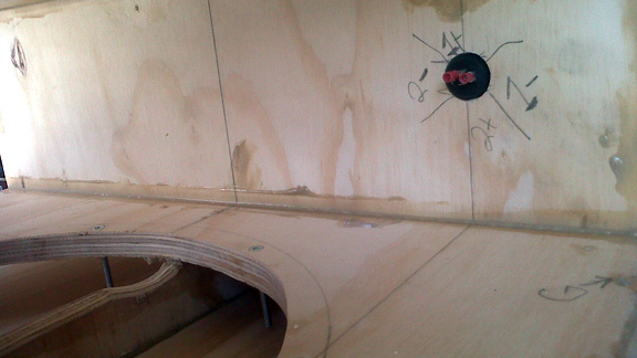

After I roughed out the hole I saw panel ( #5) and said hey “if I place the Speakon connector in panel 5 then we would eliminate the limited positions we could place the tuba is we used the access panel as the Speakon outlet.
zefrenm
Posts: 164
Day 5 Continued
#27 Post by zefrenm »
Day 5 Continued
Hole drilled and labeled the position and polarity of the four prong connection.
Connector installed.

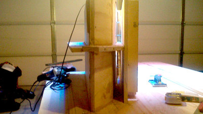

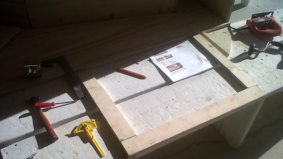

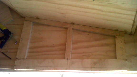

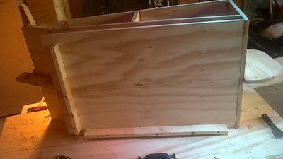

Starting to build brace 6/12.  Man I hate these braces and will often procrastinate in making them, I dunno why I just do.
Grandpas handsaw has been more useful for short straight cuts. Don’t underestimate the power of old hand tools and carpentry methods.

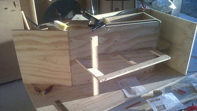

Like brace 2/8 to transfer the horn path lengths to the brace 6/12 and use this to the lower brace true to panel 12.
Brace 2/8 installed with those little wings.

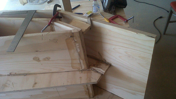

Brace 7/12 installed much like brace 6/12 I use the horn path to crate the final bottom cut. I find its easier installing using screws in brace 7/12 than to screwing in from panel 7 to the brace.

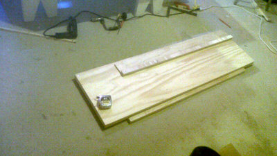

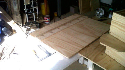

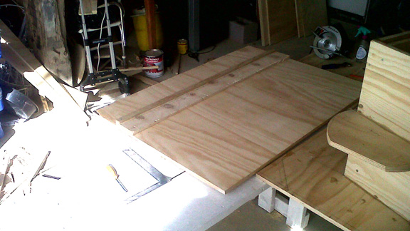

I got no truly level surface except the floor of the garage. Right here im preparing to cut to two boards at 45 degrees to make panel 12. Tightly clamp any sort of warping will bind the saw.

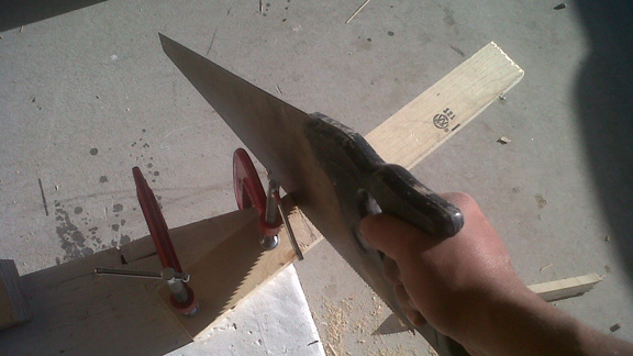

My circular saw did not cut deep enough so im finishing the panel with a hand saw. Saw with the pulling stoke towards the center, its takes longer but will keep the saw from ripping the edge out.
The Finished cut. Sand down the edges just for accuracy
The panels joined together on the angle.

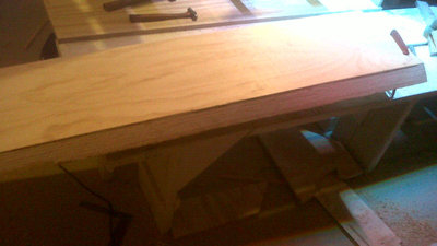

I used all my straitening jigs for the braces so using what I had on hand to straighten the bow out the the glued broad.

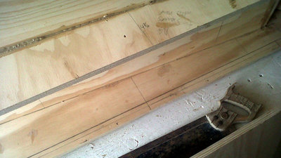

Marking the minimum area that the wood finish needs to conceal the insides.

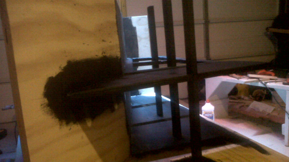

Staining the inner horn path now makes a nicer presentation since we don’t use a grill on the tubas. Take care no to paint too much into the joints. Paint and stain can change how PL bonds so its just a precaution.
The  final staining will finish after all the hardware is installed so the viable areas all stain uniformly.
