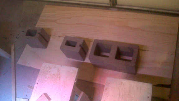

zefrenm wrote:File comment: The PL wasn’t setting from the night before so a space heater and a lamp provided a heat source until outside warmed up.
Bill Fitzmaurice wrote:Spritz it with water. PL needs heat and humidity to cure properly, and in winter the air is very dry.
zefrenm
Posts: 164
Re: Zefren's Reservation Tuba
#18 Post by zefrenm »
Cool New Mexico winters the relative humidity hovers at 28%
