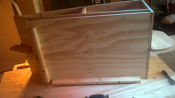

zefrenm wrote:File comment: The PL wasn’t setting from the night before so a space heater and a lamp provided a heat source until outside warmed up.
Bill Fitzmaurice wrote:Spritz it with water. PL needs heat and humidity to cure properly, and in winter the air is very dry.
Re: Zefren's Reservation Tuba
Cool New Mexico winters the relative humidity hovers at 28%bassmonster wrote:zefrenm wrote:File comment: The PL wasn’t setting from the night before so a space heater and a lamp provided a heat source until outside warmed up.Bill Fitzmaurice wrote:Spritz it with water. PL needs heat and humidity to cure properly, and in winter the air is very dry.
“With much respect and honor Dear sir … The size of the Tuba 60 is of non consequence, I rather do love bass and bass rather loves size, so save the “its too big comments” … thank you

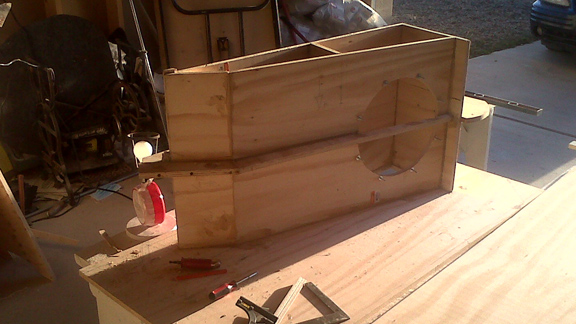

My cousin was off today to we started early, but not on the current tuba. We hoped by the end of the day to finish the tuba all the way the last panel. Wishful thinking but set high standards get more done right lol.
