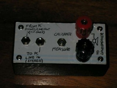

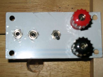

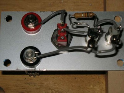

The first incarnation of my impedance testing jig was ugly. Just some loose wires, connectors, a resistor, all hanging from the back of a pc's audio jacks. Something dropped off my desk and tore the whole thing apart. By now I am convinced by the usefulness of these measurements. So I made a better version that will hopefully last me a long time.
Front drilled, connectors and switch installed.
All wired up. This is all there is to it, even I can do this :noob:
Here is the finished jig.
I intend to take plots of all my cabs over time. If somethings goes wrong with any of them, I can use the existing plots as a reference of a good cab.

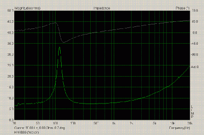

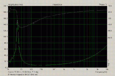

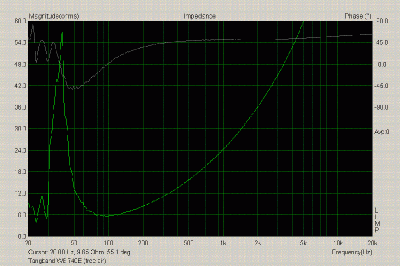

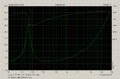

With the new jig ready, I decided to take plots of a few drivers. No cabs, just drivers free air. Here are some popular drivers:
TangBand W8 740E (fs = 32Hz)
Tangband W8 740E (free air)
HiVi B3S (fs = 80Hz)
(this is a nice and good looking 3" driver that can be used for small versions of SLA and SLA-curved (see pics on Leland's website http://www.speakerhardware.com ) )
HiVi B3S (free air)
HiVi B3S (free air)
Eminence Alpha 8A (fs = 73Hz)
Eminence Alpha 8A (free air)
Eminence DeltaLite II 2510 (fs = 53Hz)
Eminence DeltaLite II 2510 (free air)
Eminence KappaLite 3012LF (fs = 37Hz)
Eminence KappaLite 3012LF (free air)
Posts: 2704
Re: Impedance testing
#29 Post by AntonZ »
From most of these drivers, impedance plots can be found online. My measurements pretty much match the online plots. Good :cowboy:
Note from the plots above that the peak in the impedance plots happens more or less at fs (resonance frequency) from the driver specs. The little HiVi driver is a bit off, but my guess from the above is that the impedance peak should match fs. Can anyone confirm this?

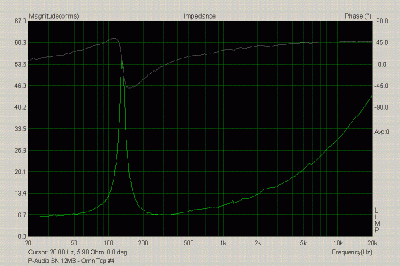

Now it gets interesting. I did not get around to swap drivers on the problematic OmniTop 12 cab just yet. But a few weeks ago I opened the cab. I had the driver out to inspect the gasket, the mounting surface and renew screws. While the driver was out, I took a free air impedance plot, hoping I would be able to compare to plots online. Alas, no impedance plot to be found online of the P-Audio SN12MB driver. Here is my free air plot:
P-Audio SN12MB (free air)
Then I accidentally destroyed the first impedance jig. Fast forward to this weekend and the new jig. Note the location of the impedance peak, at roughly 130Hz. The P-Audio specs state fs at 62Hz. I think the issue with my #4 OmniTop12 cab is not tied to a leak in the cab or gasket, but rather this particular driver is not OK.
